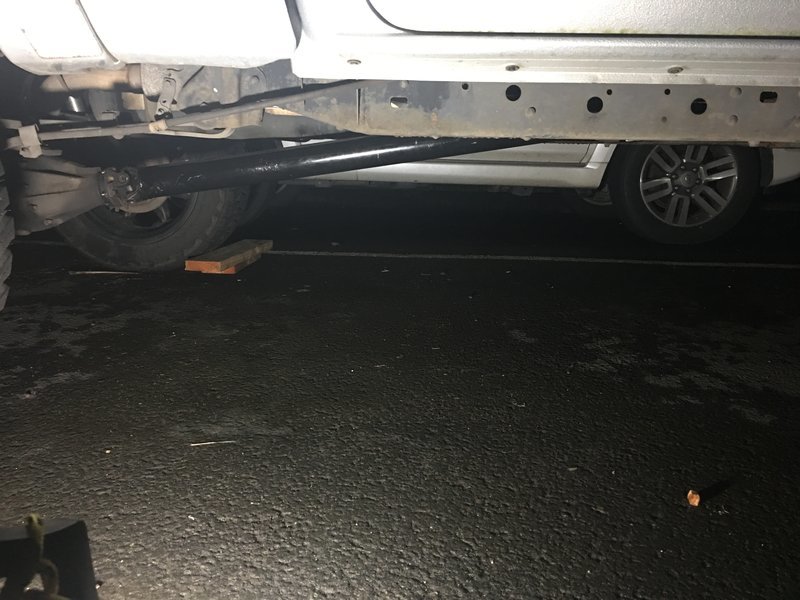

    Custom one piece rear driveshaft for 05 4x4 Tacoma double cab long bed. No vibrations!!!
    No shitty center support bearing. Tucks higher than before.

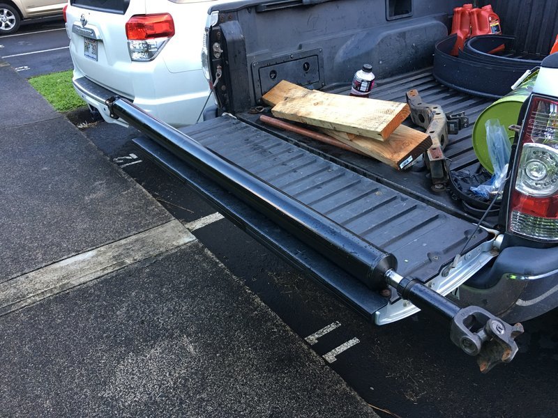

    After a trip to Arizona this past weekend, on the way back I started to get some very noticeable driveshaft vibration at 70+ mph. Ended up driving home at about 65mph to avoid subjecting the transfer case and diff to any possible damage or premature wear.
    Just got off the phone with Troy over at Tom Woods and they're setting me up with a UPS shipping label so they can get it back and see what's going on. All at no charge which is great. They seemed genuinely concerned and want to get it on the machine and see what happened. Great customer service thus far. Shit happens and not everything can be perfect every time so nothing bad to say.
    It's been smooth up to about 80 mph before this happened and not sure what happened. Hopefully it's something simple and once it's back all will be resolved and no more issues in the future.
    If the problem returns, I'm not sure what route I'm going to take as driveline problems have been a plaque.
    • Had stock driveshaft rebuild and balanced. Bad vibes.
    • Had custom 2 piece driveshaft made with a double cardon joint. Sheered the stub at the flange on a offroad trip.
    • That driveshaft was warrantied by the builder but I lost all trust in it due to using the same parts. Builder and other shops say bigger components not available without significant modifications.
    • Went 1 piece to eliminate the weak 2 piece assembly. By far the smoothest and most noticeable difference. But it's now out of balance/something worn.
    Ugh.

    I'm very VERY interested to hear more about your custom 2 piece shaft with the double cardan joint. Can you give us more info on that? Prior to its failure, was it a good solution? Where was the double cardan joint added? How did your failure occur and do you have a picture of the failure? I'm looking at adding one right behind the carrier bearing. If the pinion angle is what's causing the start-off vibrations, a double cardan SHOULD tolerate the angle changes much more gracefully. Having the carrier bearing will support the middle and allow the shaft to work at higher speeds. At least that's my hypothesis. Still looking for advice.

    It was smooth and was a great solution, but it did have a "clunk" or delay (hard to describe) when taking off. Basically the extra weight of the double cardon joint on the support bearing caused extra movement.
    Failure occurred at the midship stub. To convert it over, they have to use a smaller diameter and therefore it's substantially weaker.
    Snapped off midship stub inside the stock factory yoke for size comparison.
    Broke on the side of a moderate difficulty trail. Nothing that should warrant a failure.
    I have the replacement if anyone is interested in buying it haha.

    Wow, very interesting @1MK and I appreciate you posting such detailed info. Seems like that should still be a VERY strong piece there and I'm almost wondering if that was a flaw in the initial build of that stub.

    When upgrading, you'd think the components should be at least equal size if not bigger then stock. That's why you upgrade most of the time, to make it stronger/better. Going smaller/weaker then stock doesn't make sense. If I'd have known that was how it was going to be built I would have passed on going that route.
