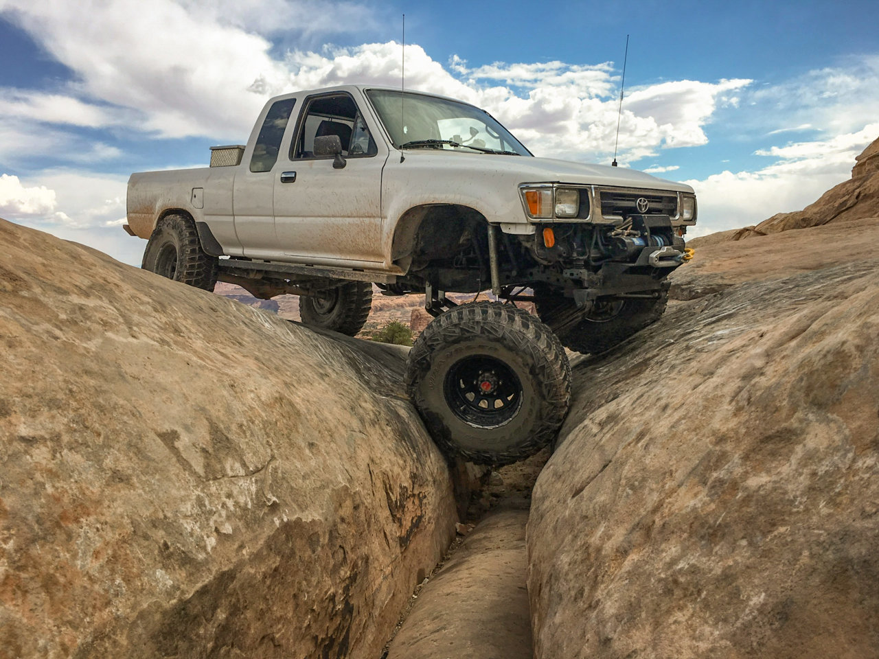

    I'm still confused, but if we are talking about Solid Front Axle vs IFS then I agree, it depends.
    I did a solid axle swap on my old 95 Toyota Pickup and it was an offroad beast, but sucked to drive on road and I was always fighting death wobble. One ride in an IFS vehicle offroad and I sold the truck and bought my tacoma. It's never going to be quite as capable offroad, but I much prefer the comfort and I can do nearly 95% of what I used to do.

    I can't think of many off-road scenarios where IFS would be ideal over a solid axle except Baja racing/high speed stuff. For crawling and most else a solid axle will usually give you better articulation like the image above, not to mention they're much beefier and stronger than an IFS setup.
    Manufacturers switched to IFS because most everyone buys a vehicle primarily for road use and IFS rides more comfortably. Jeep Wranglers and Gladiators still come with solid front setups though for the off-road crowd that wants them from factory.
    But then you're stuck with a Jeep
