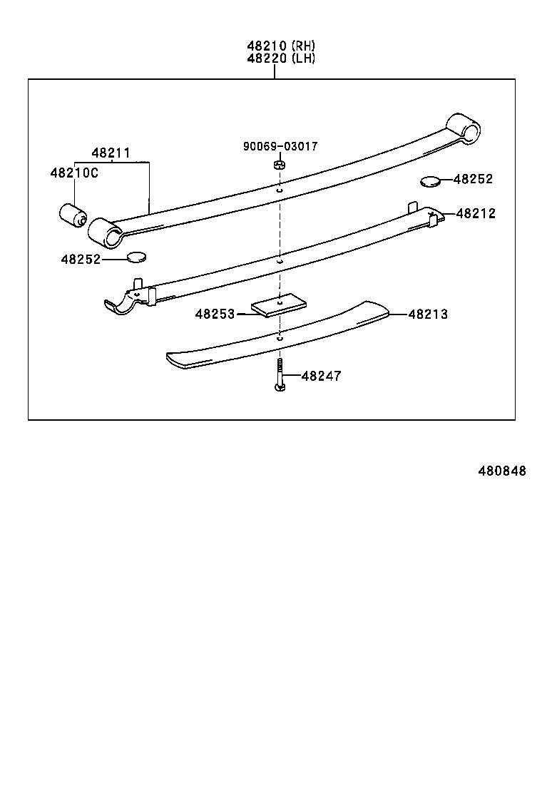

    Sounds like your retainer clips are broken/missing (see pic). That'll just happen again unless you get that taken care of.
    Might not be a bad time to just replace your 20 year old springs and U-bolts.

    You asking if the ones pictured are OEM, or if you should replace with OEM?
    Top ones are OEM, yes. The clamps right near the center of the leafs is aftermarket though. That's a clamp I used to help reduce axle wrap. Not something I'd recommend to replace your missing/broken retainer clamps though. You need to allow the leafs to move relative to each other when the suspension moves. A clamp prevents that.
    But if you're asking if you should replace with OEM, then that's up to you. Genuine OEM is rather expensive. There's a company called General Spring that make good OEM replacement springs, just do a search for there here and you'll see a lot of folks recommend them.
    For almost the same price as OEM from the dealer, you could get the Deaver J59 springs shown in my pic, too.
