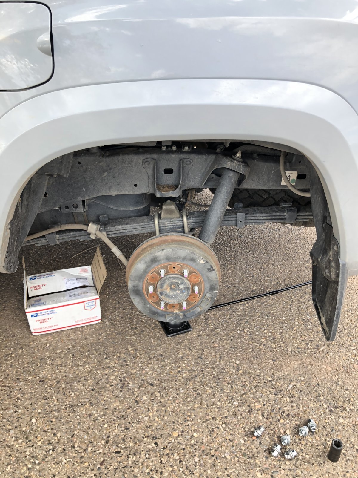

    Been years of offroading frequently, gear in the back all the time, roof top tent, and my dakar mediums havent sagged since the initial “settling down” after the install
    I feel like it’s not even so much about the money because I got my dakar mediums for 500 bucks AAL is to be 150. The price difference isn’t that huge it’s more about the time and hassle of getting springs installed twice.
    also you can do this in reverse OP, get full leaf pack like dakar mediums and AAL if they sag or your needs change, then you’d have dakar HD’s.
    This september (the front has been lifted since the original pic so keep that in mind)
    A week after install in 2021, truck pointed down slope and the front end was sagging and needed a lift too so it looks i had some sweet rake back then lol
    point is, no significant sag since installing the dakar mediums and using the shit outta them
    And just for fun, here’s my stock leaf springs after 6 mo with the shell

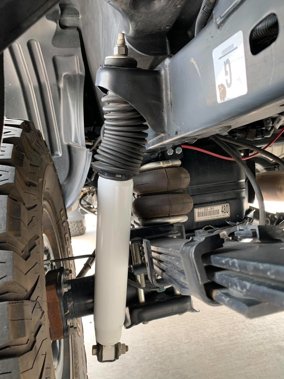

    Like so:
    My understanding is that airbags are to save your leaf springs from unnecessary abuse when you’re towing heavy or hauling a really heavy load, but they’re not intended for daily use to support a shell
