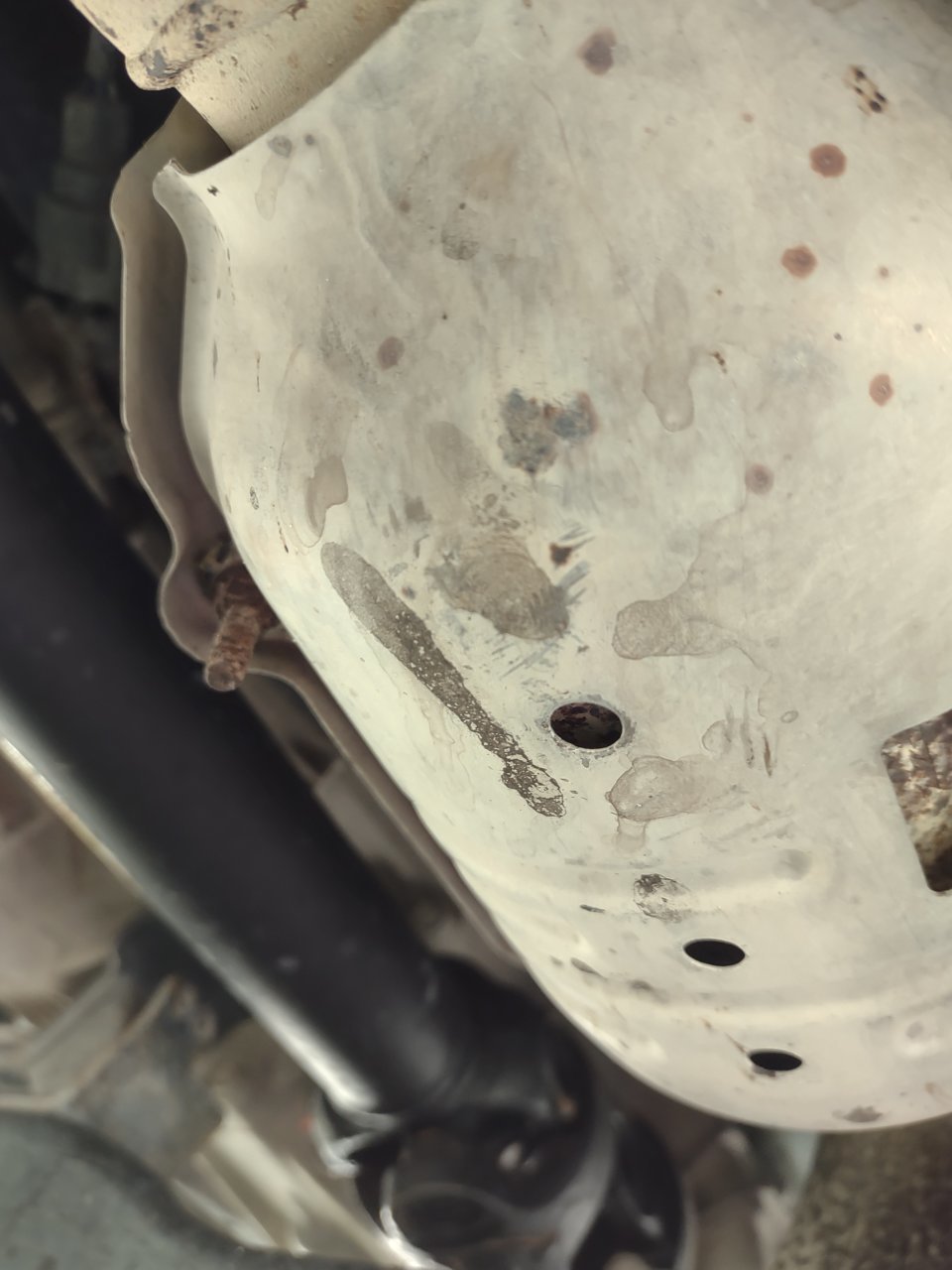

    20200726_190353_HDR.jpg Looking to get a single piece driveshaft. Truck has a solid 2 in suspension lift, O.M.E springs and bilstien all around with aftermarket U.C.A and adjustable sway bar ends. I'm still running my stock driveshaft, but the carrier is going. So, can I order a single piece for stock length and has anyone done this?pfa

    Just depends on the truck- I don’t think anyone makes a 1-pc for double cab/long bed. Otherwise take your pick and many places can build you one, it’s gonna be $500 or so.
    Alternately- just throwing this out because it’s what I did last week- total driveshaft overhaul are a driveline shop, 3 new universals, new center bearing, slip yoke service, balance- $250

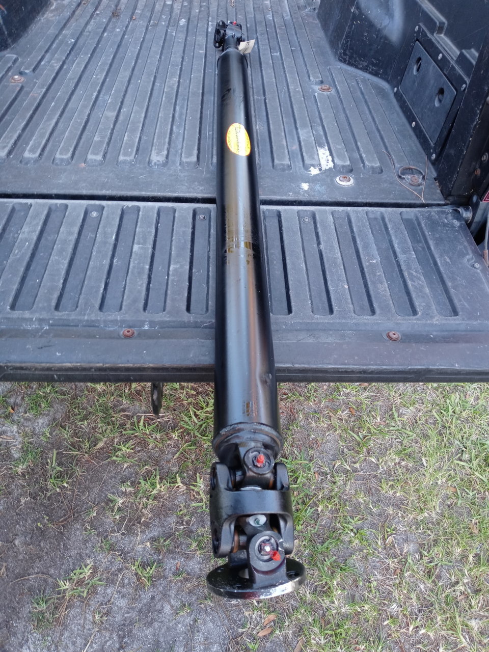

    I saw that they had one made specifically for these trucks just wondering if anybody got one that was pre-made to replace stock drive shaft and ran it on a lifted truck Tom Wood's website want you to measure Driveline angles guess that's what I'll do

    I have a one piece from Tom Woods measure the length and the bolt to bolt on each yolk it outlines it on driveshaft. If you are worried or unsure call them they made me feel completely at ease with my measurements. It’s a double carden so it slides back and forth as the truck flexes. You have to grease that part I got the non greaseable U joints

    There's nothing all that special about a tom woods drive shaft. Just go to your local drive shaft shop and measure flange to flange. Easy peasy. Only reason to go to Tom woods is you live nearby or there are no good local shops and you have to shop anyway.

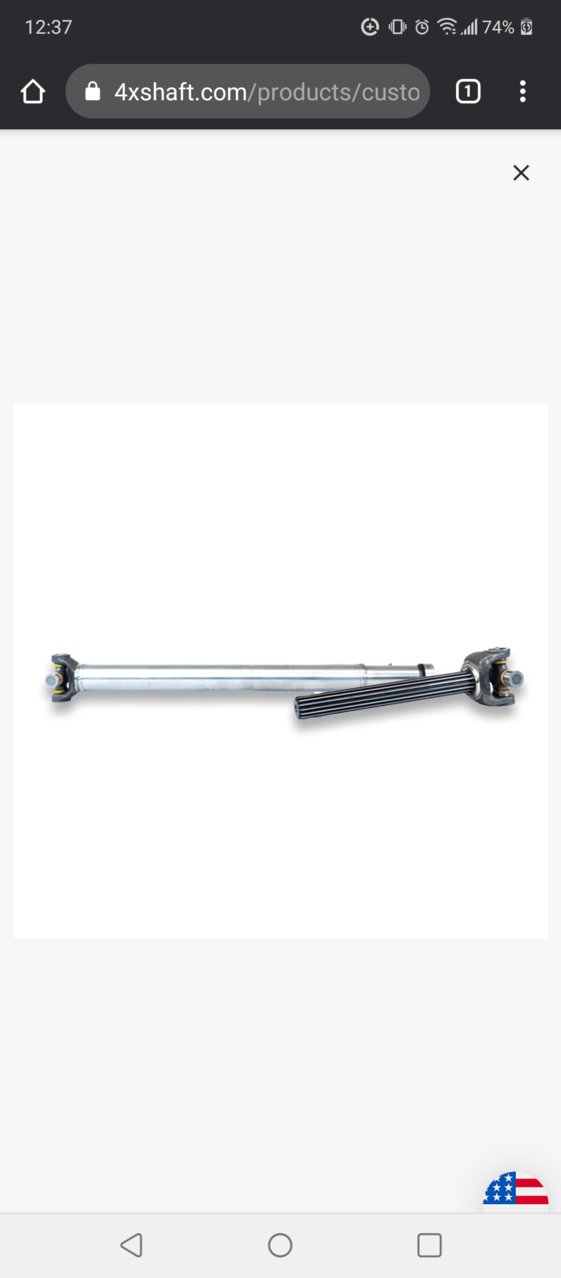

    Think I'm going to get this. 1310 u joints. Full cut spline. Shouldn't be terrible expensive as it's only 28 5/8" length.

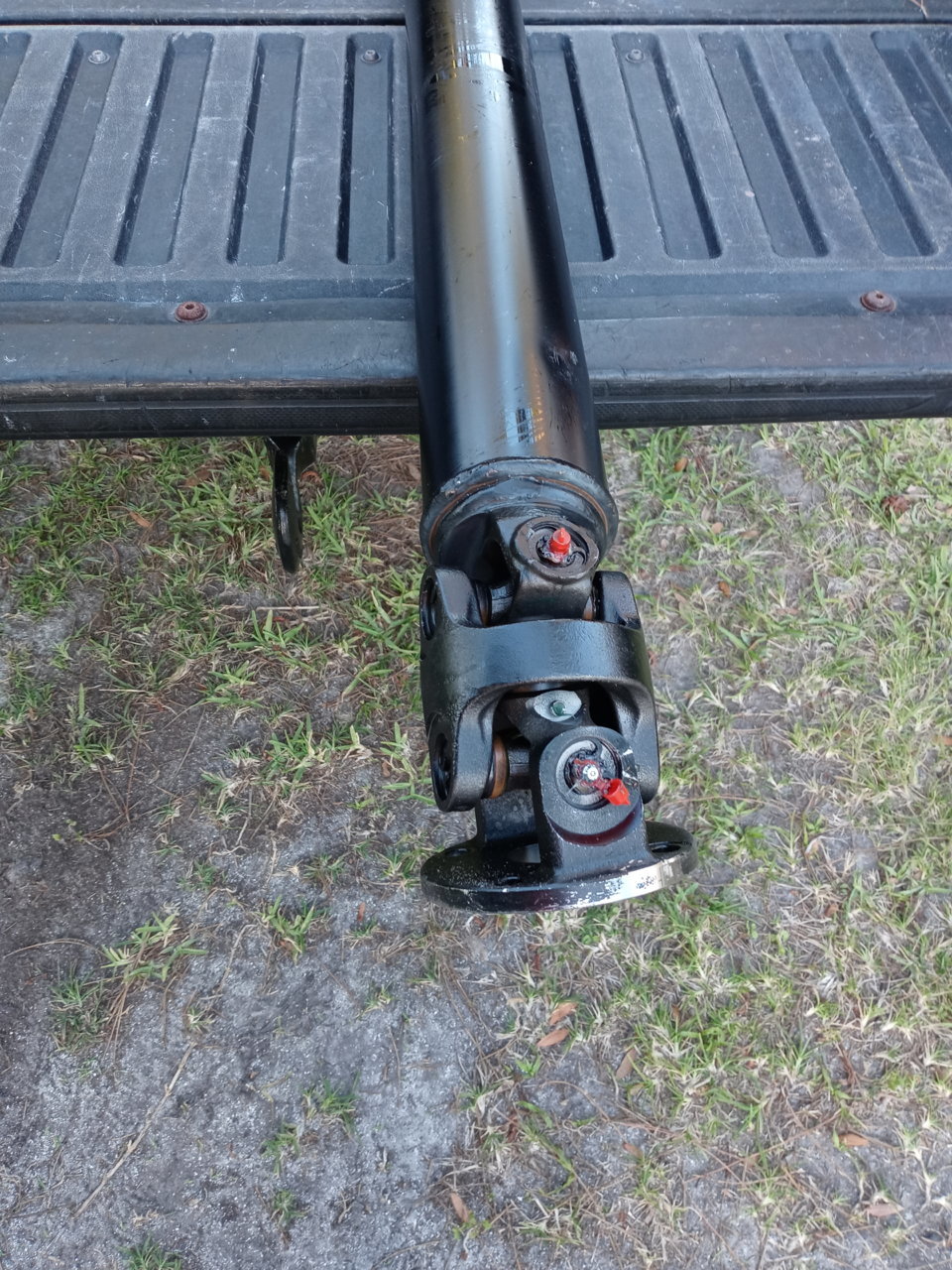

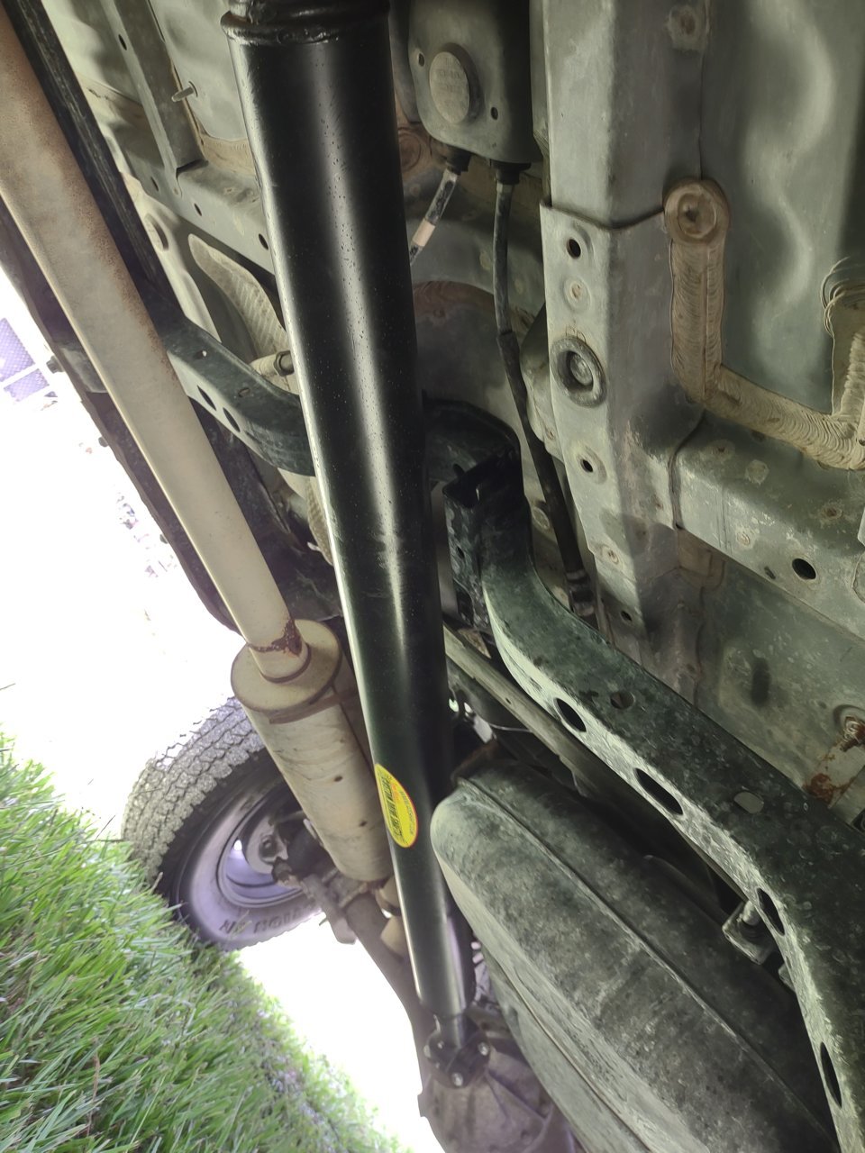

  14. Jul 4, 2021 at 8:50 AM
    Davetaco321
    Davetaco321 [OP] Well-Known Member
    Oct 16, 2017
    #233125
    75
    Black 06
    So I decided to go with the double cardon from Tom woods driveshaft in the front also .Very please with the performance of both drive shafts have had them on for a couple months now.
