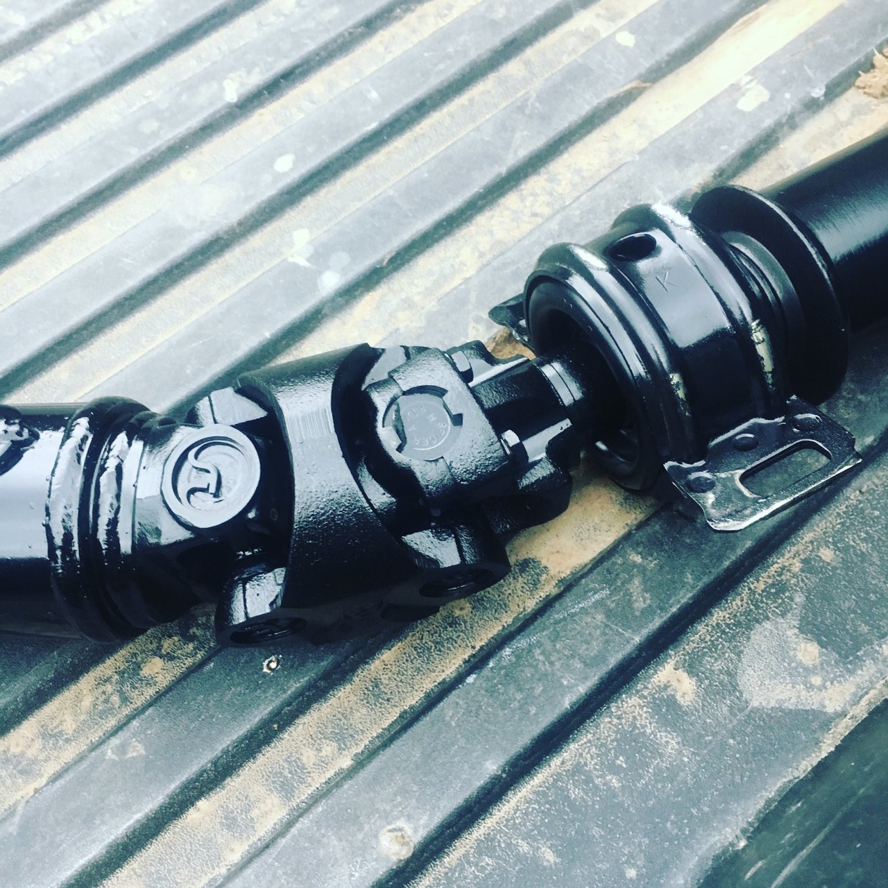

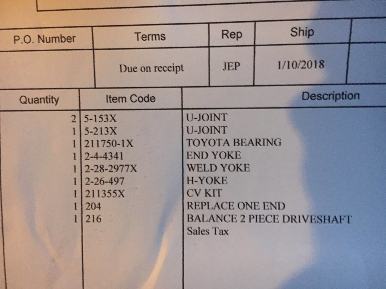

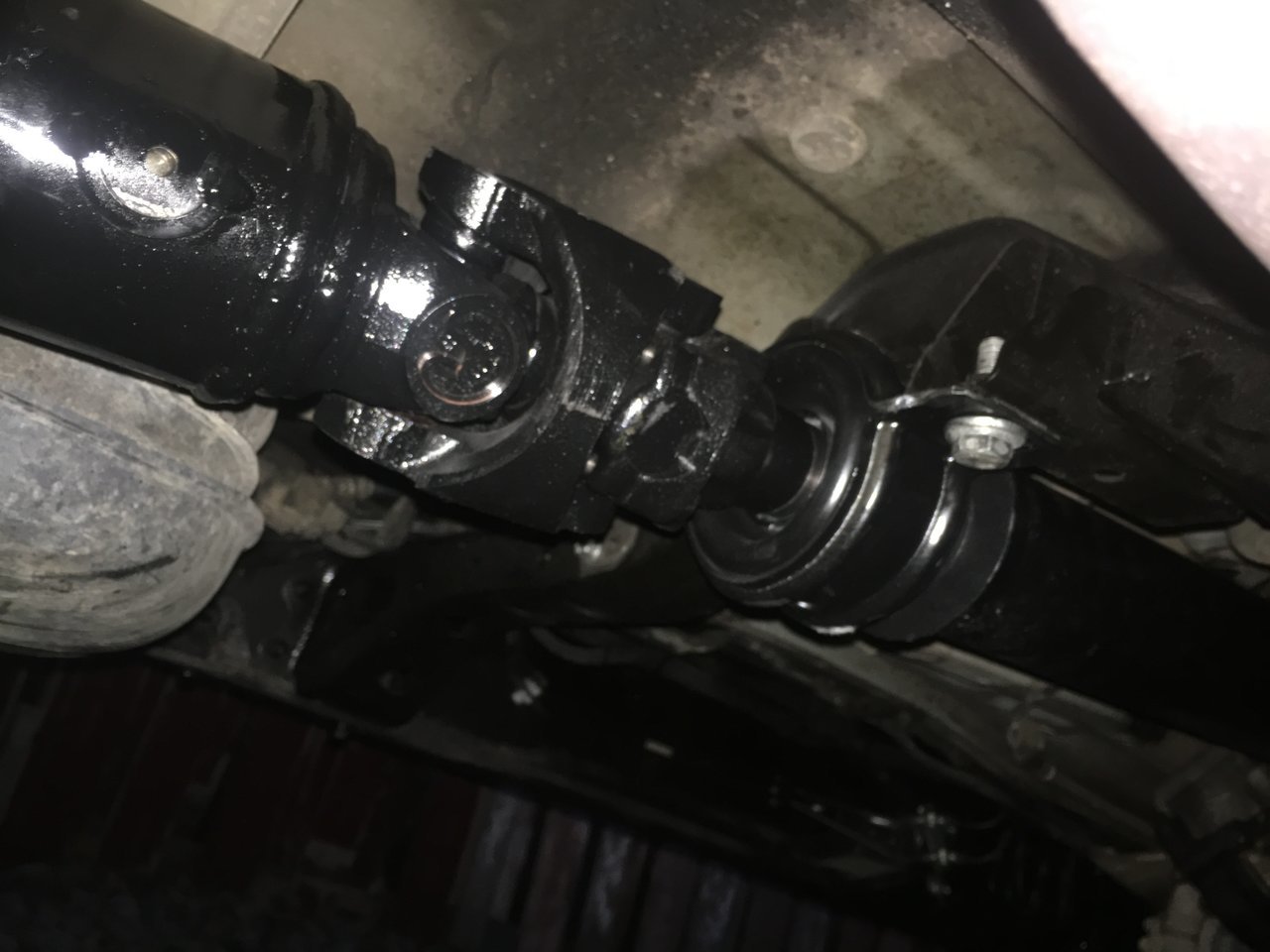

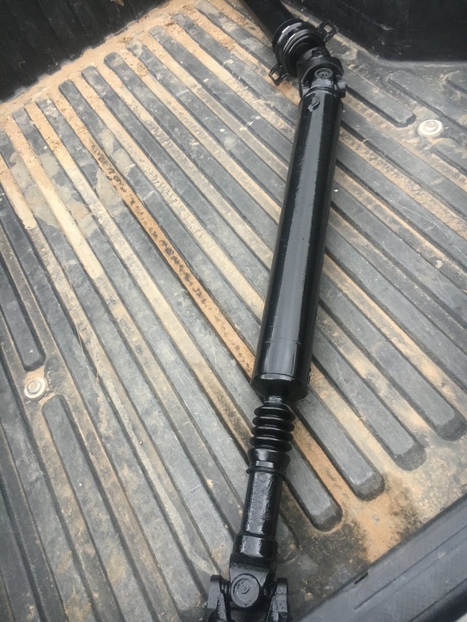

    So my drive line shop, Front Range Driveline, figured out a way to keep the 26 spline mid ship section and add a double cardan joint after the carrier bearing!
    We found that a Dana 300 transfer case yoke would work at the midship. So this means you don’t have to touch the front section of the shaft to get a double cardan joint.

    Upto to 50 mph (fastest I go on my commute home) she is smoooooth. I probably had 12-15 complete stops with different take off throttle input and smooth
