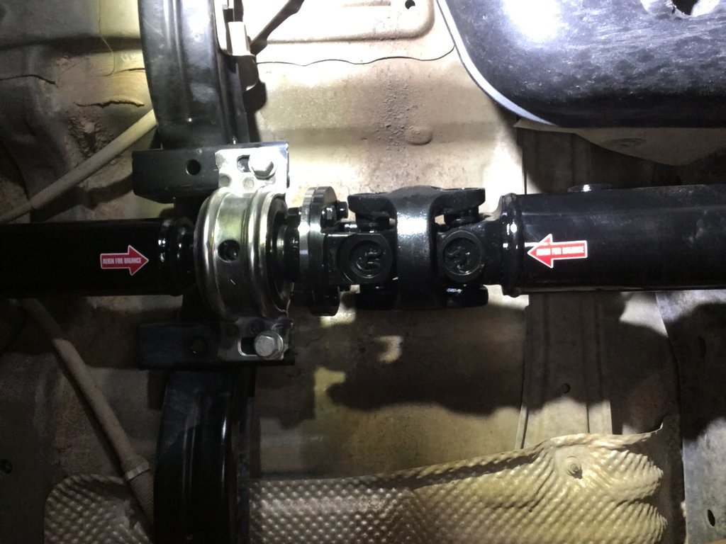

    The driveshaft wasn't painted today because he's waiting on a dust boot which will arrive tomorrow, but here are the pics of my nearly finished driveshaft.

    I'm paying Bay Area California prices, so please keep that in mind. $1,300
    That's a 100% new driveshaft with all USA made parts, CB and 1330 U-joints. A local shop was a little over a grand, but since this shop was highly rated and a fellow member had success there, I figured I'd just go this route, even though it's not local and a bit more money. I just want the issue fixed and I'm beyond tired of screwing with it. I've been under my truck and swapped axle shims and CB drops at least 20 times since I installed the TRD Pro kit and 3-AAL in the rear earlier this year. I should have just bought this from day one - I'd be ahead since I've wasted several days messing with this damn thing. Never got it fixed and I want it fixed.

    Driveshaft is finished. Picking it up on Monday.
    I did not want my stock shaft modified, so that's why I went all new. If it fixes the problem, spending $1,300 will be a distant memory in a couple of weeks. lol

    The OE driveshaft is out and I'm ready to pick up and install the replacement two piece with a double cardan joint tomorrow. Upon checking the rear shaft, the front and center u-joints were in good shape. The carrier bearing also feels smooth. The rear u-joint feels a little stiff on one axis, so I'm wondering if that wasn't helping matters. The shaft has about 40.5k miles on it. More to come after I install the new driveshaft tomorrow.

    That double cardan is BEEF compared to my 1310.
