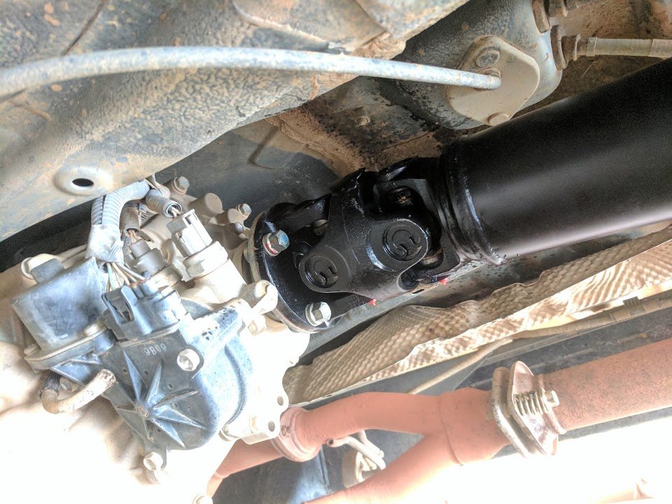

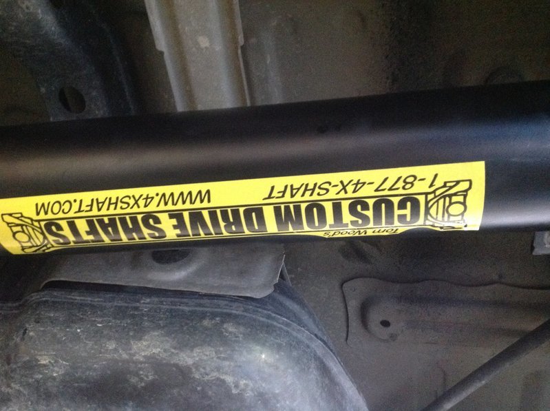

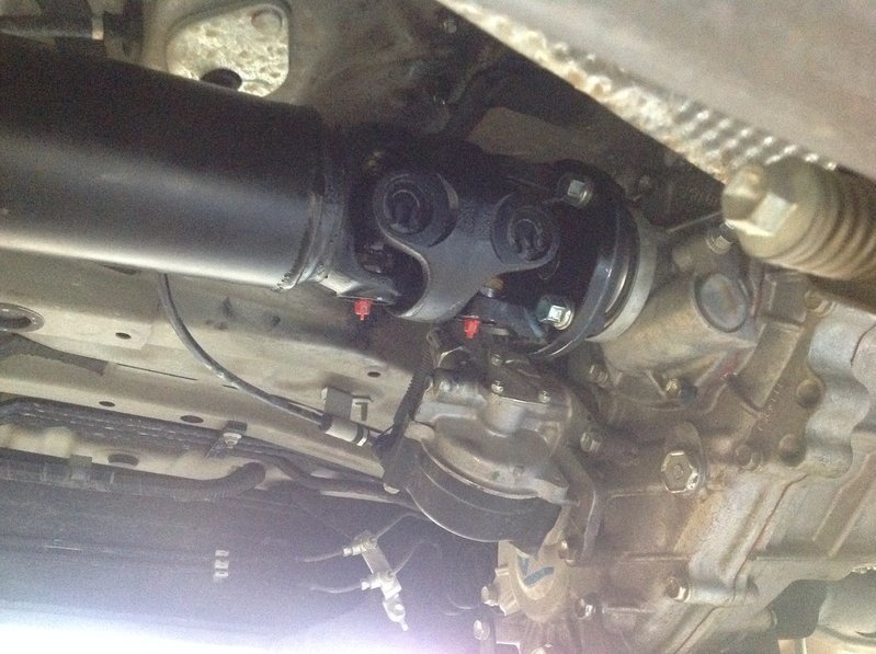

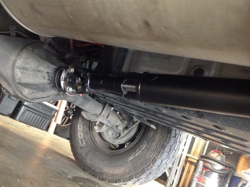

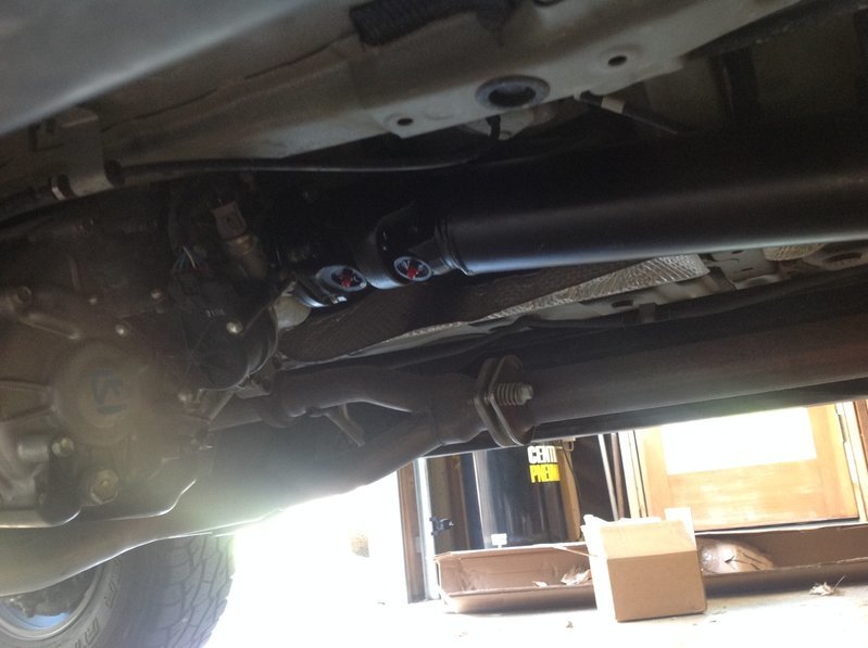

    image.jpg image.jpg image.jpg image.jpg Okay boys, she's in. Install was easy, with the right tools. The area is pretty tight at the transfer case. But with some extensions and gear wrenches it wasn't too bad. Took me right at 2 hours, but I double and triple checked and double and triple torqued. Torque spec thread says 65 ft lbs at both the double cardan flange and the rear diff flange It definitely could be done quicker. I'm just OCD. This thing is very very well made. And has ample grease zerks. I have to drive about 60 miles tomorrow, so I'll give my feedback then. Hit me with questions. Oh and by the way, for those that are extremely curious and doubtful, ground clearance loss (as stated above) is VERY minimal. I stopped counting all the things that sit lower than the drive shaft.
    otherphone, Biscuits, Bobcdn and 3 others like this.
