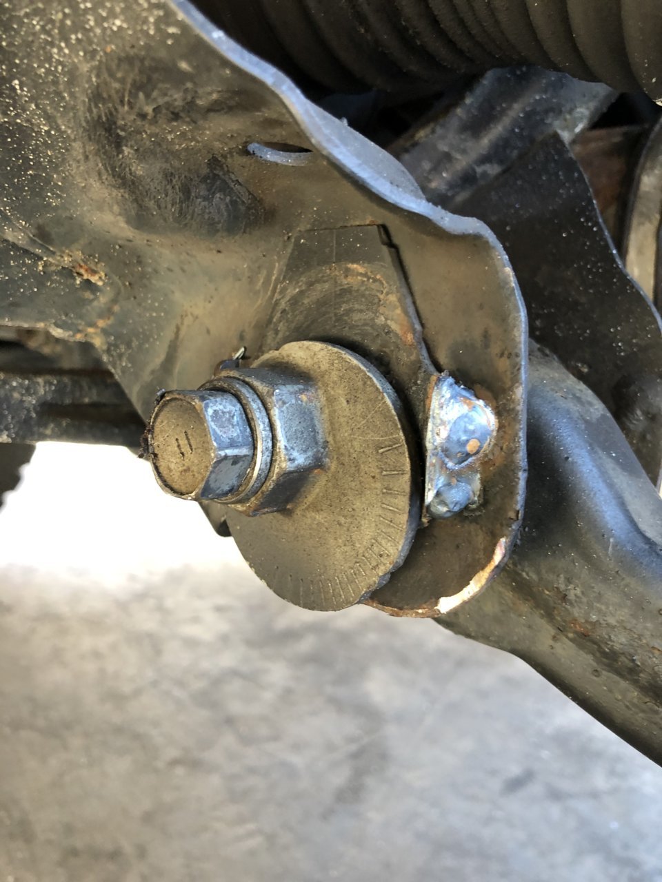

    Thank you everyone! Turns out my cam bolts are pretty seized up and causing an issue for sure.
    Looking for a replacmenet OEM LCA’s if anyone hasn’t a set laying around

    Check the center driveshaft boot right next to the gas tank. I bet it’s broken.

    Thanks everyone for the suggestions. Took a closer look at it this weekend and found that after my most recent alignment the cam bolt metal guides flattened out on one side causing the bolt to shift to the left and cause the clunk/click. Ended up bending it back, welding a bead behind the edges of the guide and painting it with some black rust protection paint. Got everything realigned today and the steering response as well as overall ride greatly improved!
    Picture below is of the cam bolt guide with the bead that we welded behind it.
