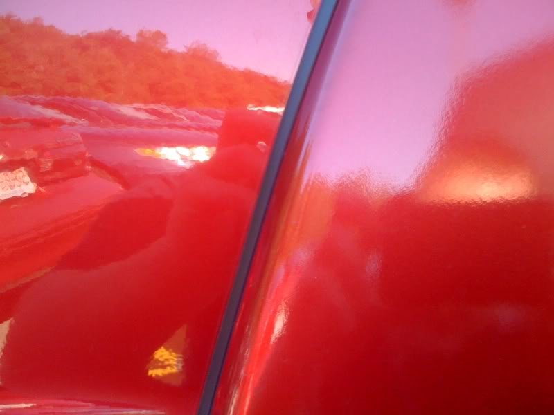

    I was buffing my truck over the weekend, and when I got to the fender flares I discovered that the paint was single stage! :eek: I was a bit shocked to see this.
    Single stage is so old school I didn't think anyone used it anymore. When I was looking to buy the vehicle I noticed right away that the front bumper and fender flares had a matte shine, and upon closer inspection I felt that the paint was applied rather 'dry', but I never expected it to be single stage.

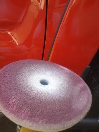

    Has anyone else noticed this about their vehicles? I discovered it was single stage because my buffing pad, which was brand new, turned red. The rest of the vehicle is base/clear. I will try to post a picture of it.

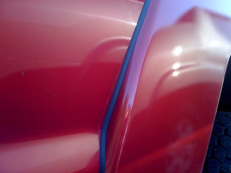

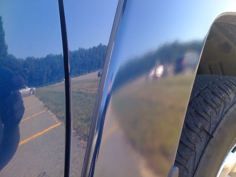

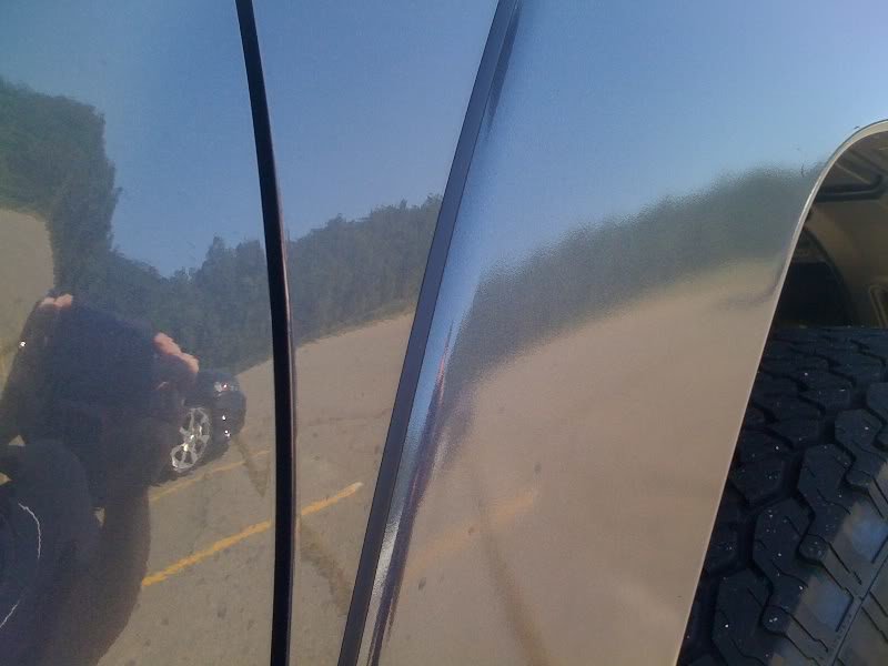

    I wanted to post some pics of different 2nd Gen Tacoma fender flares I took at my work. Look at the texture of the paint compared to the door and fender. It is clear that the orange peel is different (it is drier) on the flares then the panels.

    Its like that because thats the texture of the plastic flares.

    x2. Chris is correct, it's not a "cheap paint job", it's just that the same paint put on different surface materials will always have a different textrure or light reflectivity. The paint on the flares - since it's plastic - is likely a different chemistry as well. I noticed it on my truck as well.....no sweat. As long as it doesn't fade or peel, I am totally cool with it. What do you use to buff with? I want to buy a good tool....

    The red paint on my buffer wheel indicates without a doubt that the paint is single stage. The fact that I have identified it on other Tacomas shows that it isn't just my vehicle, and it is not a result of a repair or aftermarket addition to my vehicle.
    Chris I have to respectfully disagree with you that it is the texture of the flares. We all appreciate the advice you provide us on TW; I have significantly benefited from it. But I have professionally painted many plastic parts in my day. When a part is offered painted or non-painted, they have always been different parts, with the non-painted part having the texture you refer to. Now I haven't painted a Tacoma flare or bumper cover so I am assuming Toyota follows suit, but you can't paint a textured part and achieve quality adhesion; its impossible to scuff the areas between the textured bumps. I am not saying that all shops don't do this, because incorrect parts are ordered all the time and vehicles need to get out the door, but I am certain that the manufacturer doesn't suggest that, and doesn't build its vehicles that way. I am confident that when a textured part that is painted, without completely sanding out the texture, it will chip and/or delaminate more then then the part that doesn't have the texture. I am not talking about the chip guard on the bottom panels; this texture is much bigger, and this coating is applied during the painting process, and doesn't get sanded.
    Plastic panels can and do achieve the same level of gloss as the metal panels. Take a look passenger cars, their bumper covers achieve the same paint gloss and texture as their panels. Especially high end vehicles such as BMW or Mercedes. It is true that some paint suppliers require a flex agent be put into the clearcoat, but its affect on the gloss is minimal. It is my guess that Toyota has taken this route for the fender flares and bumper covers for our trucks for two reasons: One it is cheaper. The second is that with the reduction in gloss, these parts hide scuff marks better, which is a desirable characteristic on a 4x4 vehicle.

    IMO the buffer wheel tells all. That was a brand new pad. I noticed the difference in the panels immediately when I went to buy the vehicle, but I thought it was just base/clear applied dry. I was wrong.

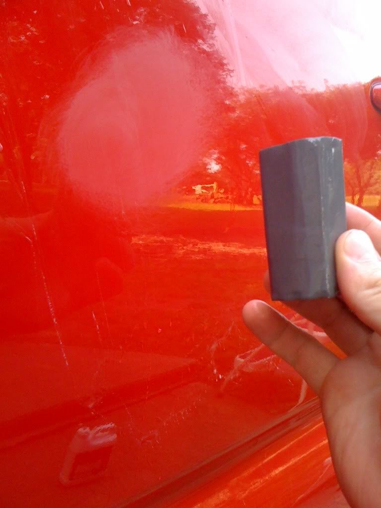

    Our Tacoma's have base/clear on the metal panels. Check out this pic; if it was single stage then the sandpaper would have red on it. The panel sands clear (it looks white actually), therefore it must be base/clear.

    I hate to tell you that your wrong but you are, I am a body/paint man and the painted fender flares are the same as the non painted version, it is not orange peel it is the texture of the plastic, they are not like bumpers you get that are textered if not painted and smooth if they are, and they are also not single staged, it does not have the same amount of clear and with the amount of texture it does not get the high gloss, I get asked all the time if I can wet sand the orange peel out but you would have to sand it flat to get that.Also the plastic heats up alot faster especially with that meguiars cutting pad you are using, that shouldnt be used on plastic, or at least the speed turned way down, and also those red meguiar pad you are using will bleed color from the pad just like a new shirt, if you dont see burn marks on the flare then the red is from the pad, I can take pictures of my same pad and it has the same color until ive used it a few times. They also use a adhesion promoter on everything to insure proper adhesion,
