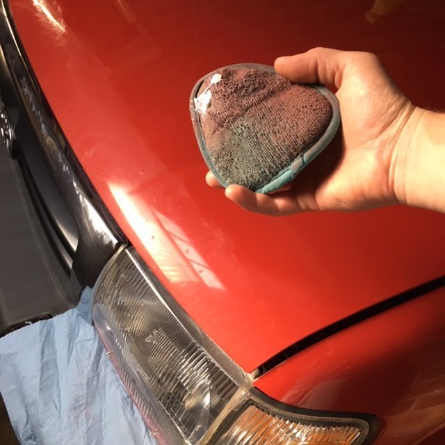

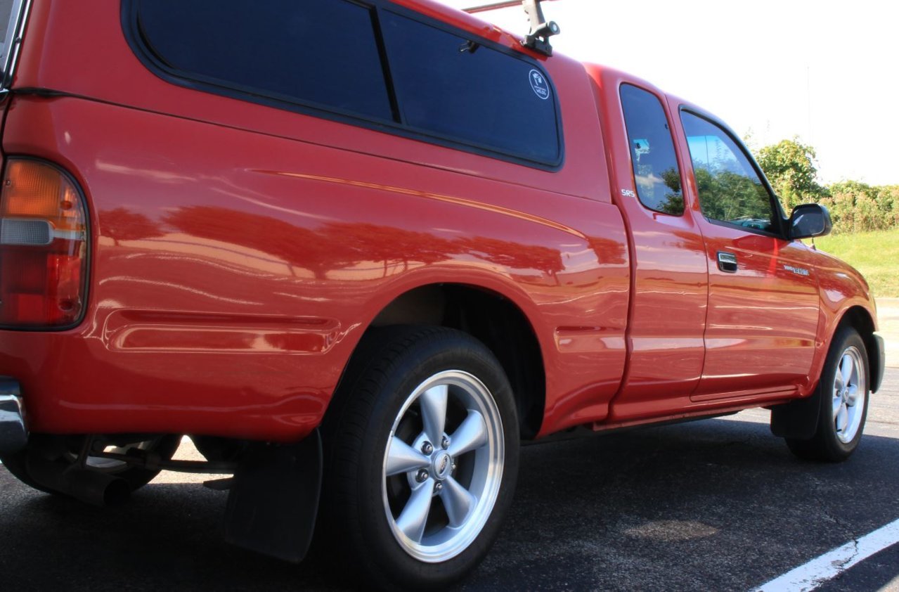

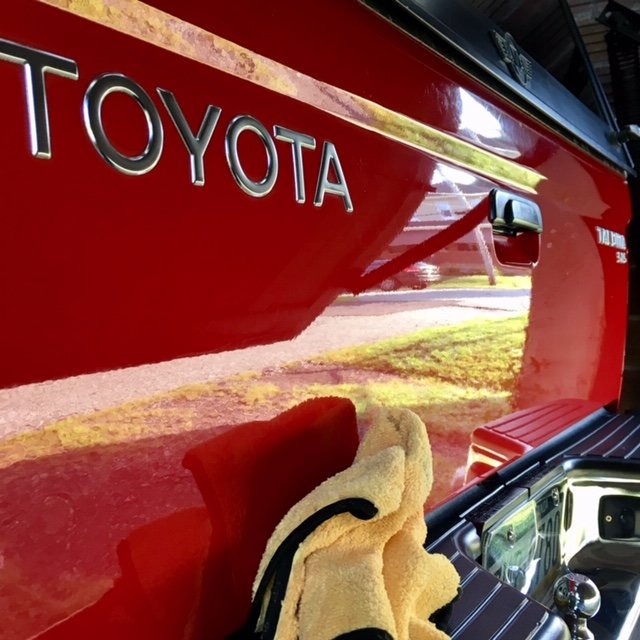

    To the OP, I recently compounded my '00 SR5 and, yes, I can confirm that it is single-stage paint. I had to wash my buffing towels about six times because they got so clogged up with red paint.
    On the bright side, the paint turned out great even though it was a ton of work. The trick now is to keep up with it and preventing sunfade... because as already stated in this thread, red paint fades fast.

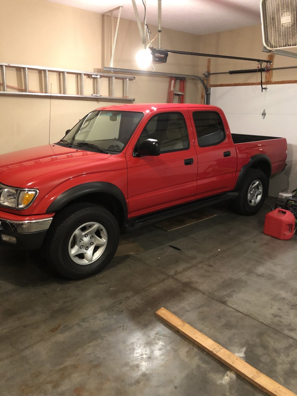

    5742CBC2-1D71-4322-869D-FD6FC7BBE86A.jpg I’m by no means a paint and body expert. But I do believe my 03 is base coat clear coat. When I purchased this truck a couple months ago it has a haze look to it. I know that it has not been waxed in years. Just a basic wash. And sat outside. When I buffed on the paint with compound, my pads did not turn red. But sure came out nice. The right rear fender had been repaired at some point and they clear coated it. I know this because they did a less then adequate job, clear coating over scratches and chips. I too stripped my truck of ALL stickers and emblems. I like the sterile look. Plus it’s easier to wax and clean
