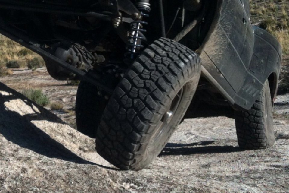

    Here's the siping I did to my buddy's KM2s.
    Night and day difference in the winter. Not snowflake rated by any means, but way better than slicks.

    ^^ What did you use to sipe them? Some guy over in the Jeep forums IIRC was using a Skil saw to sipe his MTs. A but gutsy for me.:eek:

    I used a tire groover (same exact one pictured below) with a #1 head and round blades.
