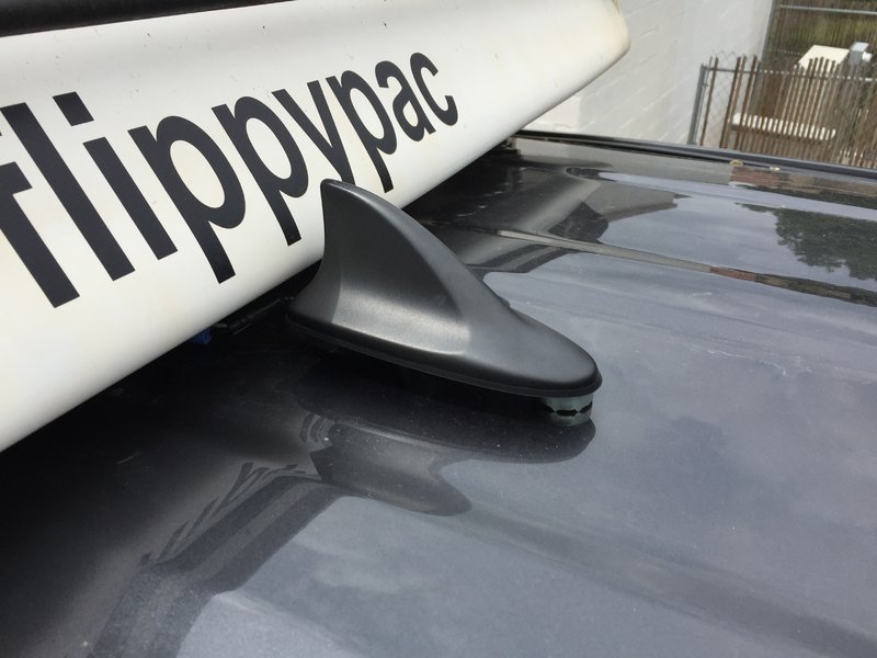

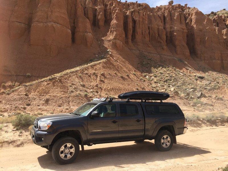

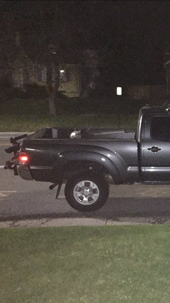

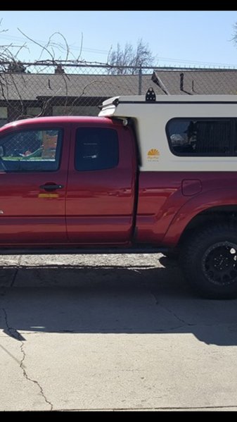

    I am interested in moving my sat antenna too. I'm picking up a flipac shell tomorrow and I'm certain I'll have to remove the antenna just to install the shell. I'm expext it will involve drilling holes so I can move it forward a few inches. Have you moved yours yet?
    Here's my truck with the fin antenna barley visible
    Here's the flipac on the sellers truck that doesn't have a fin antenna

    image.jpg I just had a cargo box above mine for about a month and didn't notice any differences with reception. It was hanging over it by almost a foot.

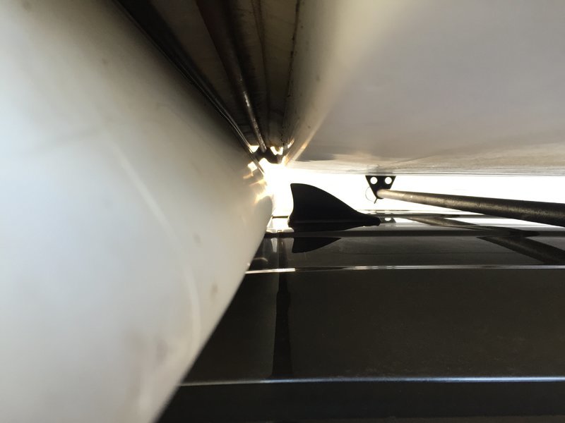

    So I picked up the Flippac and had to immediately removed the antenna from the roof. About a week later I decided to go for it and cut the holes to reposition it. I dropped the rear half of the headliner and got measurements. The main hole is a 1/2 in by 7/8 in rectangle, and there is a pilot hole that is about 1/4 in. I started by separating the antenna wire to see how much I had to work with. NYNURSE is right, I was able to pull the wires diagonally and reach the new antenna location 6 in forward on the roof. I then marked carefully, making sure the Flippac would clear it when opened as well as closed, and drilled two, 1/2 in holes side by side. I then had to spend an hour and a half with a metal file turning the figure 8 into a rectangle. This did not create very pleasant sounds. Once I could see the antenna would fit I was able to see where to drill the pilot hole. The day after I moved the antenna we had a huge rainstorm, the antenna didn't leak at all. I'm planning to open it back up and put nail polish on the new openings to prevent rust. I still have duct tape covering the previous antenna location, if anyone has any good ideas on how to seal this more permanently it would be appreciated.
    Picture 1: New location with antenna resting
    Picture 2: new location completed with Flippac open

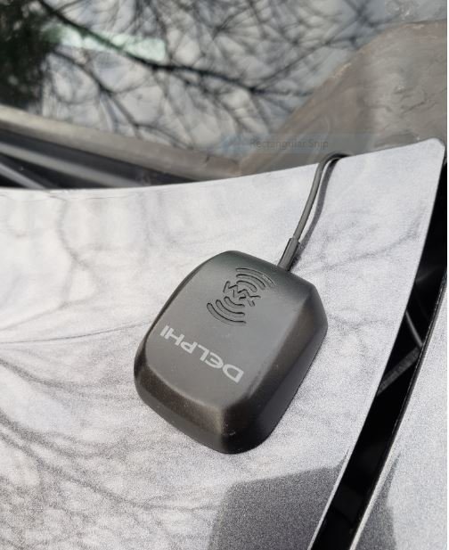

    I have a pop up camper for my 2017 and get zero satellite reception when the camper is on. Local auto a/v shops and dealer were no help in finding a solution for relocating or providing an alternative antenna. After much internet searching I found a review on Amazon for an adapter part that does the trick:
    https://www.amazon.com/gp/product/B0083TX86S/ref=ppx_yo_dt_b_asin_title_o02__o00_s00?ie=UTF8&psc=1
    Use this with any satellite antenna such as this: https://www.amazon.com/XM-Interoper...43881&sr=1-9&keywords=satellite+radio+antenna
    Removing the radio to trade out the satellite antenna is super easy: https://www.youtube.com/watch?v=Yp-i9p6T6Go

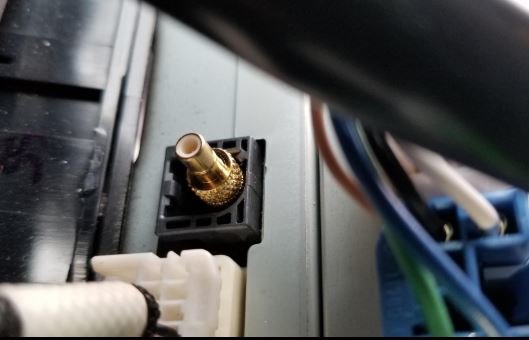

    Once the you have the radio removed, unplug the factory connection, put on the adapter, fish the antenna wire through the opening behind the radio, under the the dash and out to the hood. Connect the new satellite antenna and re-install the radio. Might have to use a little tape to keep the wire snugged into the weatherstripping around the door opening frame.

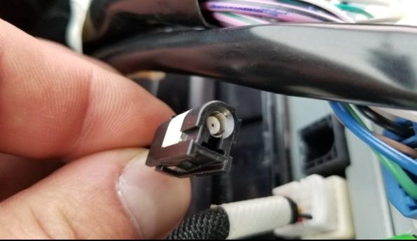

    Here's the stock antenna connection:
    Here's the adaptor installed in the back of the radio:

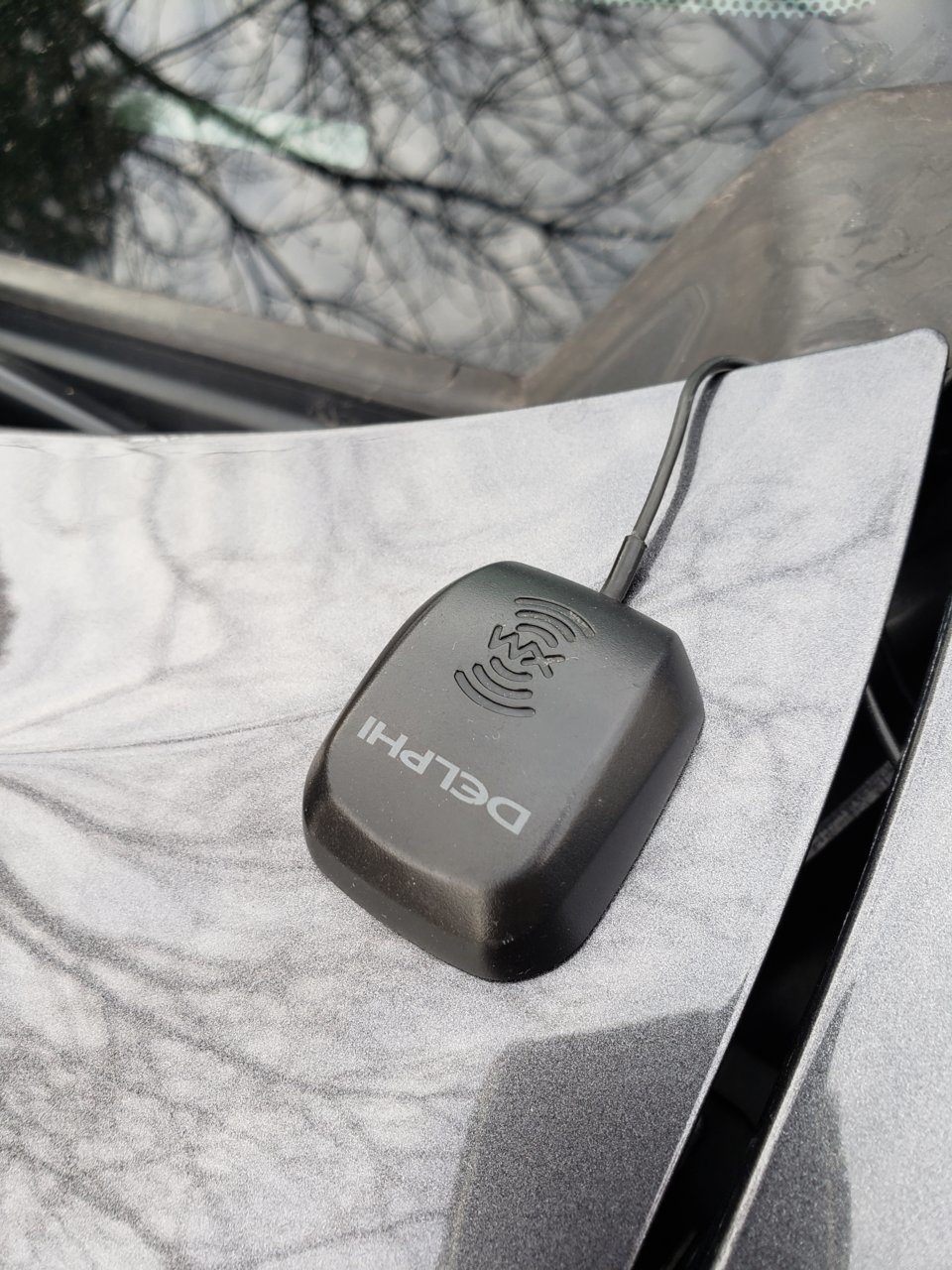

    And here's the antenna attached to the adaptor:
    Antenna on the hood:
    Works perfectly and no issues with AM/FM, GPS, etc.

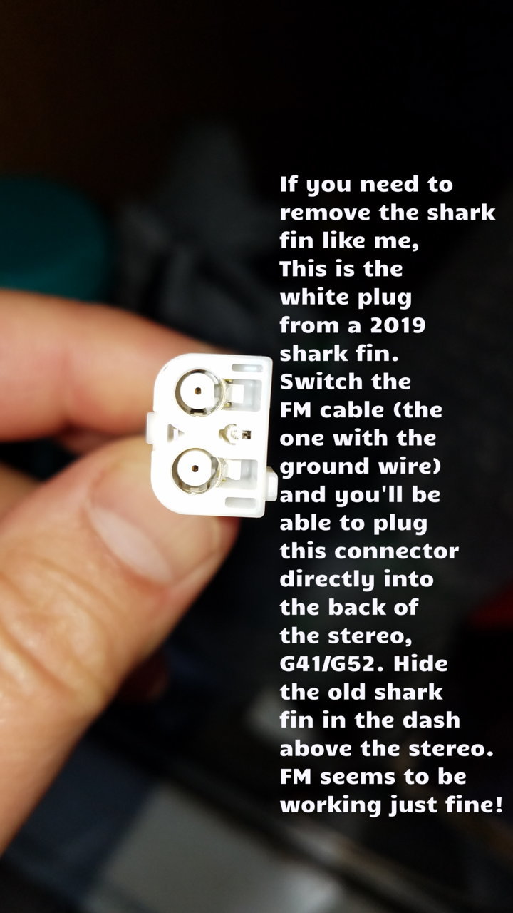

    This is for a 2019 OR-DC-LB Premium with JBL. The solution below may or may not not work with other models (non JBL).

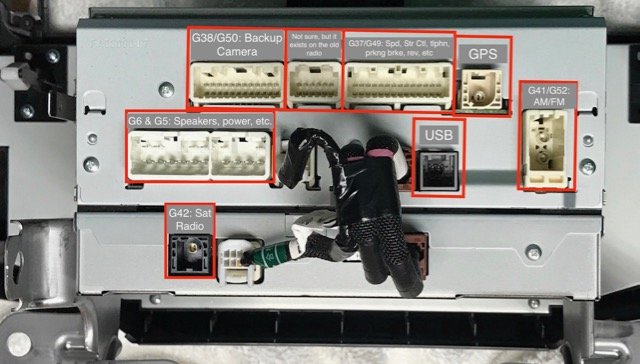

    So, I ended up removing my 2019 shark fin altogether and replaced it with an older stubby shark fin. More on why here (cab-over camper). The above how-to worked great for the XM, but since I'd removed my shark fin, I no longer had FM/AM radio. My solution, after seeing the diagram , I was able to plug the shark fin directly into the back of the stereo unit FM connector, but first, in order to do that I had to switch cables in the white plug. The coaxial cable with the extra ground wire is the FM one. Switch the two cables in the plug in order to line up the FM side into the G41/G52 slot (the FM connector is the bottom one). I switched the cables, pushed the white plug in, and the FM worked fine. So, where did I put the old shark fin FM antenna? Funny enough, there's actually a triangle slot below the dash directly above the stereo. I hid the old shark fin in there and put the dash back together. I now have XM from my new remote hood antenna and FM/AM reception from my old shark fin located above the stereo under the dash. I'm sure the FM reception may not be as good quality as stock, but it works!
    313587d1538357520-entune-retrofit-basic-_746b65df1a2057b19d6de7df7f460ef9b3923edb.jpg
