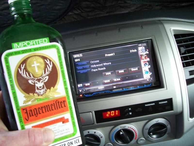

    Not wanting to spend 60-70$ on a sharkfin rippoff cable I found this on the web. I cut the wire right behind the antenna plug connector behind the kickpanel. Stripped the wire on the scc1 antenna cable and the factory xm cable as shown in the link below then soldered the connections. The wire braids were a pain to get back together and solder due to little space to work, so i put some aluminum tape around the wire braids to make sure of a good connection. After that i used electrical tape to finish it up. Sirius radio is jamming in my truck right now and i have some extra cash for beer and VODKA = )
    http://www.xm411.com/phpbb/viewtopic.php?t=4092

    Very impressive! I wish I had the confidece to do what you did. Instead, I'll be a few drinks short when I install my cable, I agree, for such a small part, I paid twice as much as the actual receiver from Sirius, so when the time comes to have that drink, I'll already be 2 bottles down compared to you! Great job!
