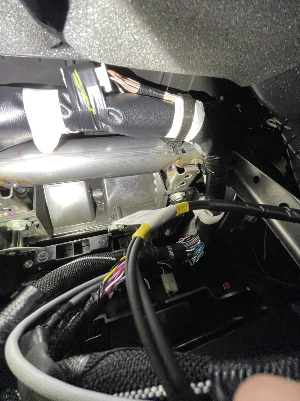

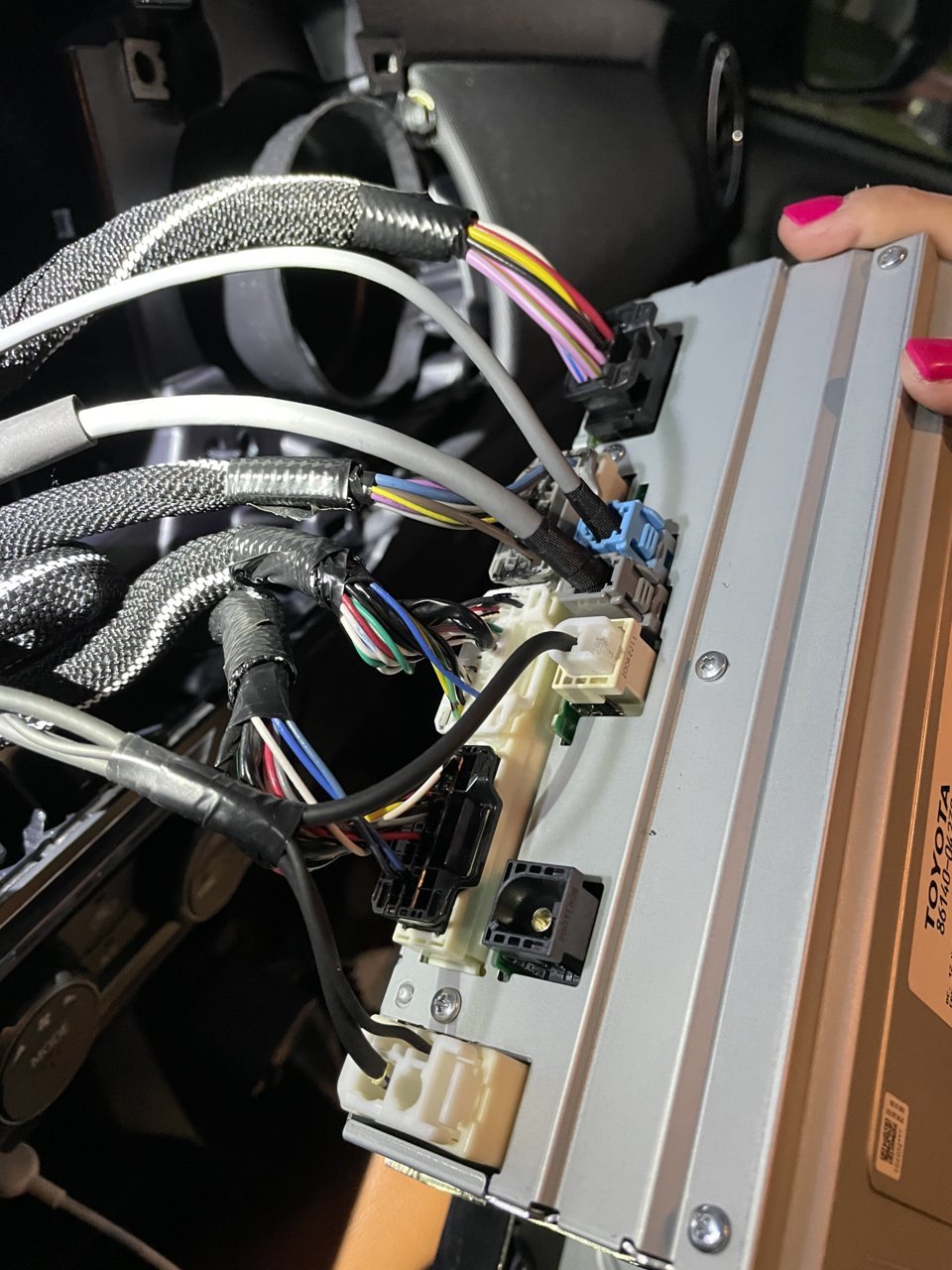

    Removed the head. Can anyone tell me if these picture show a standard setup?

    2020 might be different, but on the pre 2020 HU the whole XM unit is missing from those pictures.

    Thank you. That settles it then. They are shipping them to PR and Hawaii without the XM Unit.
    Are those sold independently?
