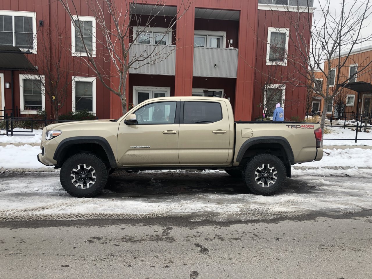

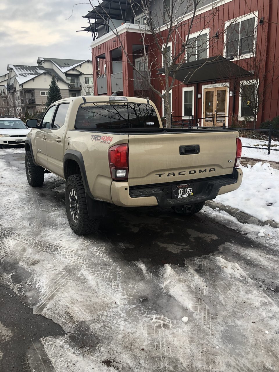

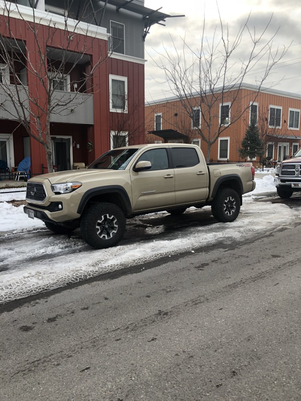

    Everything finally installed, here’s what’s on her!
    Lift:
    Bilstein 5100 all around, OME 887’s, wheeler’s single AAL, driver side spacer for lean.
    ~$600, pieced together from down south motor sports and wheeler’s
    Wheels:
    1.5” bora hub centric wheel spacers,
    Planning on derping the OR wheels after tires go on.
    $220 (wheelers)

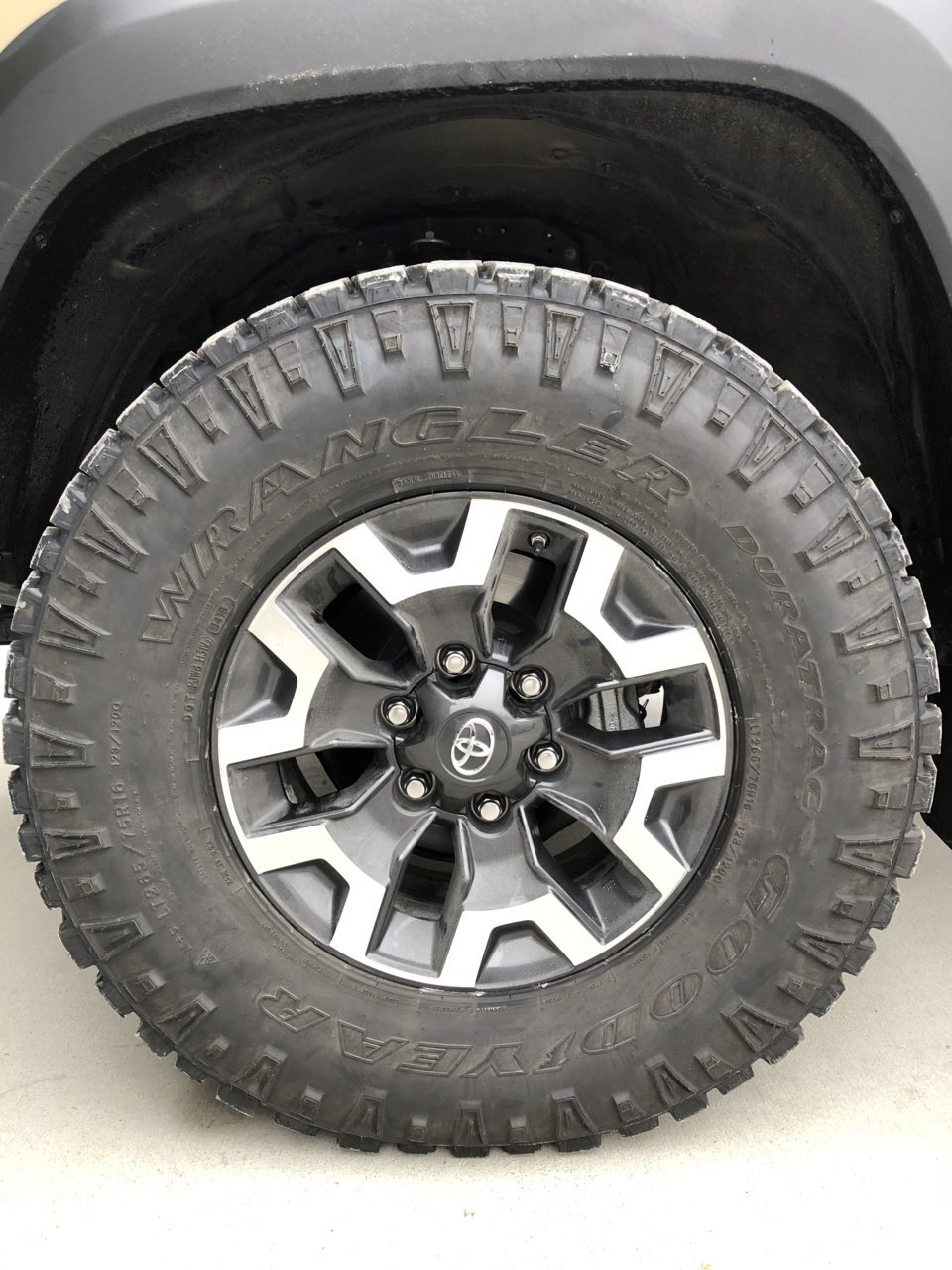

    Tires:
    Duratrac 265/75r16 (used 3 days) $600 installed @ discount tire
    Tuffskinz tailgate “Tacoma” black out letter package
    $40
    To do:
    20” light bar (behind slot thing beneath the grill)
    Dip wheels?
    Carhartt gravel seat covers

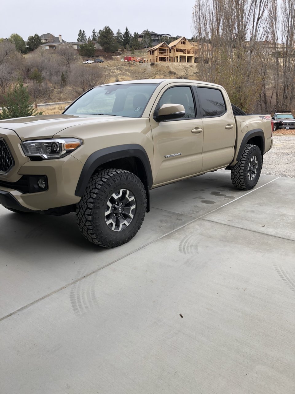

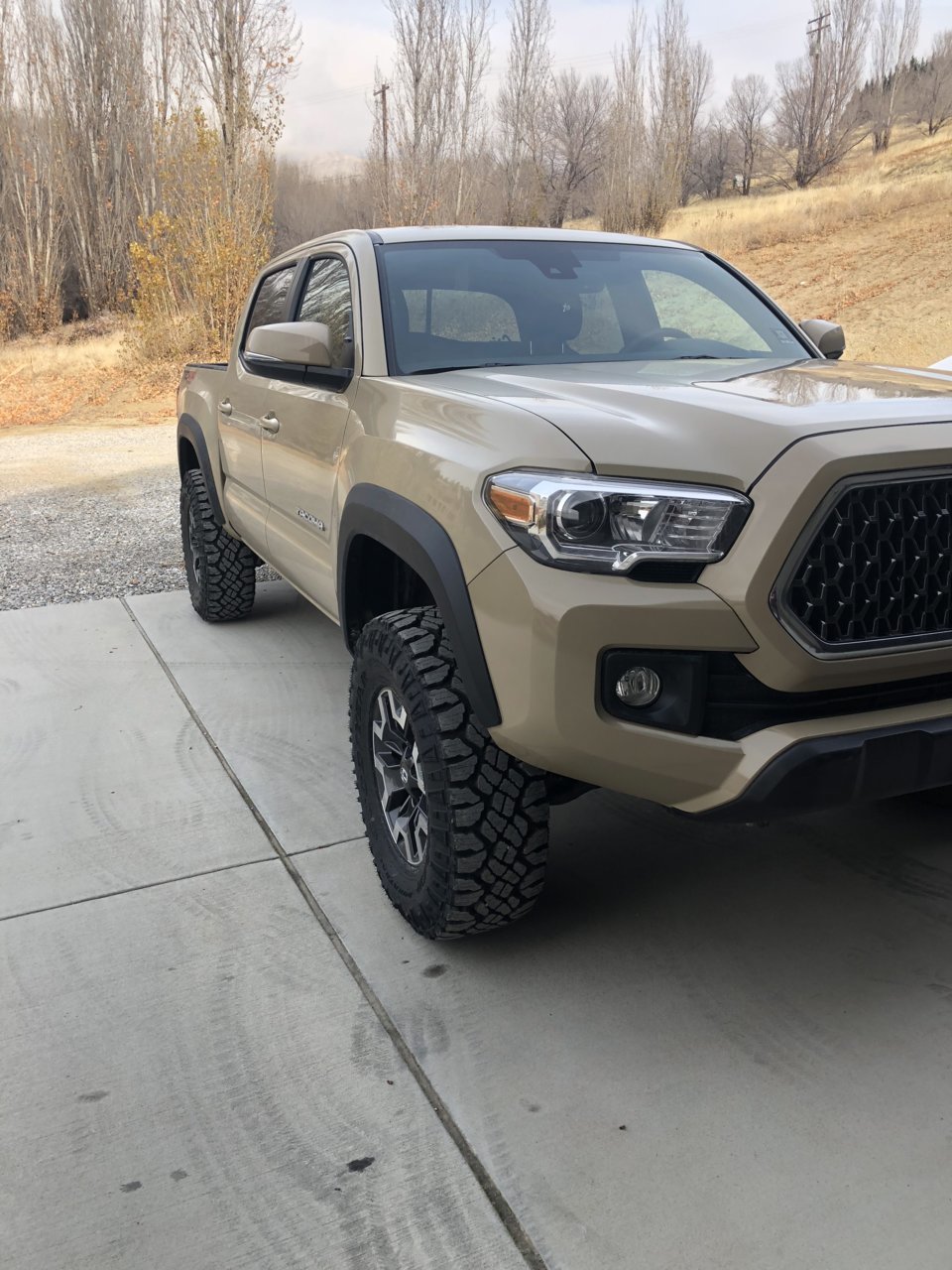

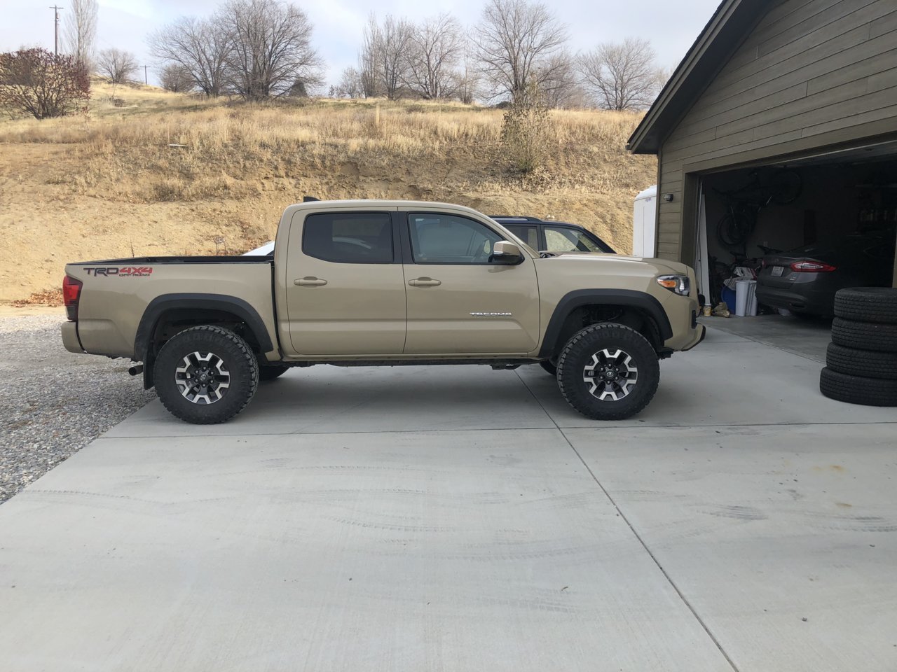

    Wheel spacers and tires on, lift going on this evening most likely! Got some rubbing on the mudflaps currently..A45BD793-49E6-48B4-9562-F09203A1F23C.jpg52E5D955-87EB-46B3-9C72-314BD4ABF20D.jpg

    Looking good! Can't wait to hear your impressions of the 887/5100 combo. Good luck with the install!

    I dig it! Those tires are a strong contender of mine when the time comes (along with wildpeaks, open countrys and discoverer s/t maxxs) . At the price you got them for it would be a no brainer. Looking forward to seeing her done!

    I was looking at the wildpeaks too, actually I went in to see if they had them in stock (they didn’t) but that’s when the tech mentioned he had the duratracs fresh off a truck. (They put the wrong size on some guys truck) very lucky for me!

    What load rating are your durtracs?
  9. Nov 22, 2018 at 9:48 AM
    sirm
    sirm [OP] Well-Known Member
    Aug 5, 2018
    #261782
    97
    2018 TRD OR
    C, I think they’re around 43 pounds

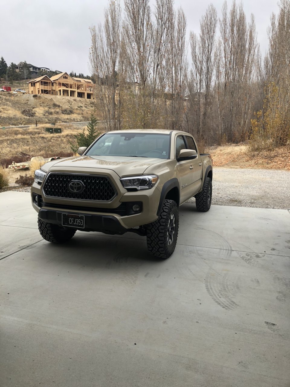

    Front lift installed, got around 2.25” of lift. Doing the back this weekend.

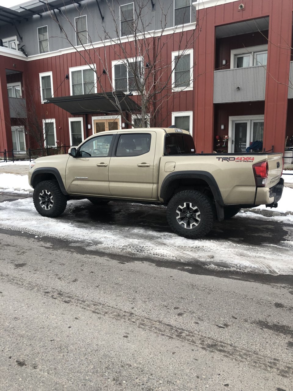

    Add a leaf on ✔️

    I have not done anything to a vehicle except change a tire before the lift and I installed the front successfully in about 3 hrs with the help of YouTube. I even assembled the Coilovers myself with a rented spring compressor from Napa. The rear was different on the other hand. I’m sure it was just my inexperience cause it looks so simple on the videos, but I could not get the damn center pin to go through. Put it back together stock then just took it to a shop to get it installed. As for the ride I prefer it over stock. Stiffer, but not to be mistaken with harsher. It just feels more planted, much less roll and way better handling overall.
