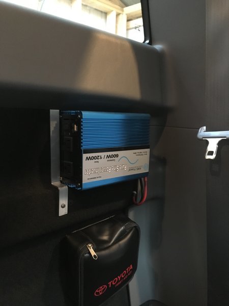

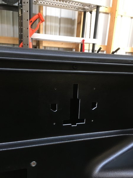

    Got my inverter mounted, but having second thoughts about the extent to which I'll have to cut into the bed to mount the OEM outlet. Didn't realize it would require that much cutting, I had envisioned a single small-ish cutout for the back of the outlet. Should have known it wouldn't be that simple. I'm fully capable of making neat cutouts, just apprehensive to do so.

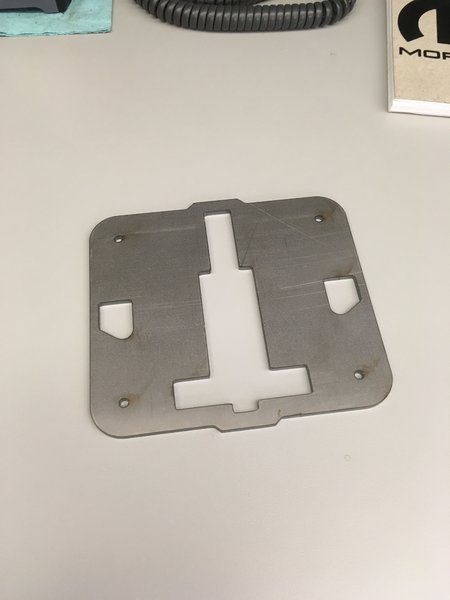

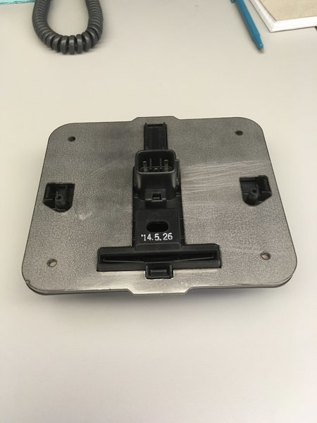

    Just had to gather my thoughts on how to do it, and decided to make a cut template from 1/8" steel plate. Now that it's served its template purpose, I'll drill out & tap the 4 holes so it will serve as a backing/mounting plate behind the composite bed wall. Still have to run the wires & mount the outlet.

    Damn man. That is really nice lookin!

    Thanks brotha! It seemed like a safe way to get the proper cutouts in place.

    Definately! My cutout was cardboard lol
