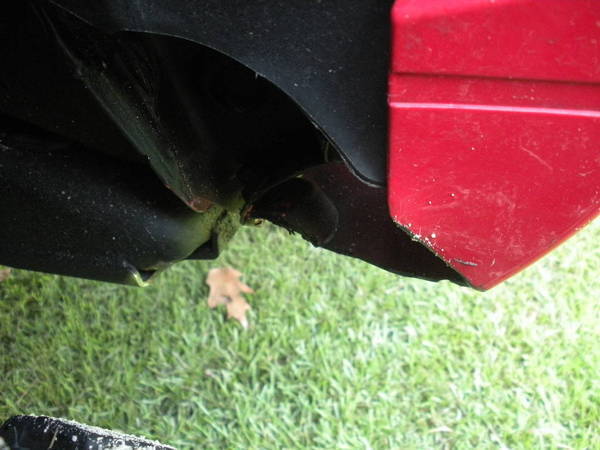

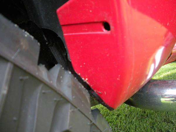

    right now i have 35's on my 6in lift and they rub a bit.

    they fit the only time they rub is when i turn at full lock. I have trimmed some but they still rub and it gets annoying after a while

    i would just trim more personally.

    Yea it isn't for a long time it is just every time i turn into my drive way because it is a gravel drive way and on an incline they rub and if i have to turn around or park or anything like that they rub

    hmmm wheres it rubbing? front? cab mount? uca?

    The front finder lining

    Do you have spacers on those, or is it just from the offset of the rims?

    I have spacers and there is a little from the offset of the rims which i am not sure exactly what that is

    if you take the spacers off, you will not rub anymore.

    Yea i wasn't realy sure if that would help or make it worse i was going to try it befor i made my decision. I do have to see what it looks like because i don't want the tires to be stuffed under the truck i like the way they stick out a little bit. With the back spacing of the rim they should still stick out some though
