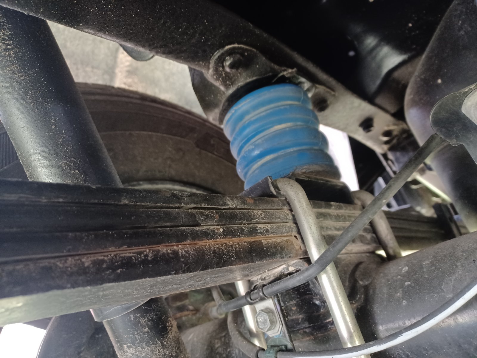

    Photo of springs with minimum load. Are the Sumo springs the cause of going flat/negative bend?
    Had the same setup on my 2012. Springs were arched.

    When I do this work, can I add a leaf to the OEM springs? They are totally flat now.

    Do the air bags essentially replace the leaf spring function or do I still need appropriately sized leafs?
    I don't like that they're currently flat with no load. Are they so weak the Sumosprings are flattening them? Worried about breaking a leaf spring under load while on a trip. In the many past years it's happened twice but I don't haul the same machinery and millwork now.

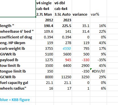

    I looked up some stats on old and new truck from the owner manuals. Various online references were sometimes different (erroneous.) What I could not find in my manuals was the Curb Weight for the 2023 and have inferred it from Kelly Blue Book listing.
    Looks like I'm over payload limit on the new truck when on trips!

    Its pretty normal for the leafs to be flat on tacomas. dont stress about that too much

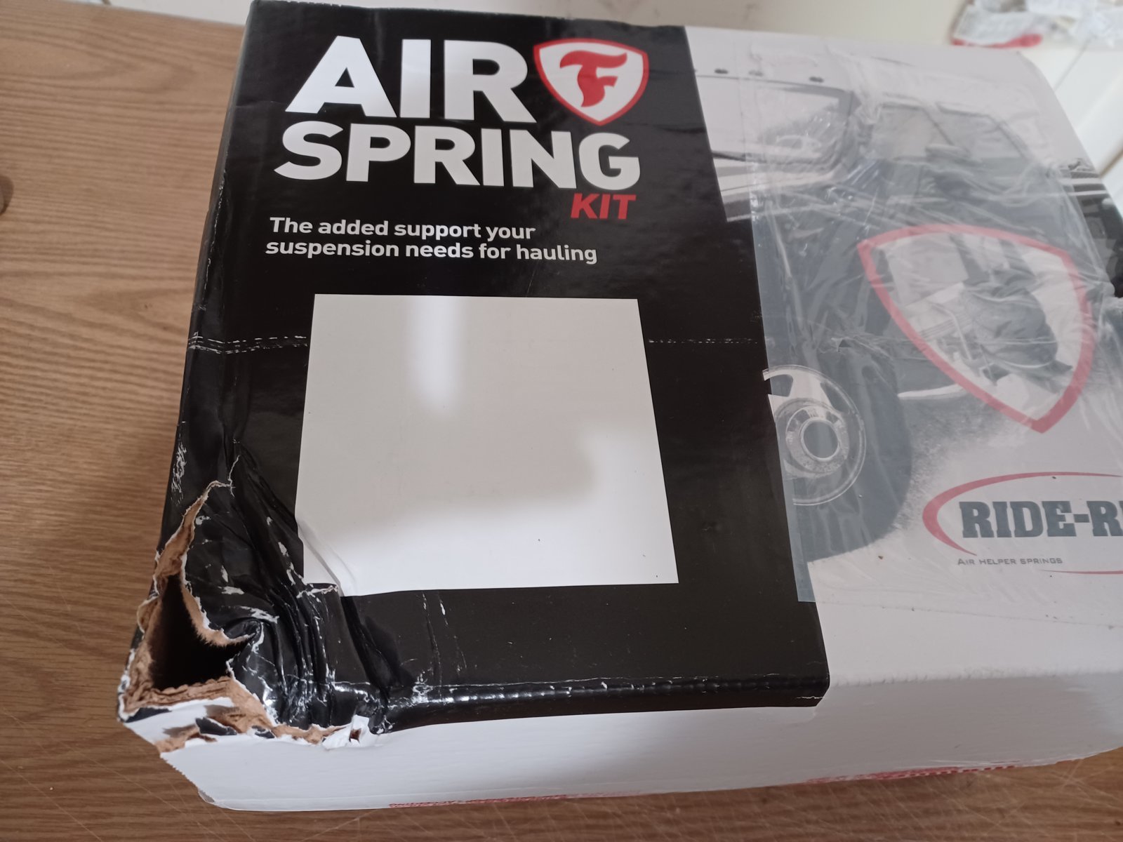

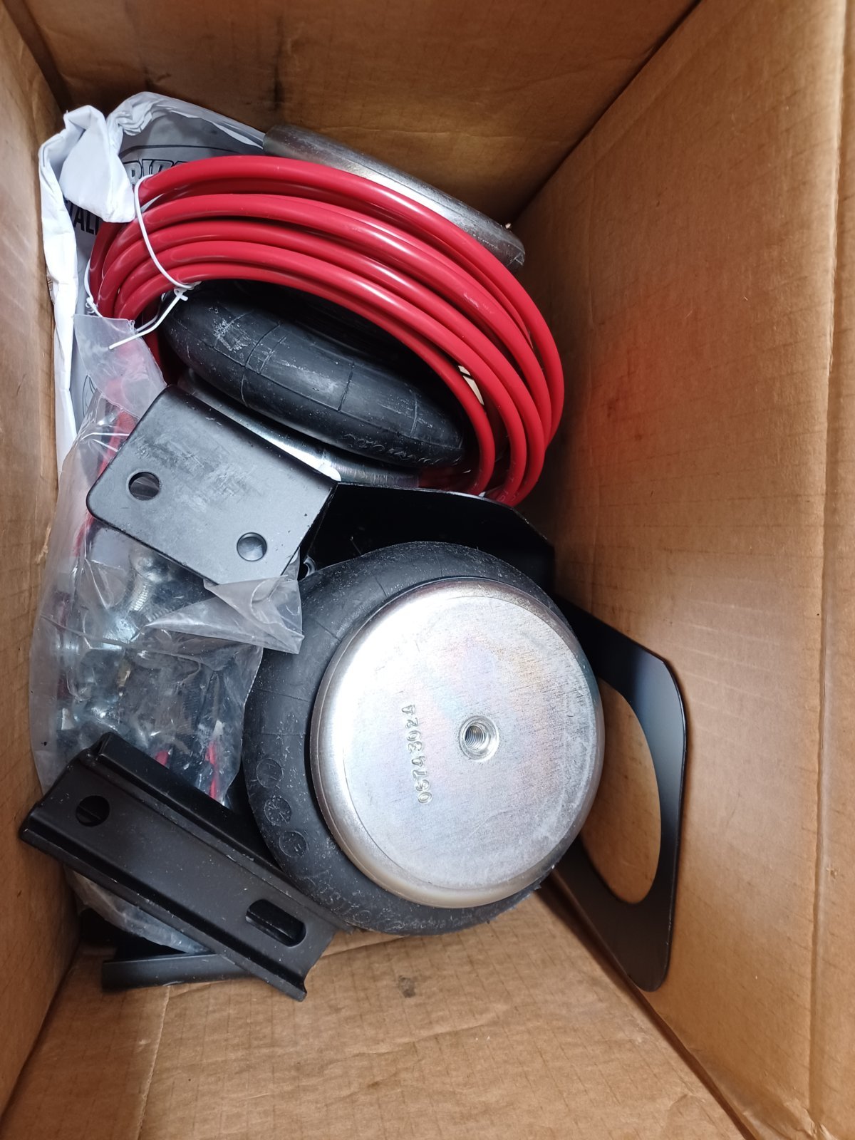

    Here is the jumble of crap Michigan Truck Springs 2cd day shipped to me. Rejected for potential damage, with rubber bellows being slammed by sharp metal edges.
    MTS repackaged and shipped a previously damaged box in a second box sleeve, original contents protections appear to be missing. I went with MTS precisely to avoid the sort of Returned Goods shipments endemic to Amazon and the like.
    I have to assume manufacturer Firestone includes some sort of wrapping and protection on the rubber and plastic components for shipping.
    Can anyone who has bought these confirm that is the case?

    I do not remember as mine were like 10 years ago but I dont think that they would pick any meaningful damage up being packed like that. the rubber is pretty heavy duty.
