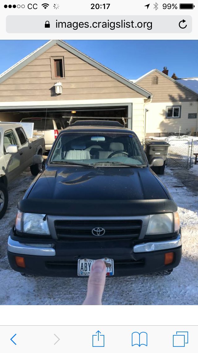

    Found my 99 Tacoma in February 2016 in Butte, MT. 206k, 5spd, 3.4l, with manual hubs
    Nice that it had some recent work done and a brand new set of 31x10.50R15 mud tires on stock rims.

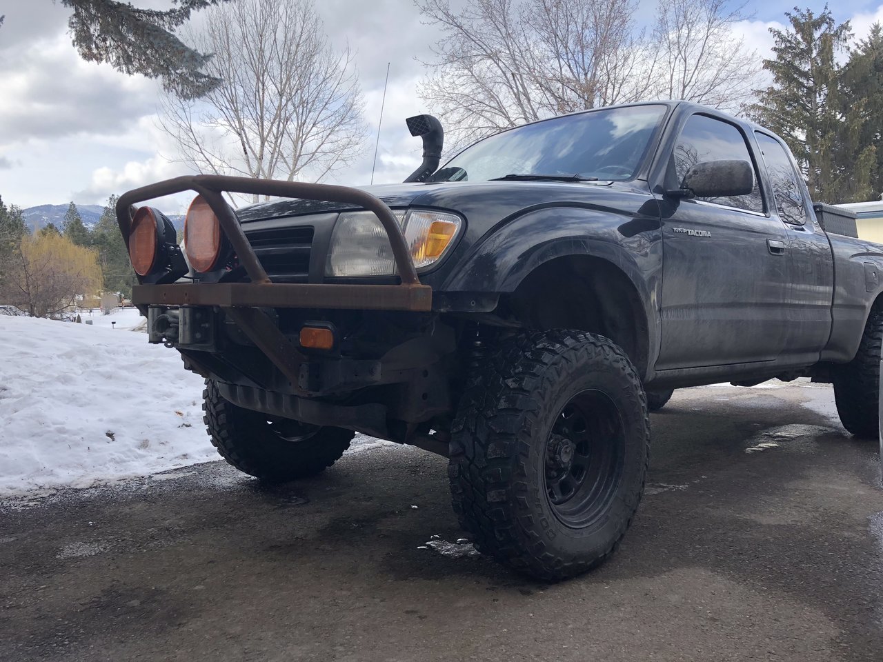

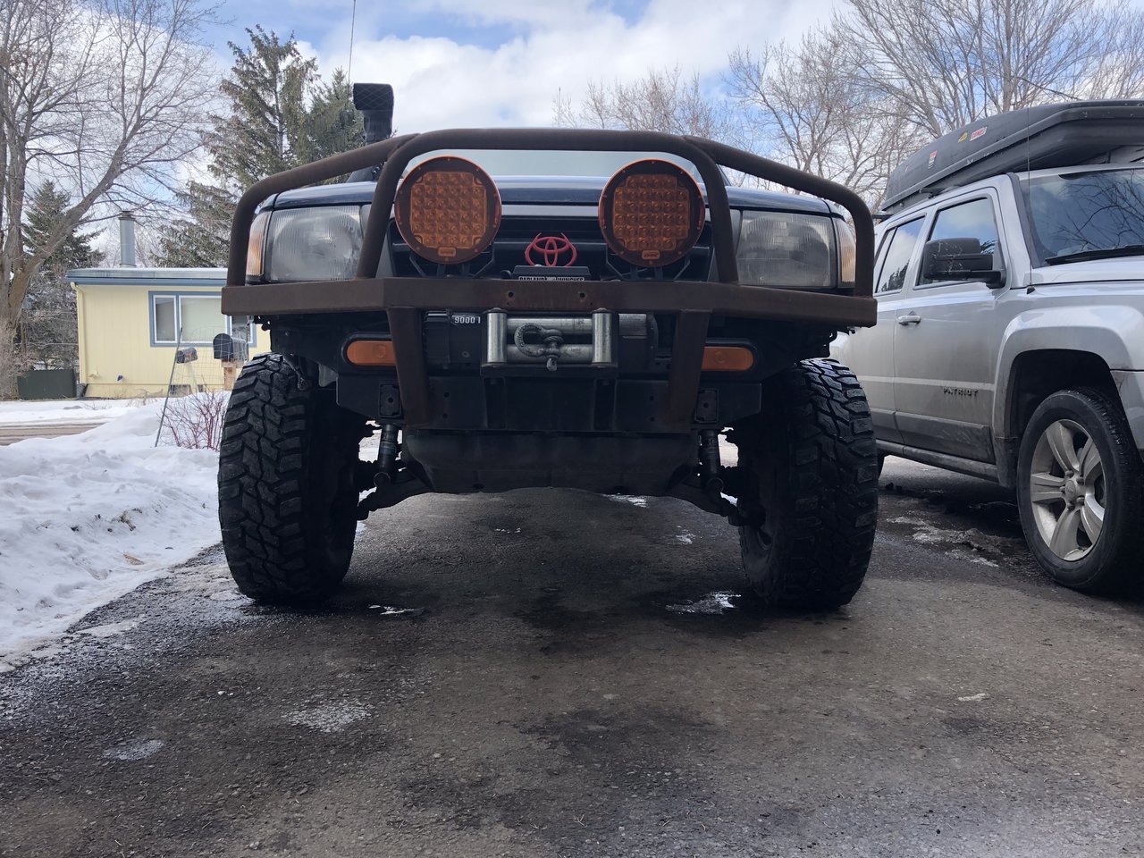

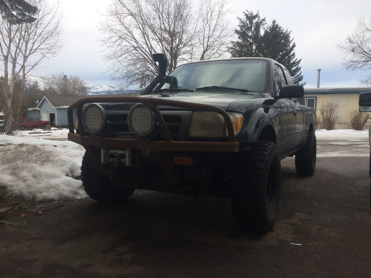

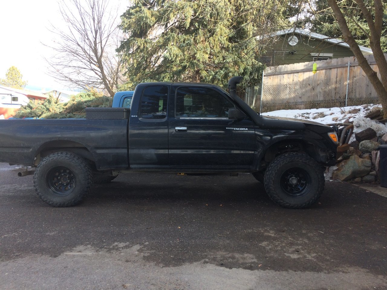

    Winch bumper took several months just welding one bit on at a time. today it looks like this:
    You can also see the Amazon snorkel mod and knock-off 9" LED's. I also swapped the stock wheels for some 3.75 bs 4WP wheels. I discovered during elk season that I couldn't get chains on the front tires because of the clearance issue with the upper ball joint/tire sidewall. So, new wheels with less backspacing fixed that. Nothing better on a iced-over cliffhanger mountain road than a full set of 4 v-bar chains.

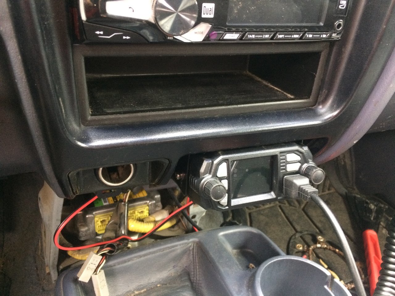

    Got my HAM lisence a few years ago, installed a cheap 25 Baofeng mobile radio in the ashtray location of course. Waiting on the third brakelight antenna mount thread to takeoff so i can finish the install:

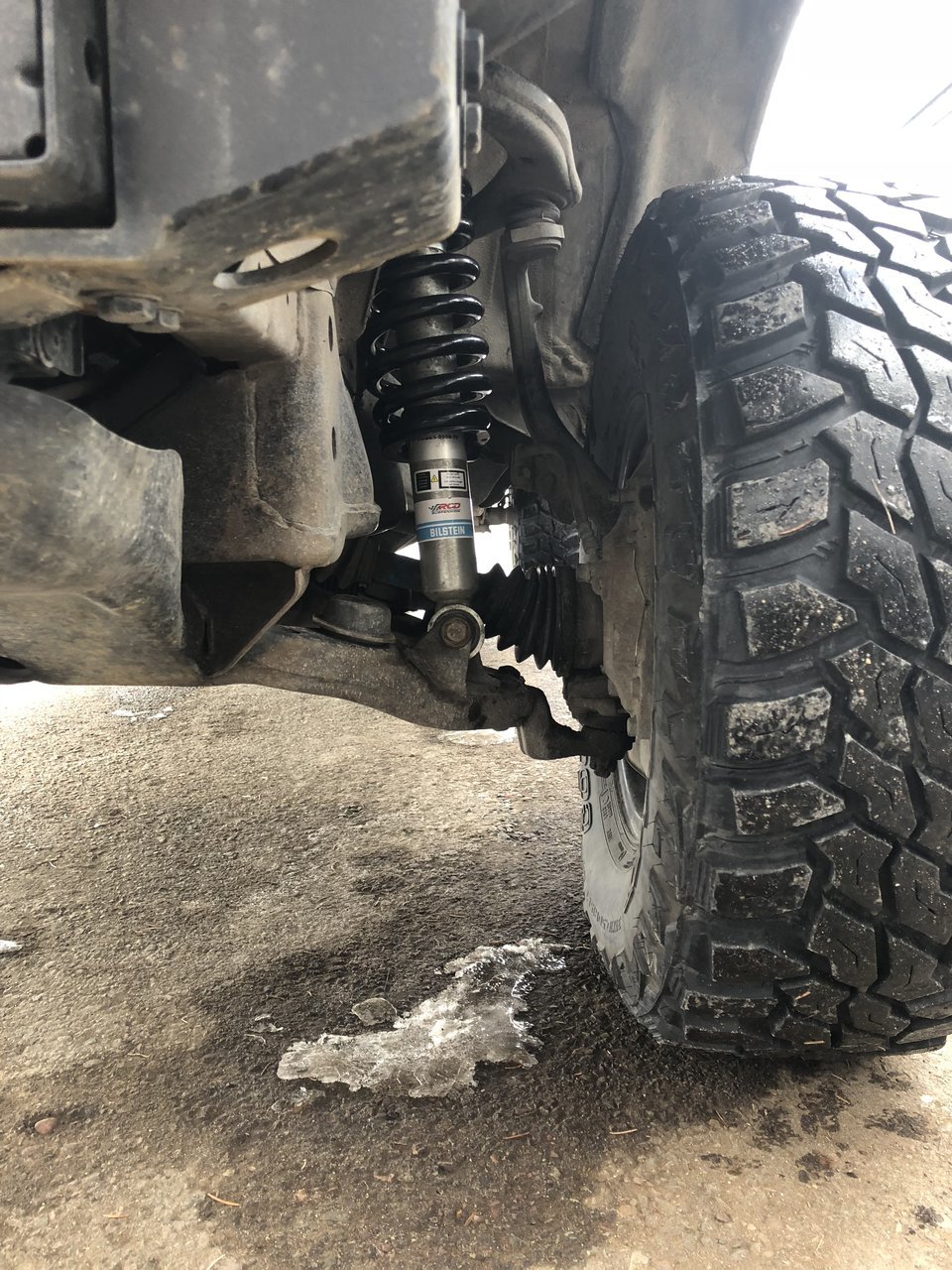

    OME 881's with bilstein 5100's:

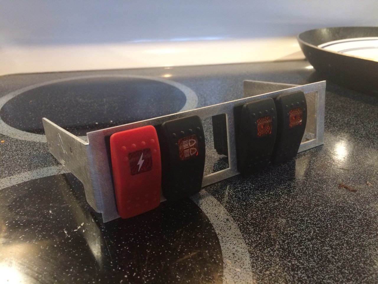

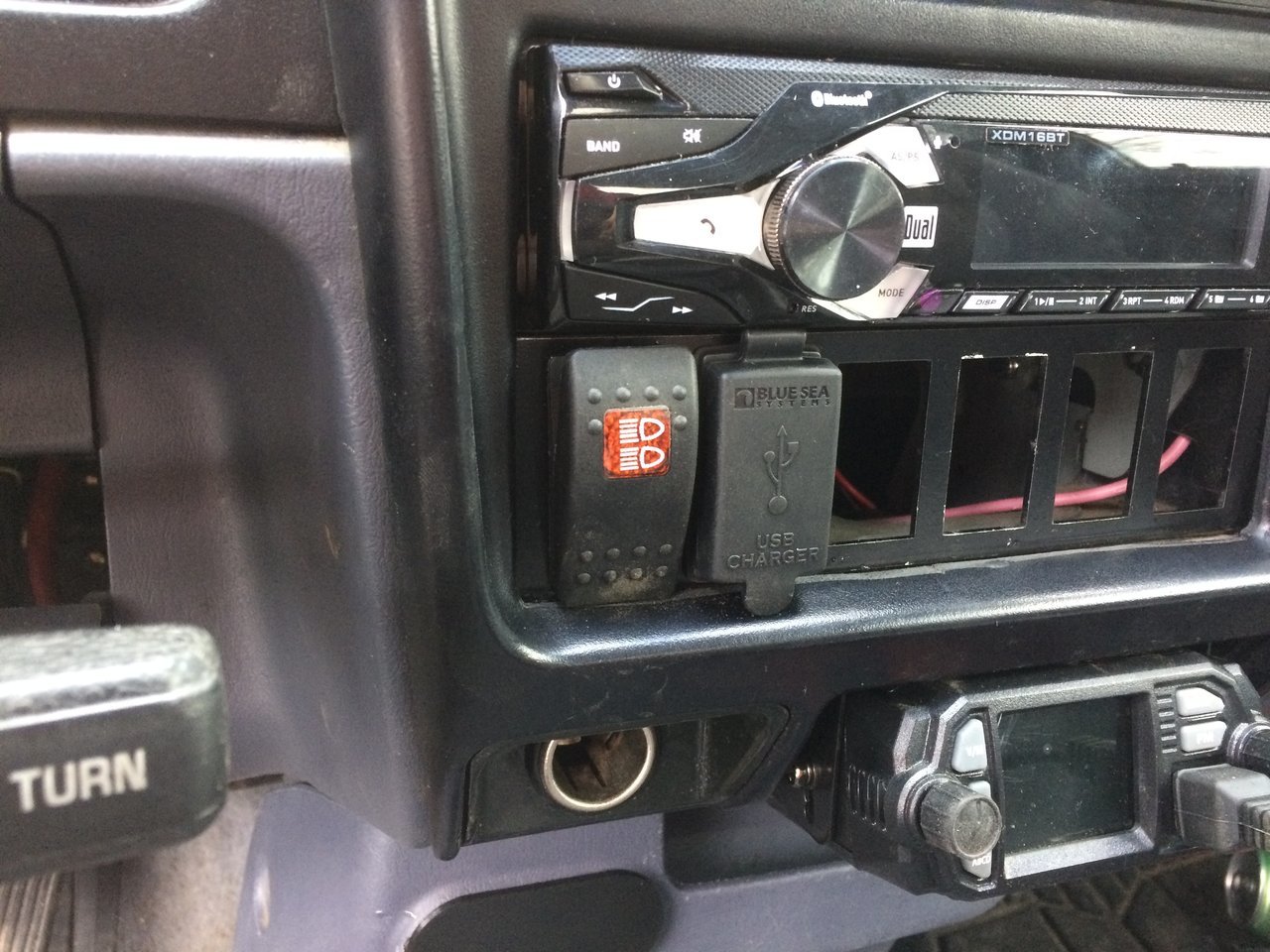

    Paranoid Fabrications DIN switch panel (missing ports will be a USB charger and maybe Blue Sea ACR switch in the future)

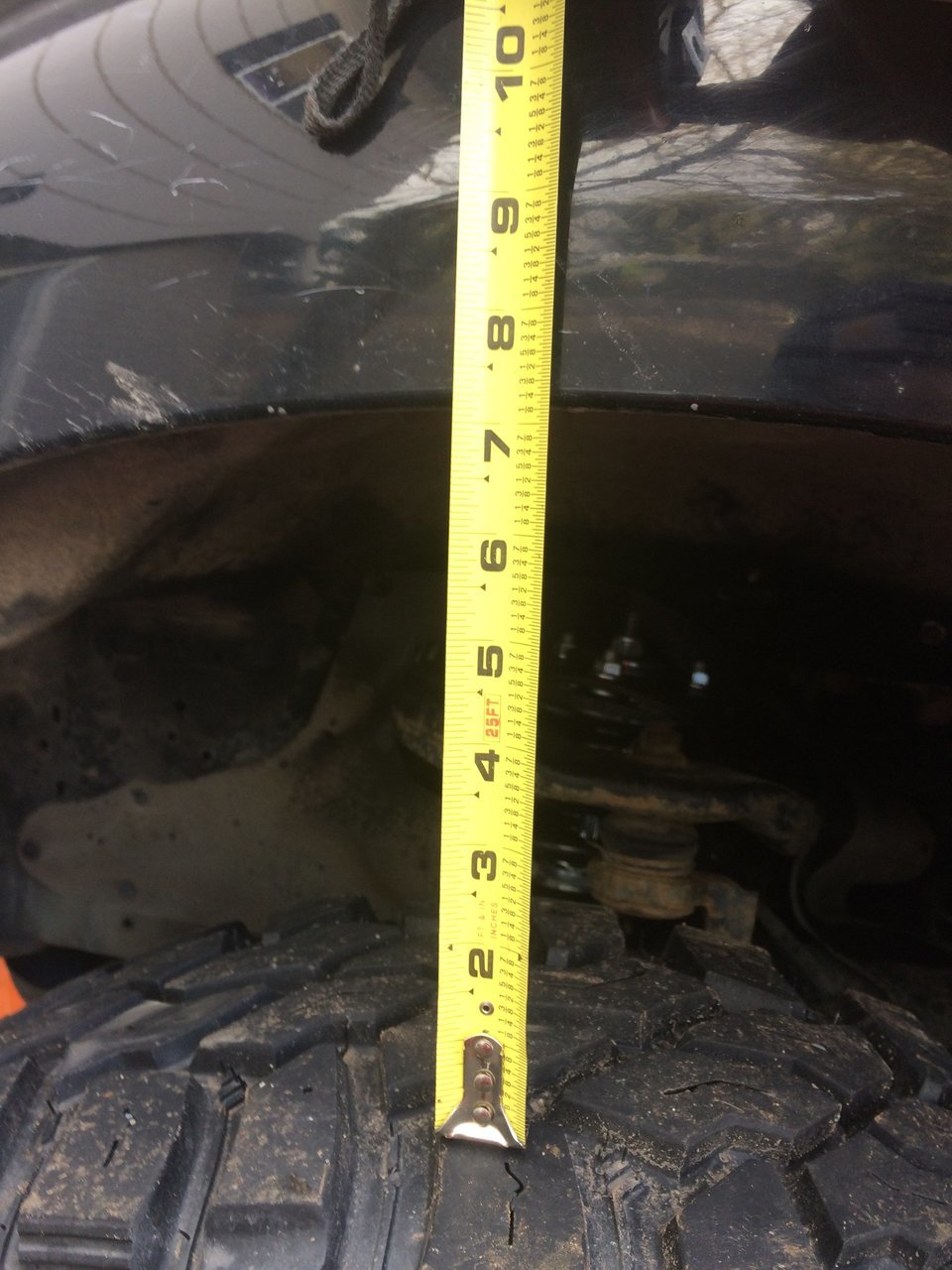

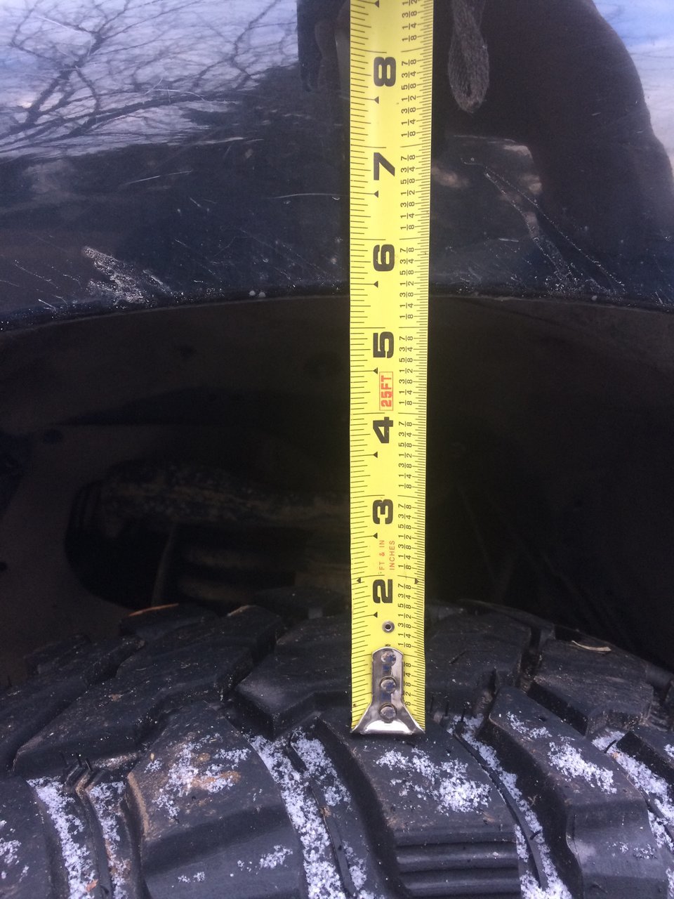

    I installed the 881's with the Bilsteins set at 0". only gained about 1.5" on the pass. side and 2" on the driver side. Not as much as I wanted, but it's pretty level now and the 31's have enough room for now.
    Driver's fender/clearance before:
    After:
    Overall:
    Also installed the Paranoid Fab DIN panel. wired up the switch for my big round LED's and the BlueSea USB charger

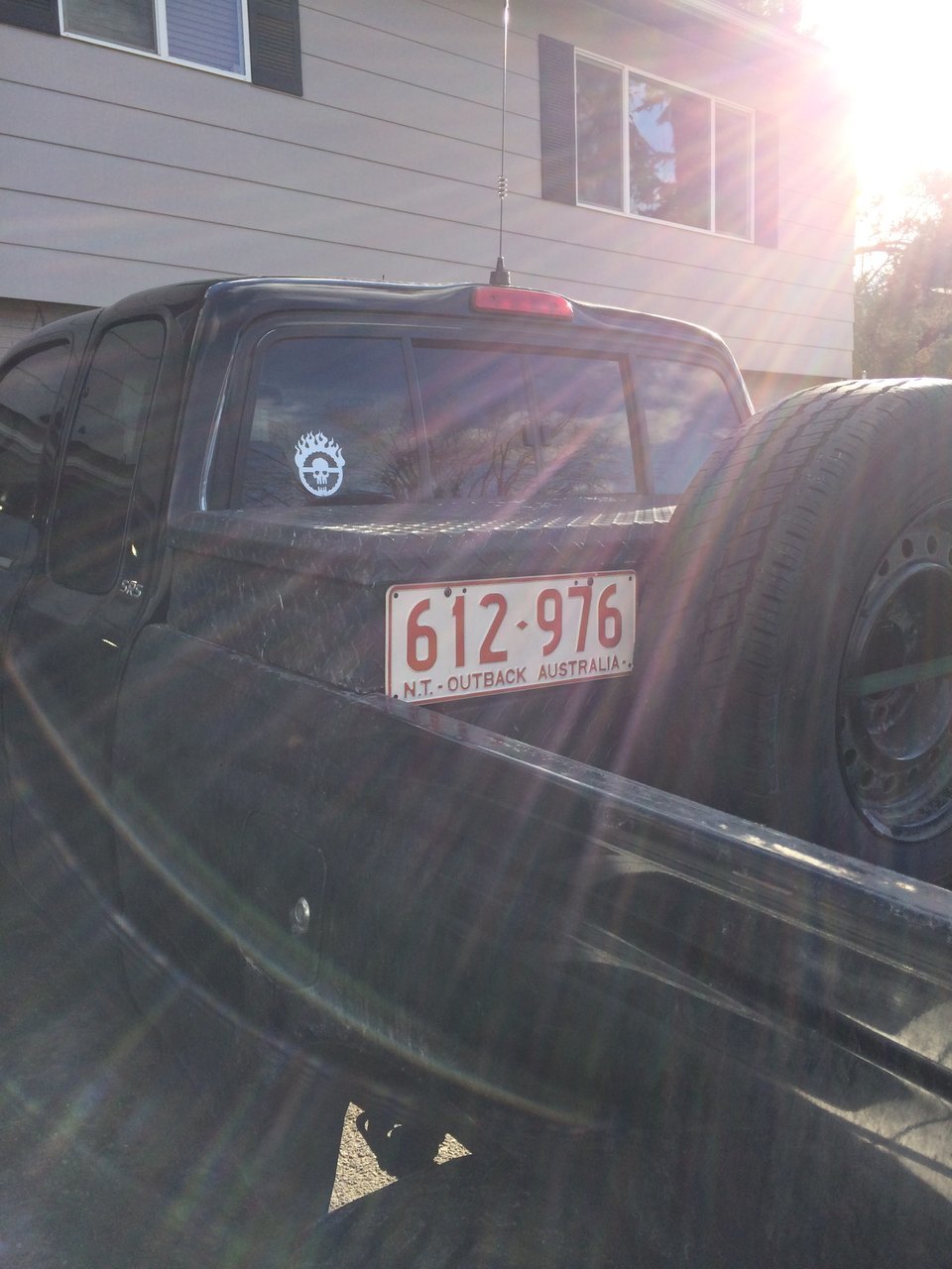

    Accomplished a little work while the weather warmed for a week or so. Now that it's blowing snow and in the teens again....i've been stalled :(
    Mounted my genuine NT Australian plate to my toolbox!

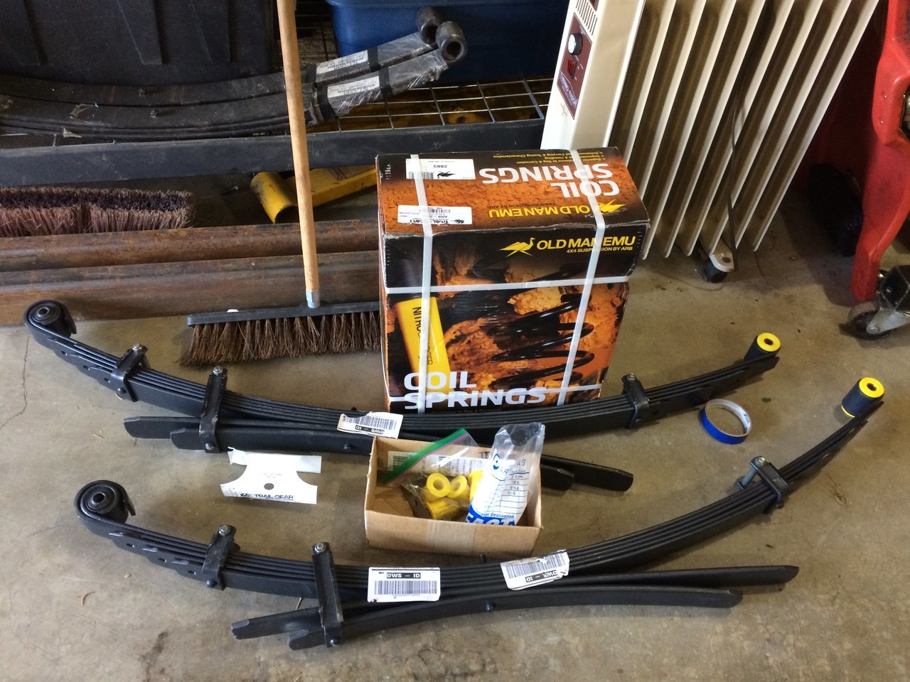

    And have a nice pile of OME stuff waiting to install itself.
    Also scrounged up some used Trail-Gear leaf spring plates to do a u-bolt flip, as well as some weld-on shock mounts from RuffStuff. I'm going to use Dorman u-bolts, PN 35664. 5/8ths diameter, should be plenty.
    Ordered the OME Jeep JK trim packers to try and help the front 883's out too. Just in that mode where you buy parts while the weather is sh*t and wait for warmth to install it all.

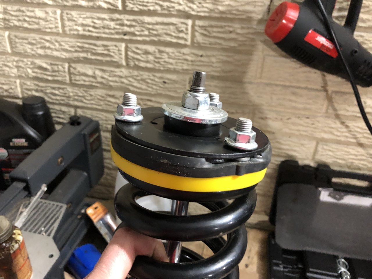

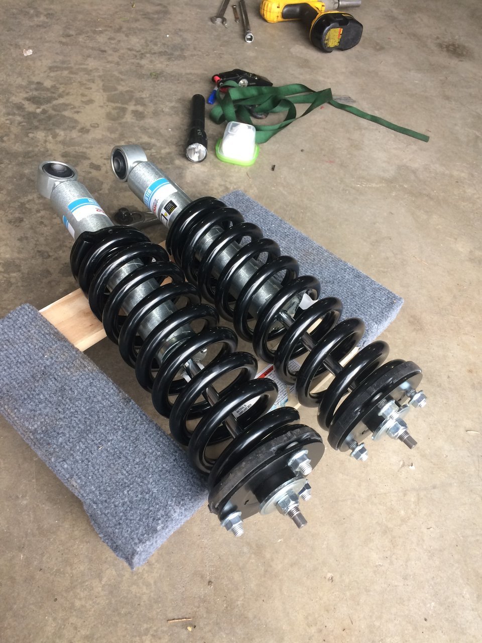

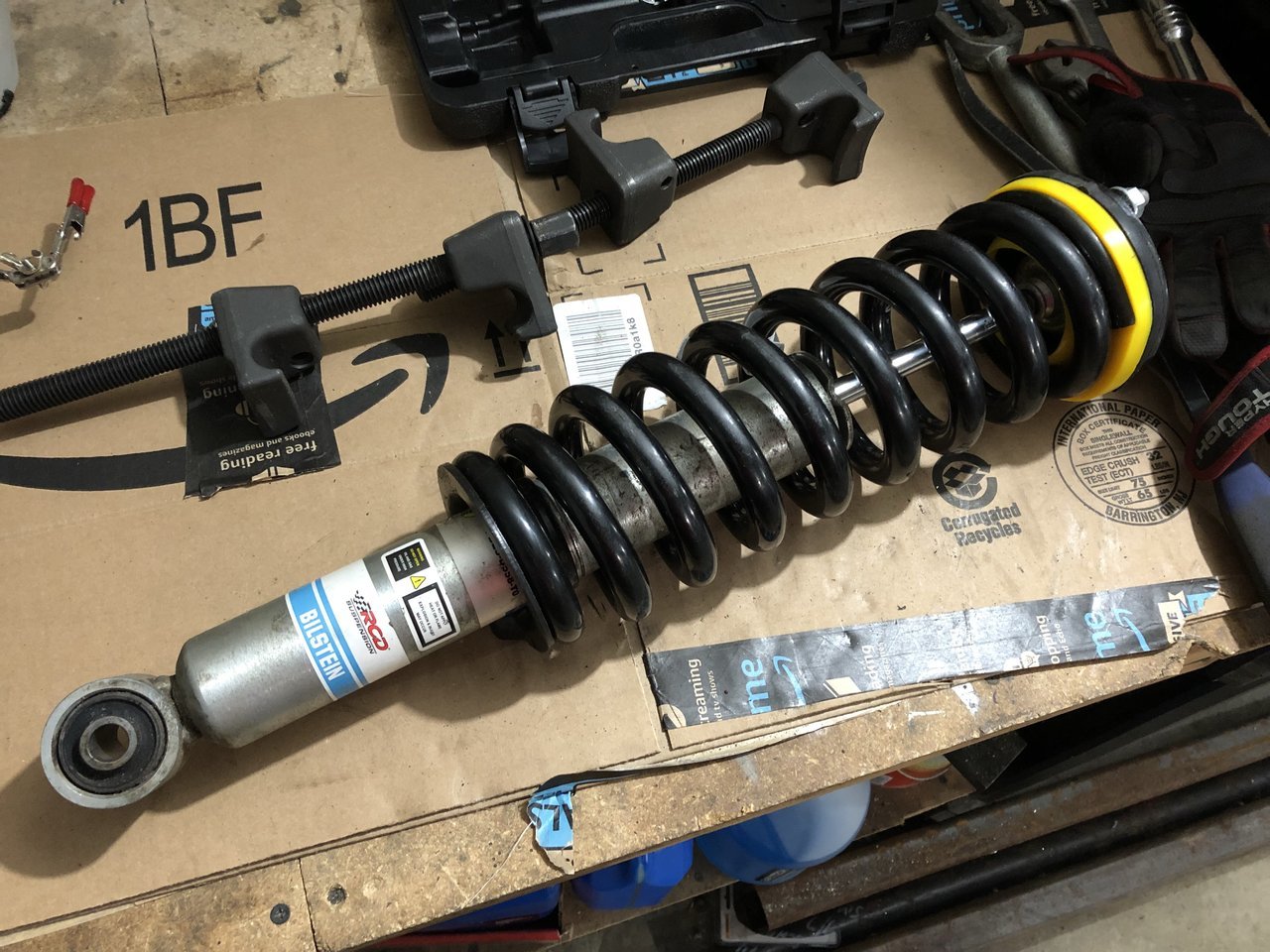

    Reinstalled the sagged stock struts, so i can rebuild the 5100's with the OME 883's. I put one together tonight, and thought the OME JK trim packers would be a good idea since BoxRocket and others have done it. I noticed though that BoxRocket didn't have new top plates with rubber isolaters like I do. I'm wondering if this is a little much having the new rubber isolators with trim packers...thoughts?

    I assembled both with the trim spacers...we will see how much lift it gets. been too cold and snowy for reinstall them or the OME rear springs. Ordered new LBJ's, and been thinking about the JBA Off Road upper a-arms. I like that they can use off the shelf IFS chevy balljoints as a backup

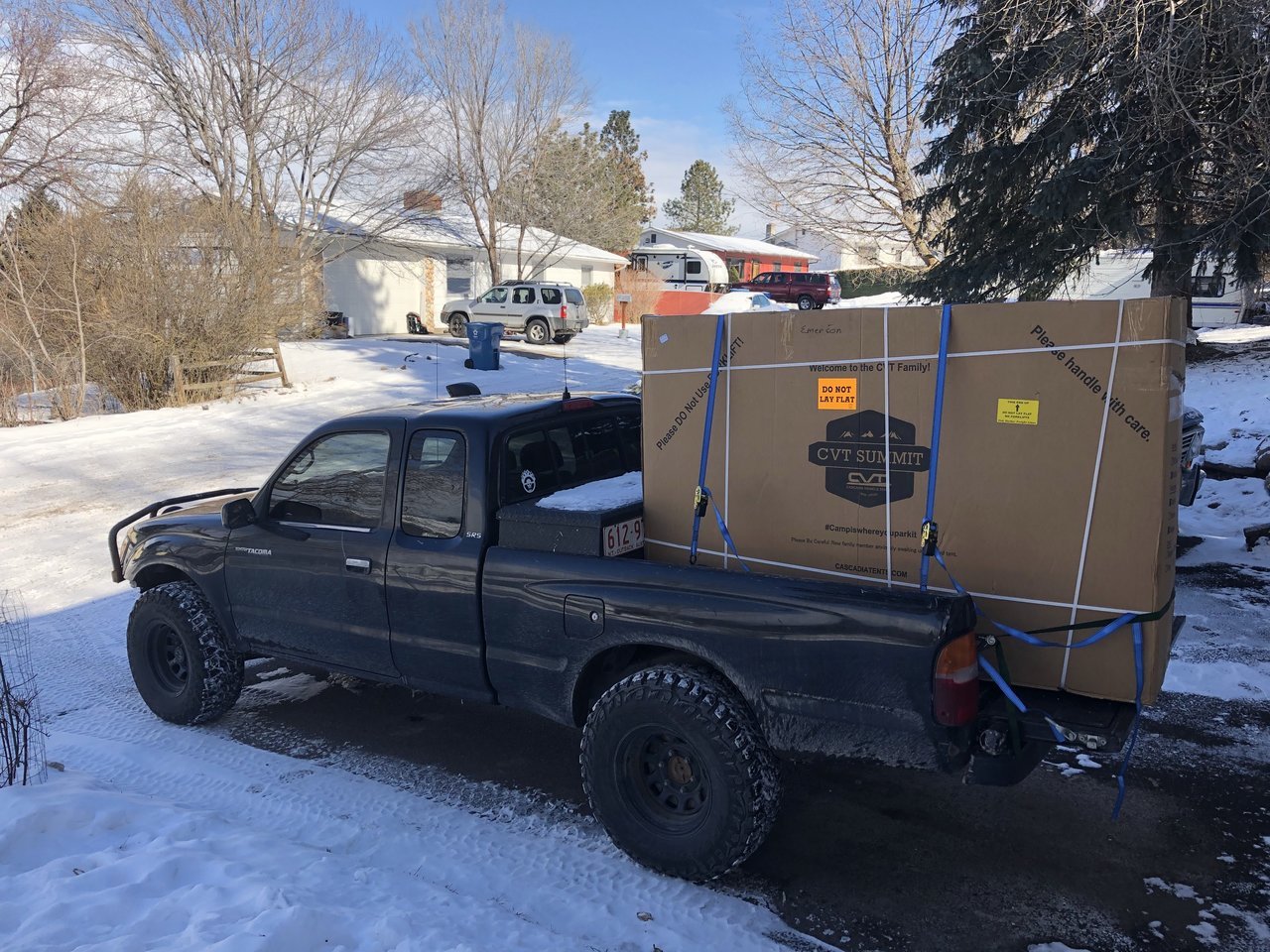

    RTT IS HERE!!!!111!!
    If it wasn't a literal 10° outside, I'd be getting my OME suspension on too!

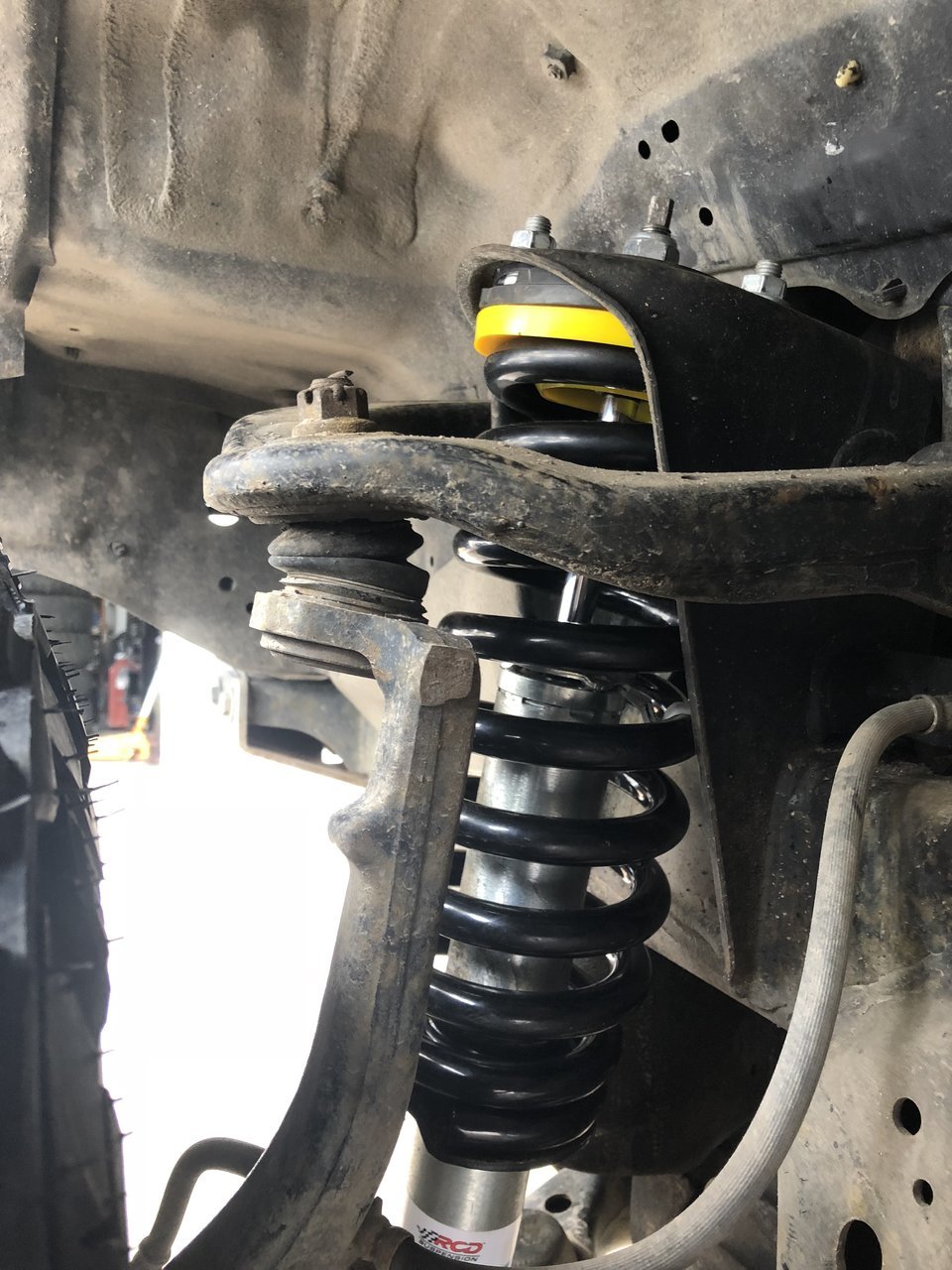

    Mounted my new 883's/5100 combo on the front, definitely like this better. My rear springs aren't on yet, so it has a pretty good SoCal bro dezert stance now.
    Also did the Trail Gear diff drop (i know)
    Upper balljoint angle isn't too bad....hopefully after I sell some tires and other parts i can buy the JBA upper a-arms too.

    Does the Upper balljoint angle above look like I should get the JBA arms soon? Anyone?

    Decided not to get the JBA upper arms yet. Sold a set of 37's that i'd been saving for awhile to buy a CS144 alternator, second battery, other junk. I did get my OME rear springs installed today, finally. both the shackle bolts and the front spring eye bolts were completely frozen in place and had to be hacked out with Mr. Angle Grinder. Skinny death wheel for the win.
