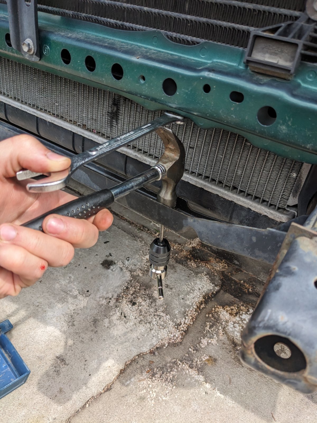

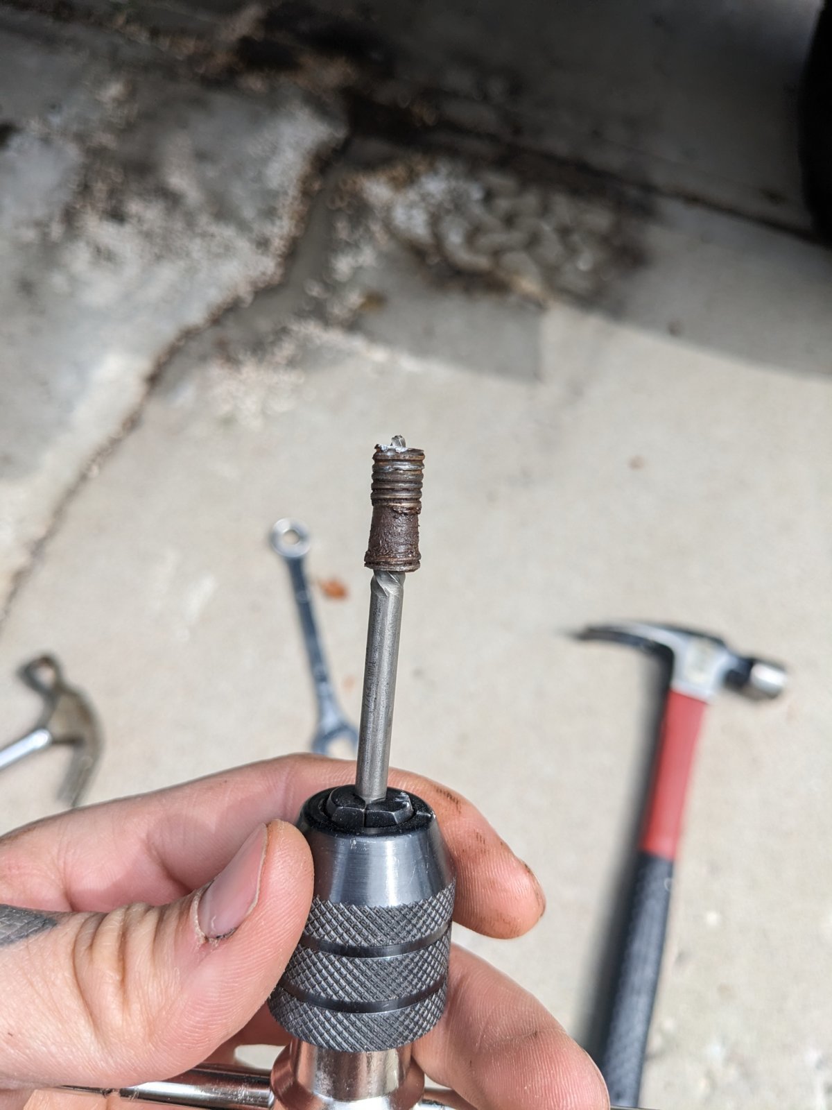

    Well it took me a while to get around to it but I got the bolt out! Big thanks to Sklar for mentioning how it needed pressure to get the bolt to catch. I ended up using a janky setup of a wrench and hammer to make a 1-handed lever to apply pressure to the top of the bolt while using my other hand to turn the bolt extractor. Check the photos to see it in all its glory.
    Now I'm off to grab a tap and rechase the threads on all of the holes, and remount my skid plate.
