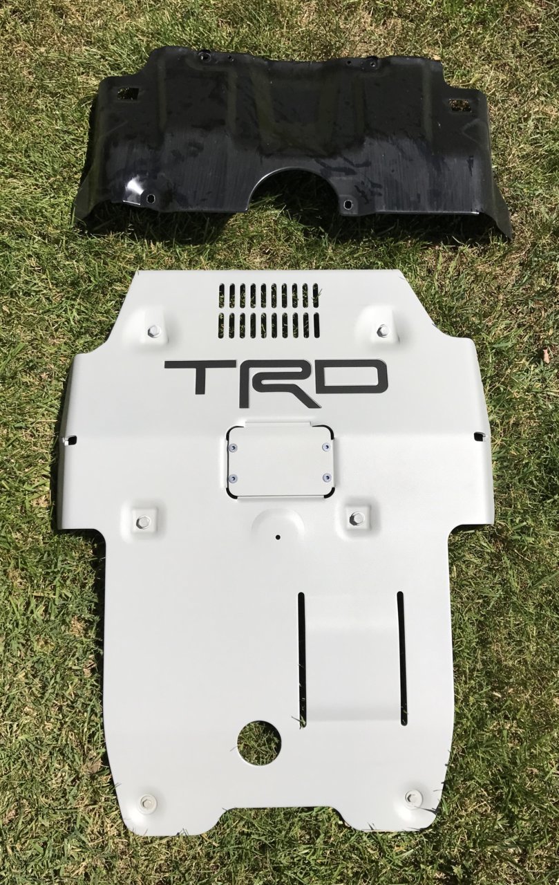

    OEM skid plate or TRD skid plate? M12s are for the TRD skid plate correct?

    No they do not. At least no all of them. At least one position, I believe the front ones, you have to remove the front bracket bolts and replace them with the included bolts. They were m12 1.25 bolts

    Also, You have a 2 piece skid plate on your OR

    Is the TRD plate worth getting as an upgrade? Taking the TRD sport under spoiler off, then the skid plate seems like a lot of extra work and more broken/rusted bolts vs the TRD plate "hole". Live in Mass, so rust/salt is a pain....
