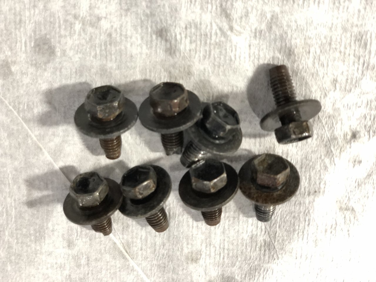

    I just took off my skid plates for the first time and I noticed there were different size bolts and shapes...
    One bolt is pointed and has a washer and came off with 1/2" socket...the other bolt is flat and is a flange bolt and came off with a 12 or 13 MM socket
    Since this is my first time, I never knew what the original bolts looked like...Im assuming that the flat ones are original because they are metric...but I also wondered if the pointed ones were original and meant for the front 3 bolt positions on the front pan near the radiator
    Enclosing pictures if anyone knows
    This is off a 2003 Tacoma TRD 4x4
    TIA

    Just get some all matching 8mm x 1.25 metric bolts. Grade 8.8 is completely fine- before you break an 8.8 bolt you'll have broken a lot of other stuff down there. Since it's japanese a 12mm head would be more appropriate but I replaced all mine with 13mm flange headed bolts.

    none those are it. i'll look at the part when i get the chance

    I like the flange bolts so I dont have to worry about washers. Grade 8.8, dont worry about corrosion its gonna happen eventually.

    Just take those bolts to your nearest Ace Hardeware, and match the thread and pitch. Ask someone for help if you need to, but yeah, there are 2 different sizes iirc, the 3 on the front, then 4 more that bolt to the frame and 2 more that bolt the 2 pieces together.
    As long as you match the thread size and pitch, and the general length, that’s all that matters. And washers.

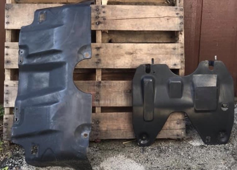

    So what condition were the skid plates in?
  9. Sep 8, 2019 at 8:48 AM
    mastaplanna
    mastaplanna [OP] Member
    Sep 7, 2019
    #304596
    18
    About the same as that...the rear one has a hole in it too just like yours and the front one was in a bit of better shape...I'll snap some pics when I get a second

    Great. What did you do? Replace them??
    I found some good used ones on ebay. I Painted them and I'm all set.

    Thanks. Watch ebay and craigslist. I got the front, Engine and gastank plates for $190 shipping included. Really clean!!

    I have 3 different types now that I took a closer look
    I'm thinking they should be the 8T bolts...at least thats what I have on the '14 4Runner...but this Tacoma is '03 so not sure yet what they used way back in the day :)

    Went to my local Toyota.
    Racine Toyota.
    Showed him my bolts.
    He ordered 4.
    $2.87 each.
    Picking up Monday AM. Hope they match. If they do I’ll be getting 4 more to replace the rear skid bolts.
    I’ll post the part #monday

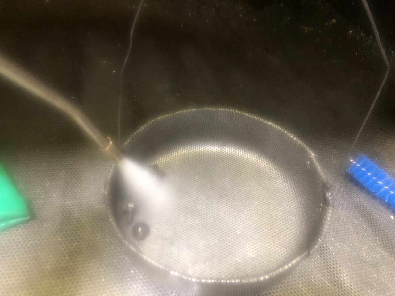

    97411BCF-0D59-4FAF-A745-158D16EDCBAA.jpg The original set that I gave a quick mineral spirits bathC1601D0C-A523-43D1-8D3E-C11F7D1B8743.jpg
    I then brushed some grease in the bolt holes and on the bolt thread and washers.
    $20 on fb marketplace for
    2 piece 2016 TRD Off-road skid . Fits on my ‘17
    A set of bolts were included with used skid I bought from a Trd off-road on Facebook marketplace.
    Finished product came out ok
