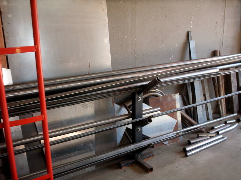

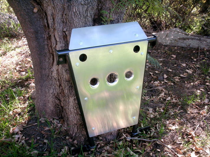

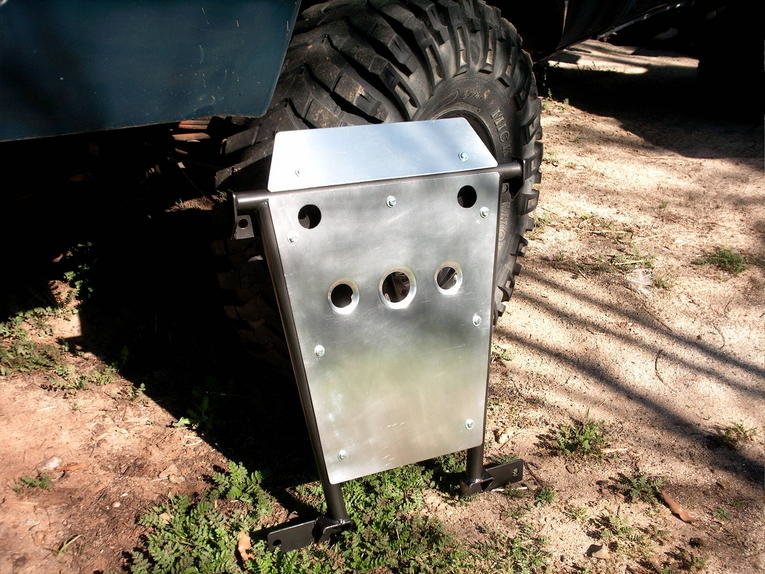

    I used steel and aluminum from this rack...
    built a metal frame that replaces those 2 factory braces...
    made a couple aluminum plates with some holes here and there...
    and BLAM! bolt on Baja style skid plate...

    Thanks for the compliments guys! The one above is going to a gal in HI. This one went to Puerto Rico a year or 2 ago. The aluminum plate can be replaced by a weld in steel plate too for more abuse. But I just love the look the aluminum gives.
    2nd gen Taco
    1st gen Taco

    For the 1st gen install, is that an aftermarket sway bar on the front? Or is the skid plate compatible with the stock sway bar?
