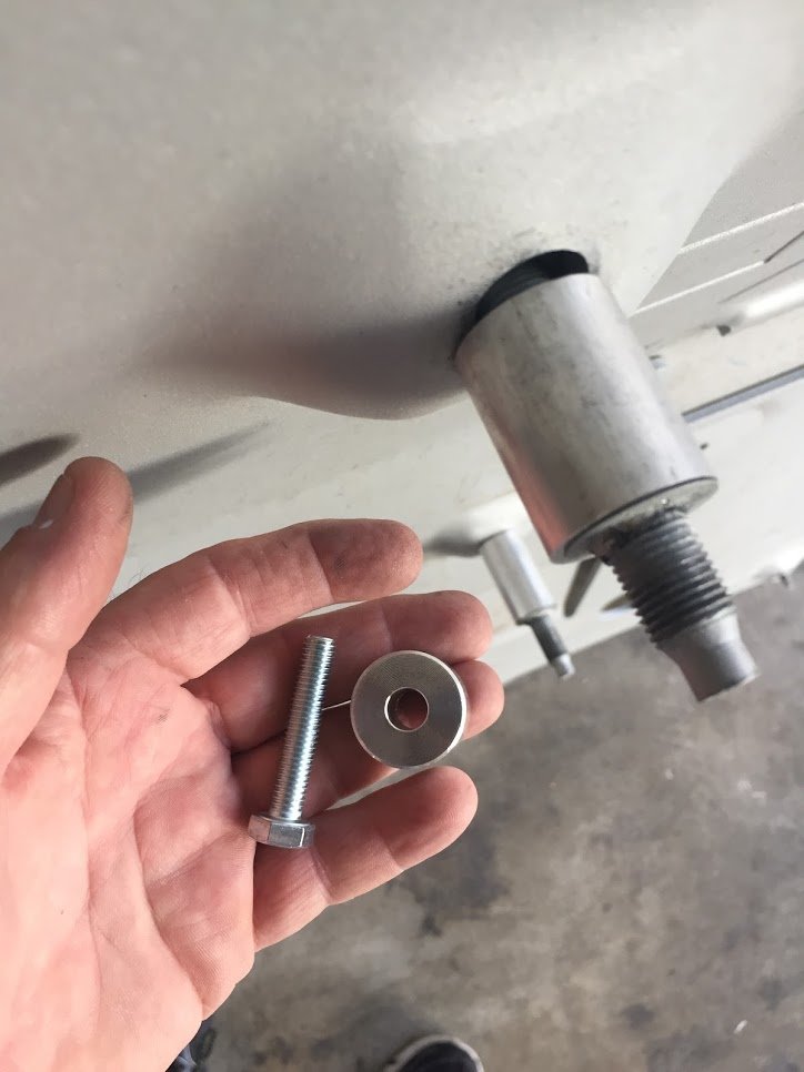

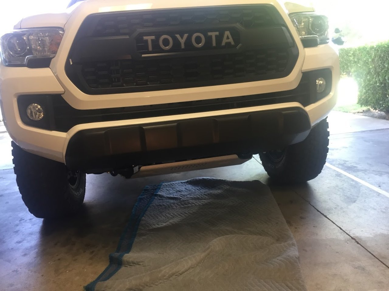

    I posted a thread a year or so ago of the spacers and bolts required I purchased at McMaster Carr. I remember I used shorter spacers in the front so it sloped down towards the back.
    RZ Rob

    The four larger front skid plate bolts are M12x1.25 I think. Not sure about length, but you can measure them and add the spacer thickness.
    Toyota doesn't use special bolts per say. They use JIS Automotive fine pitch, so typically they'll be the following.
    16mm x 1.50
    14mm x 1.50
    12mm x 1.25
    10mm x 1.25
    8mm x 1.25
    6mm x 1.00
    JIS heads are not the same as the DIN and ANSI that you may find in a hardware store (although some better will have JIS). For example an M8 JIS uses a 12mm wrench and while DIN/ANSI is 13mm. Nice thing about using the right bolt is you only have to carry 8/10/12/14/17/19mm tools to fit most bolts on your truck.
