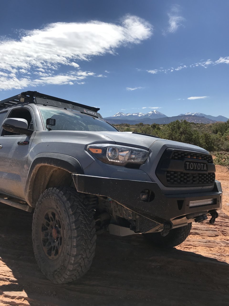

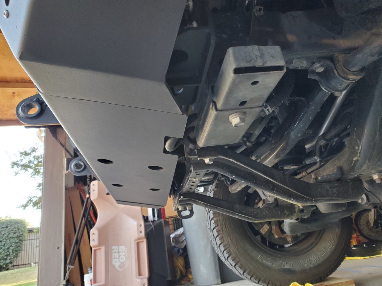

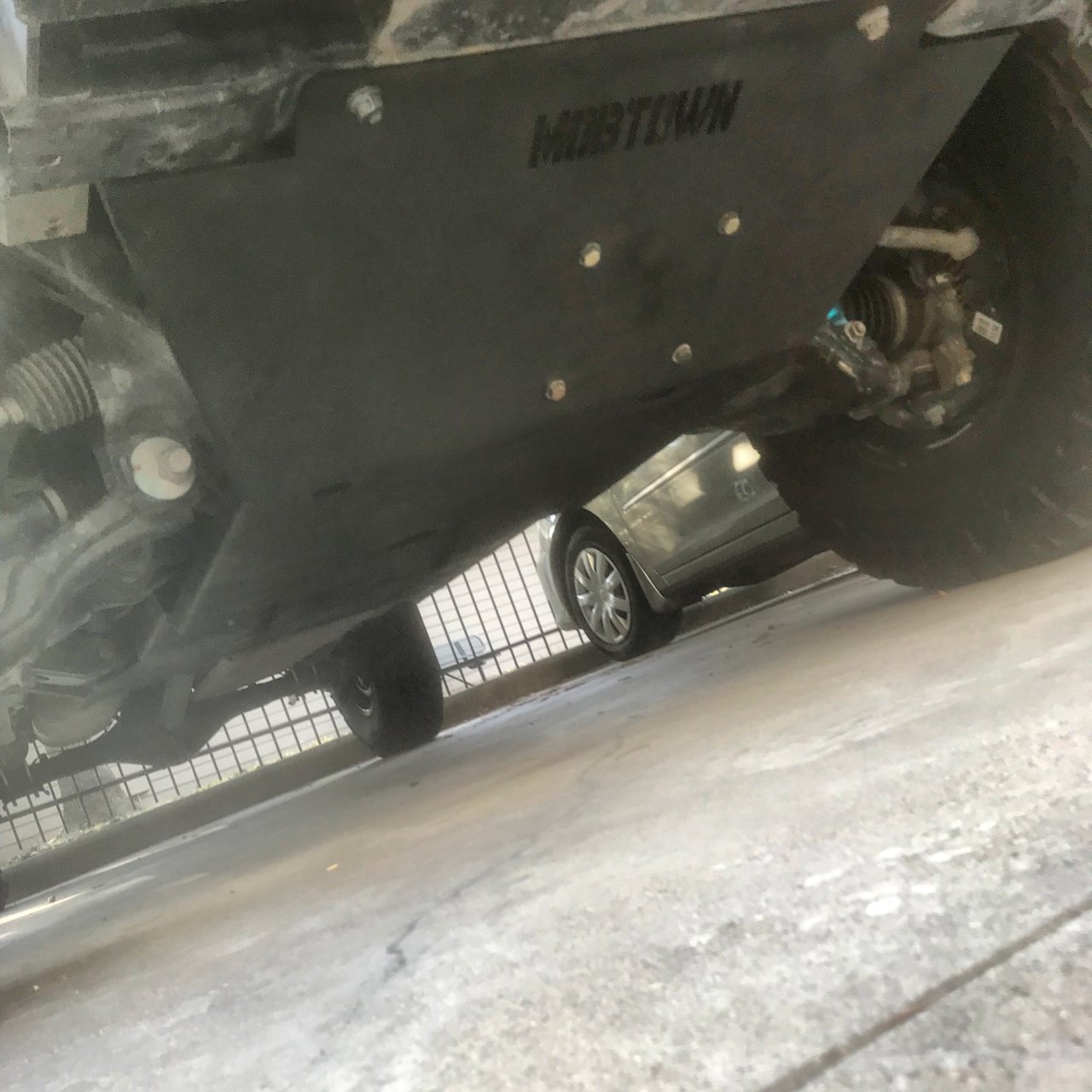

    Mine laid over the end of the bumper and didn't sit flat (1st pic). I went with Mobtown in my new one and it's much better. Never had a problem with it cocked though

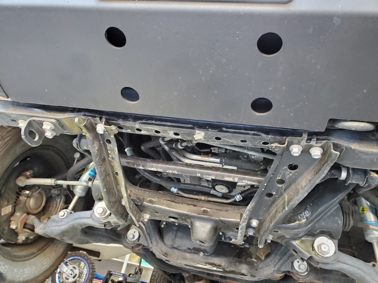

    Pics of the lower part of my DV8 bumper.
    I'll test fit the TRD skid plate and see if it works, otherwise I just want to verify the RCI skid plate will fit without interference with the bumper...
    Only see 2 small tube coolers and another small cooler in front of the radiator, still don't know if my truck takes 6.1 or 6.2 quarts of oil.
