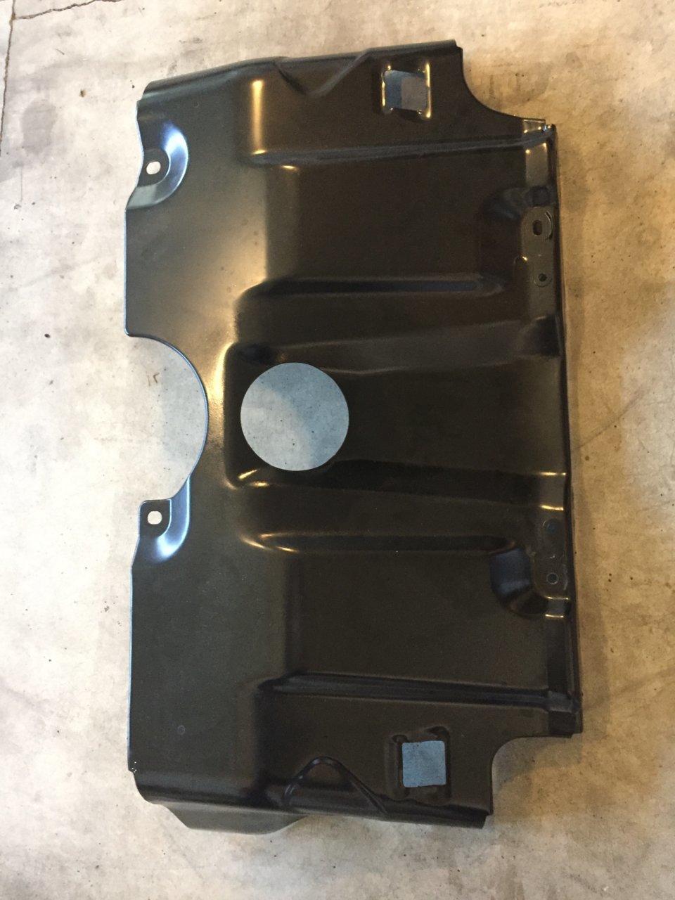

    I am just wondering if anyone has come up with a better idea on how to change our oil on our 3.5 engines besides dropping the skid plate everytime? I know i put anti seize on the bolts so they do not eventually seize up and then I cannot remove the plate but just curious if anyone came up with a better way to change our oil.

    Cut a hole in the factory skid.

    I agree that it does not take very long to drop the skid plate, but up here in the world of salt and brine it is going to come a day where the skid plate bolts will eventually seize and then the only way to change oil will be to cut a hole in the plate to change it. Or I guess find a after market plate or the TRD one.
    Thank you for the info.

    Seen one member here, he cut an access hole in stock plate. If you dont go off road that much, might not be a bad idea for you.

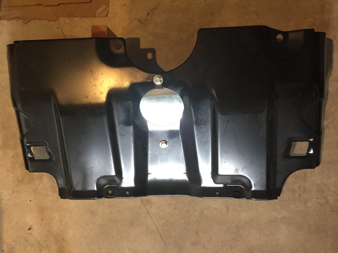

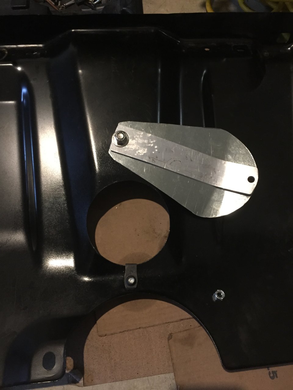

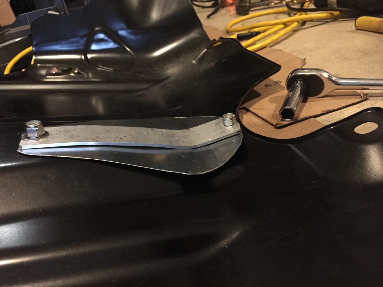

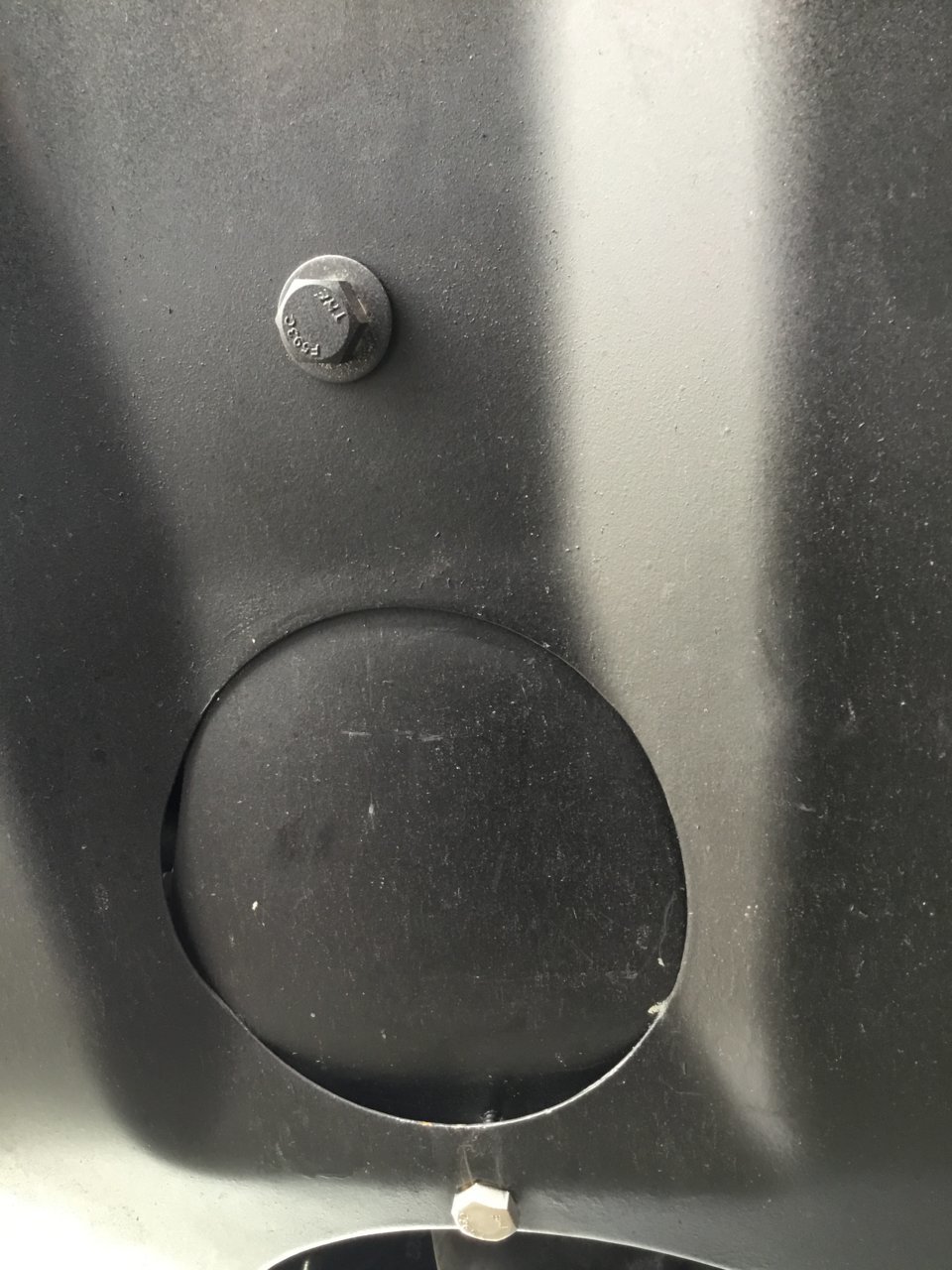

    I’ve been leaving the second bolt off. It doesn’t move or rattle without it.
    8CB7D5BA-3C50-4724-90D7-BE9BC71E9031.jpg 73162636-0B29-4EBD-9FAD-66820CF34608.jpg 5FCCBC74-AD05-432C-A94F-1C1BBA8D45FF.jpg 09FC15FA-AC61-428C-8BAA-2ED8E2218FD2.jpg 6F9B21B8-1082-4A69-885C-F4AEDAA00592.jpg

    That sounds like a great idea. I will do that. Thank you very much for the pictures and the idea. Thanks!
