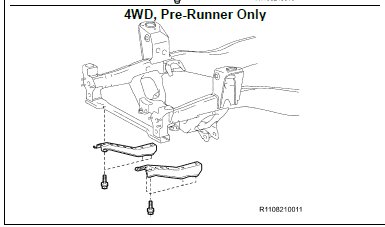

    So, I was waiting on new skid plate bolts (accidentally threw out my original bolts). While I was waiting I wanted to tap the holes to clean up the threads before mounting my skid plates. I grabbed the wrong size tap, 12x1.75 instead of 12x1.25, tapped all seven bolt holes. The next day my new bolts arrived and I knew I messed up. I went on Amazon, ordered a 12x1.25 tap, a Heli-coil set sized 12x1.25 and a 31/64 drill bit (correct size for Heli-coil kit).
    I think I have three options:
    Re-tap the holes to the correct 12x1.25 and use the correct bolts from Toyota.
    Find 12x.1.75 bolts and use those (I'm not sure on the quality of the threads in the frame).
    Use the Heli-coil kit and use the correct bolts from Toyota?
    (my fourth option is that Toyota finds a hole when they do the frame spray and I get a new frame)
    I got the drill bit today, the rest of the stuff should be here Monday or Tuesday.
    Can I mount a skid plate using Heli-coil? I've used Heli-coil in the past and haven't had any issues.
    these are the bolts that I tapped for:

    A nut/bolt isn't an option because how the frame is constructed.

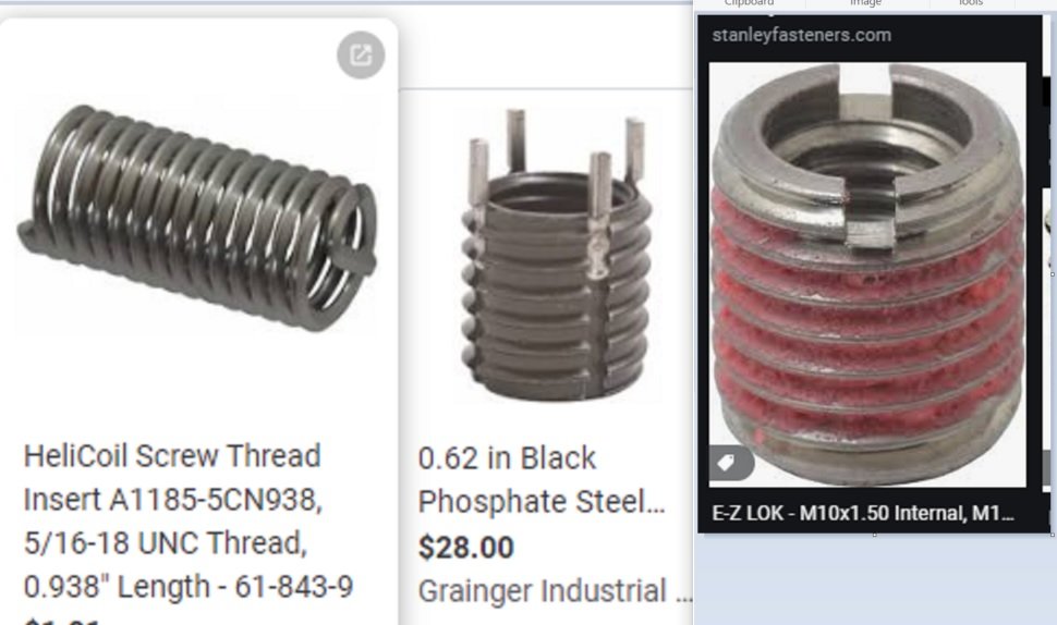

    As a general rule, I like to avoid Heli coils. I always advocate the use of a threaded insert. The Heli coil is section of wound up steel like a spring, were as the threaded insert is actually a "slug" of steel that is treaded inside and out. They can also be found with locking tabs that get driven in to prevent the insert from backing out, as well as pre applied thread locker. They cost a bit more up front to get the kit. But worth it, in my option for the piece of mind of strength and longevity.
