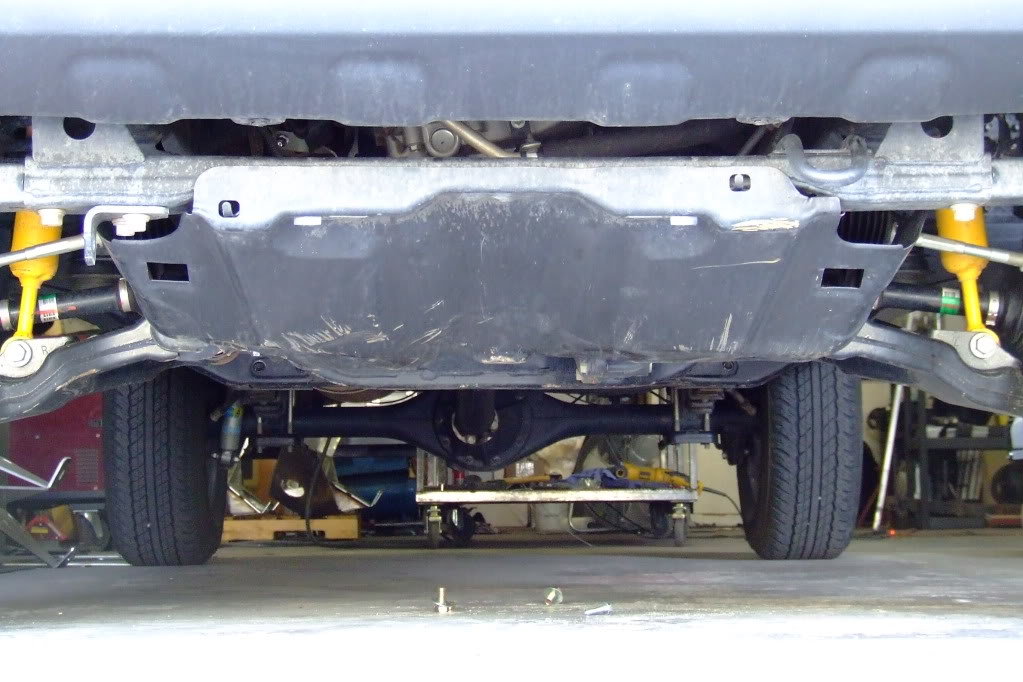

    Thats just it, I don't have the existing skid nor its mounting brackets or anything for reference. What would be nice is if someone could post a picture of their front end and show me where the front mounts but like I said, I think something has been changed/modded on my front end.

    image from google, looks like the oem mounts to frame. or the two washers on the tabs pointed inward. if that, swap the sides....they might have mounted them on wrong sides.
