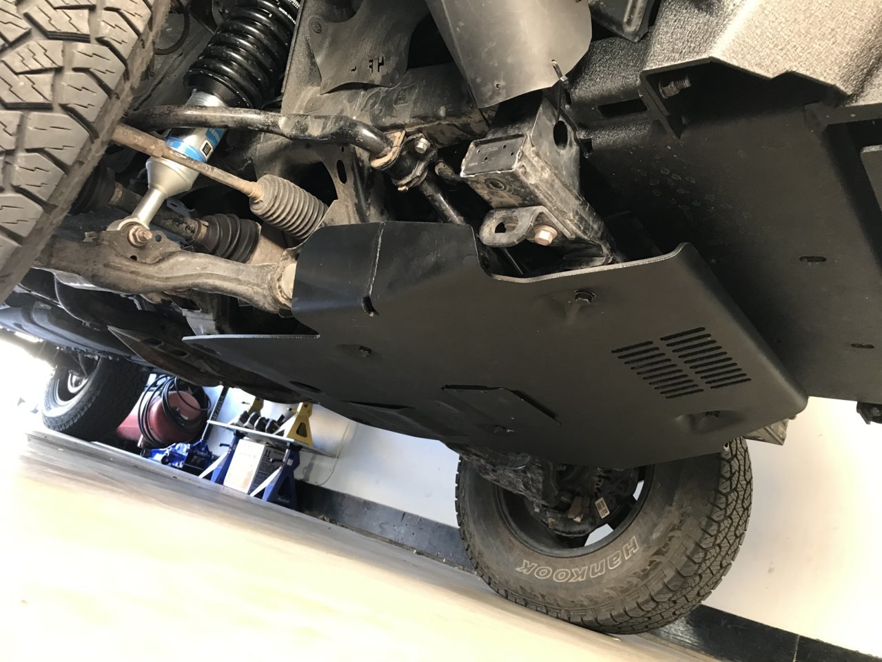

    TRD knockoff for the weekend warrior. Tried and True.

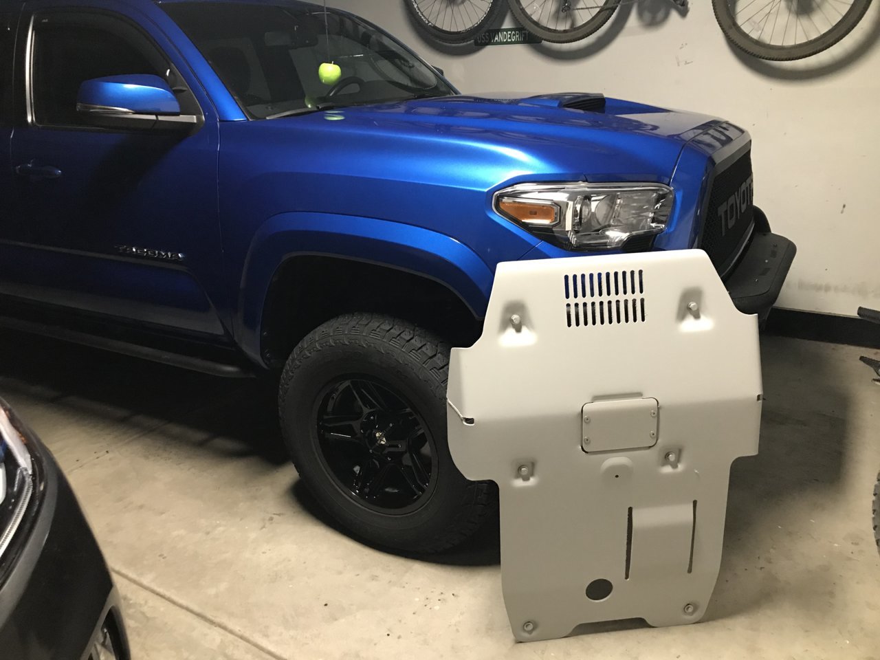

    Black paint with primer and it's ready for an unexpected bump or two.
