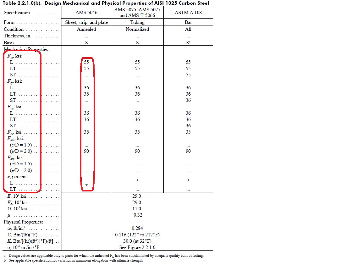

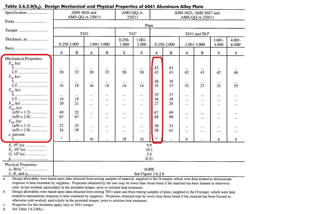

    What kind of steel? There is alot more to consider than just tensile strength, but here is the data I see for typical 1025 steel. A36 steel is similar, perhaps a bit higher
    Ftu.
    1025 steel, 6061-T6
    Ftu 55 ksi 42 ksi
    Fty 36 ksi 35 ksi
    So yield strength is almost identical (engineering offset yield stress)
    Typical mild steel will have a bit higher ultimate strength (ultimate engineering stress)
    Steel will have much higher elongation at ultimate
    Aluminum will have higher deflection at yield
