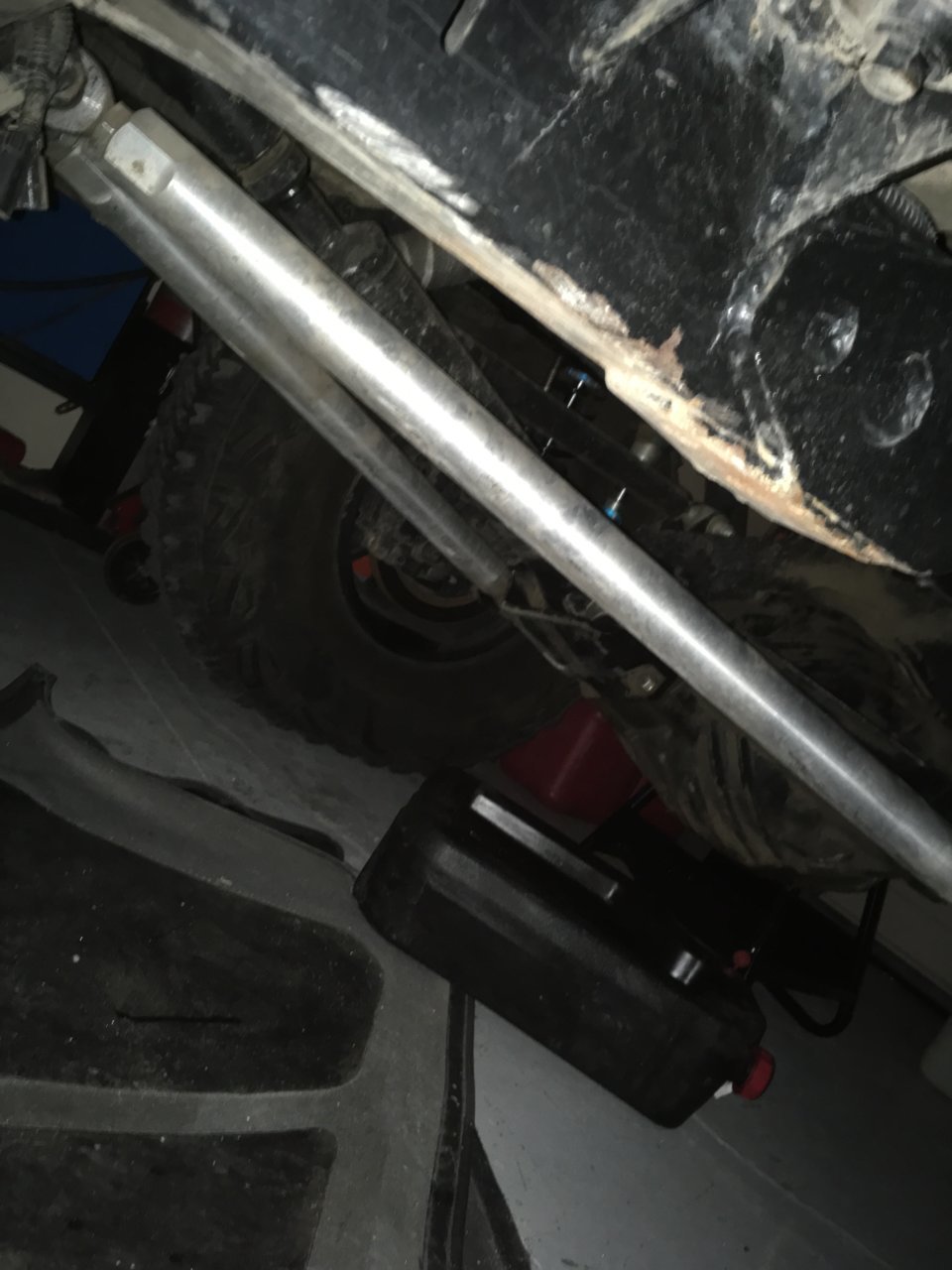

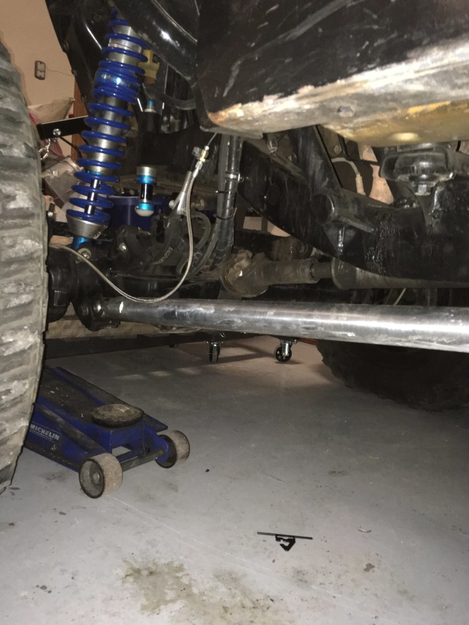

    All depends on use. I would go steel on skids with this thin of metal for cost saving, sliding on steel works a little better in some applications. If someone has the ability to go with a stronger aluminum, and has the fab skills...Rock it.
    Totally off topic but relative to conversation. I run 7025 aluminum links on my rock crawler, in the 2.5" flavor from Wide Open Design. I would never go back to DOM for links again. They just fail in a season or two. No thanks. Replaced enough links, tie rod/steering links in my days to ever go back.
    This is after 4 years of abuse.
    Front Links 2.50" 7025 aluminum on a 5000 lbs rock crawler....that gets used.
    Rear links 2.0" 7075 aluminum. Wish I would have gone bigger, but these are holding up fine for now

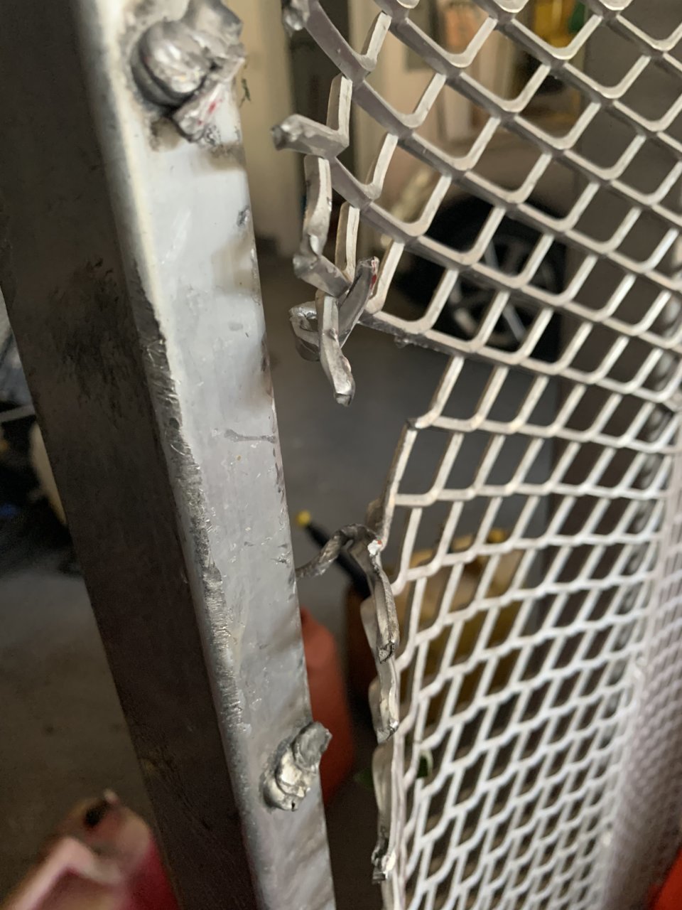

    It'f you're going to be S rapping rocks, get steel skids. Aluminum will gouge, steel will scrape. I've already scraped up my steel skids few times and had to repaint the exposed metal. If I had aluminum skids, they'd be ruined. At least Thats my understanding

    here’s the expanded aluminum on my trailer ramp after one freaking week. I have steel trailers 10yrs old that look better. Alum sucks.

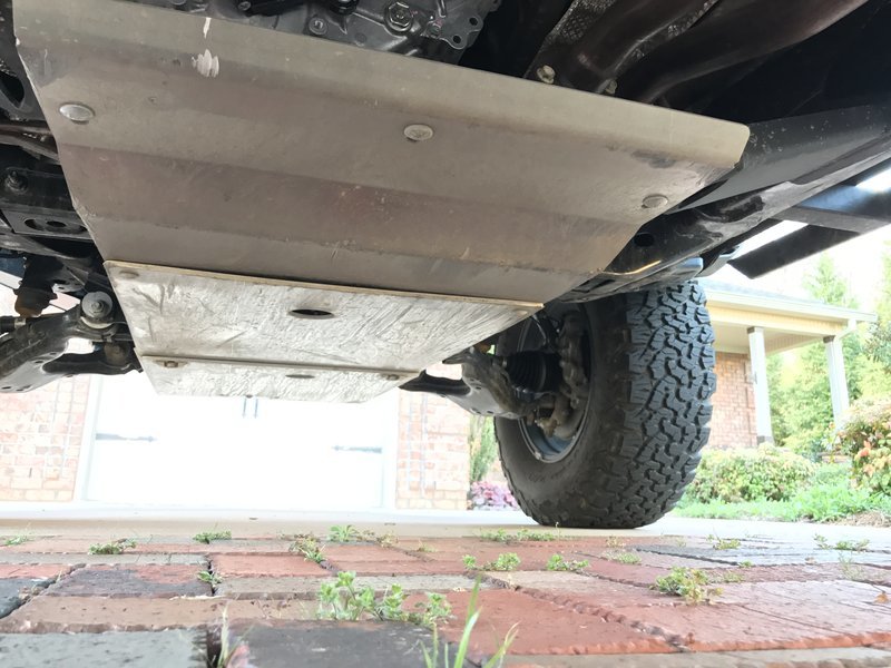

    My aluminum skids looks like this too. They've taken a good beating and I enjoy the lighter weight. It's worth noting that not all aluminum is created the same. Some types of aluminum are stronger than steel and bounce back better. I'm not sure which type RCI is using but I'm glad I went with them over steel.
