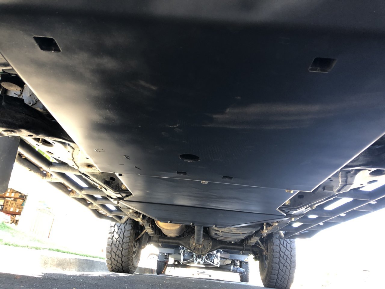

    I hear you. I went w/all steel w/the budbuilt '3 pc.' set, front IFS, belly pan and t.case is 1 skid, and a rear x-memeber that supports the rear of the b.pan. The 40 lbs in weight diff. wasn't enough to compel me to spend hundreds more

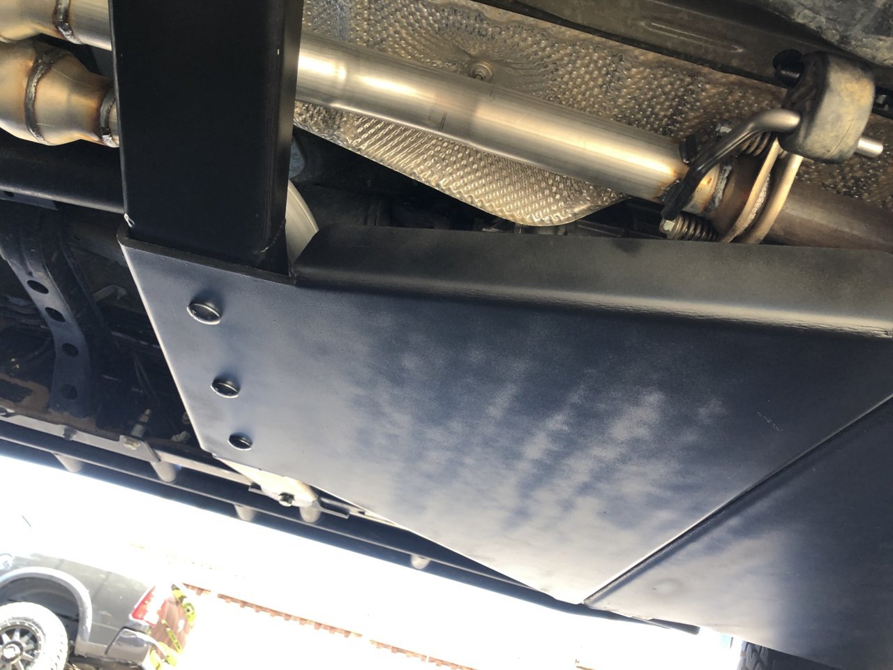

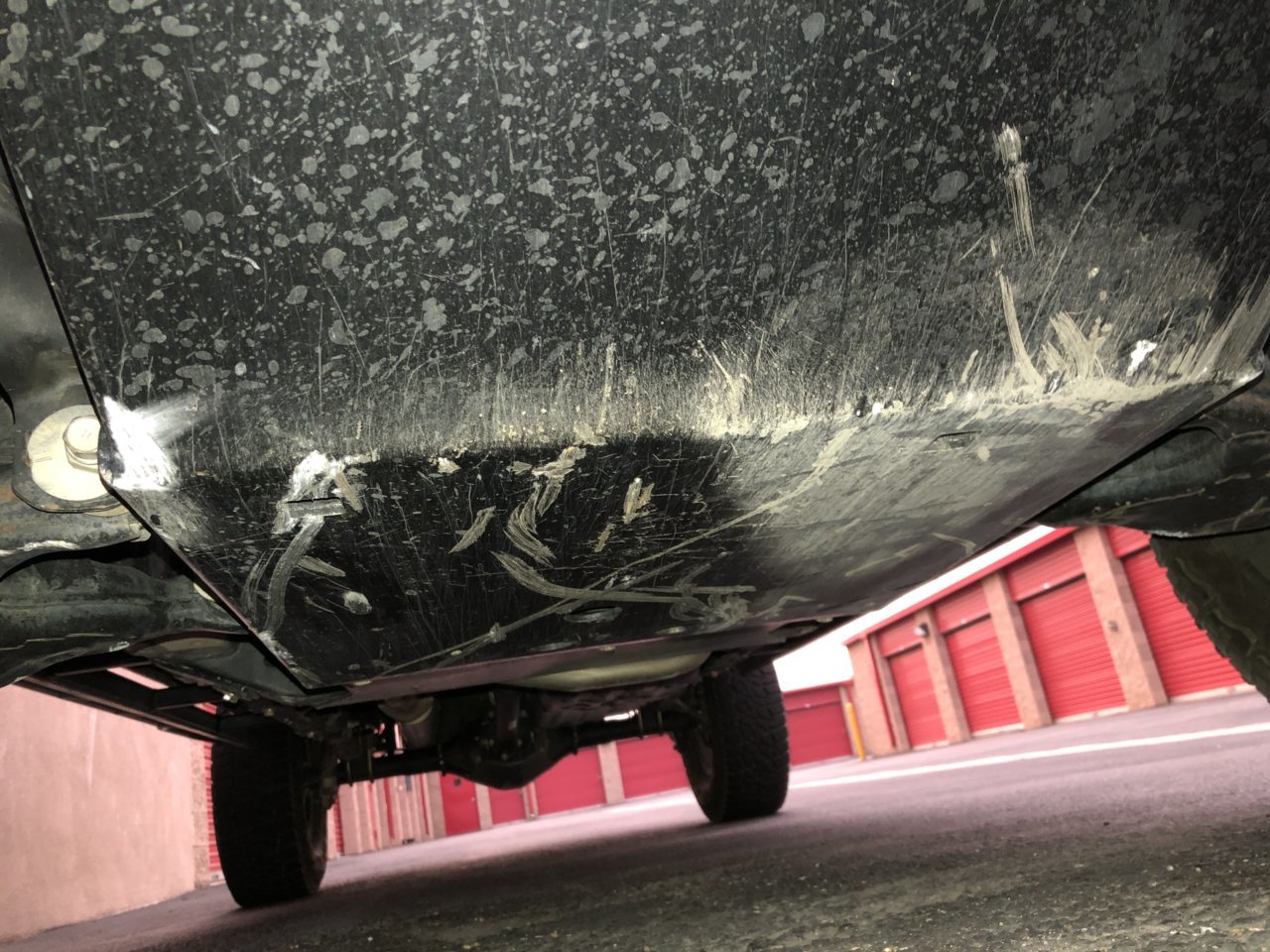

    I went with BAMF full set of Aluminum skids. They look to be built pretty stout and possibly the strongest aluminum option out there. Havnt got a chance to use them yet.
    been waiting patiently to hear about a gas tank skid from them but I think they may have forgot about it.

    Right on, looks good. I just checked out their site again, good stuff. Much less than other manufacturers for the aluminum options I noticed this time. I looked once and stopped, I have a 1st gen., they don't make skids for them. Yours look great! Good, lighter weight option.

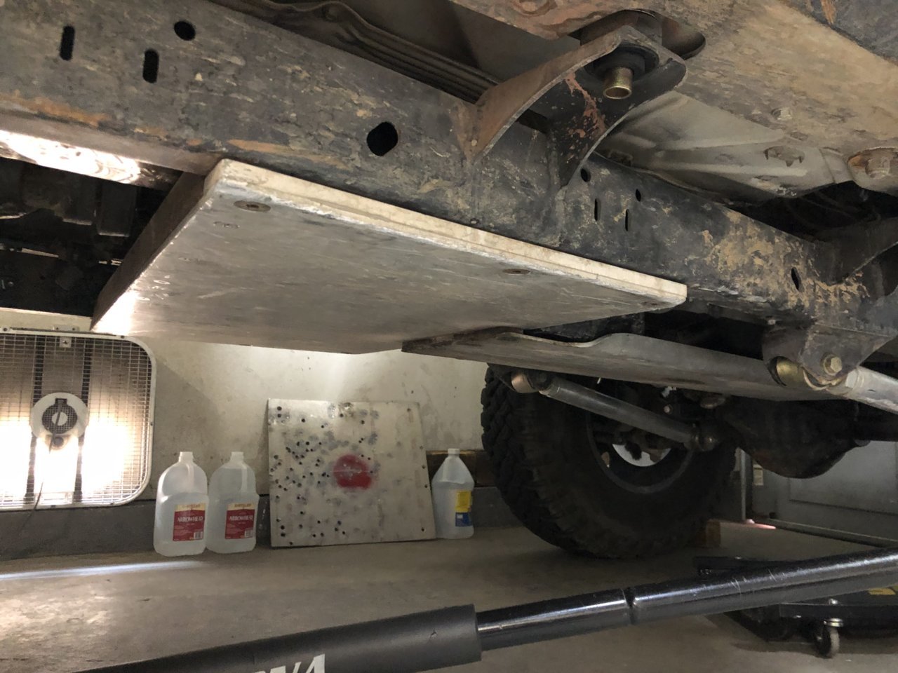

    For reference here is a 1/4 steel BAMF skid. For those of you that play or are going to play in rocks you need steel and thick. Can’t tell from the picks but this only has 6-7 harder trails on it and it’s bent in about 5-6 spots. The aluminum skid I replaced this with was bent so bad that you could see the outline of the front diff and it was so beat up when I pulled it off the bolts basically shot out and the skid would not line up to reinstall it no matter how many dents I beat out of it. So for the cost and strength steel wins by a long shot. The skid picture had been painted many times and major gouges were ground down with a flap disk. This is 2 trails since the last paint job.

    went w/steel, thank you for the pic
