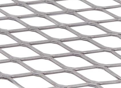

    If you just want something lightweight to deter access to the cat. Consider using heavy gauge expanded steel. Mount with a security type bolts.
    It will be lighter than a skid plate, shed water, allow cooling and be a barrier.

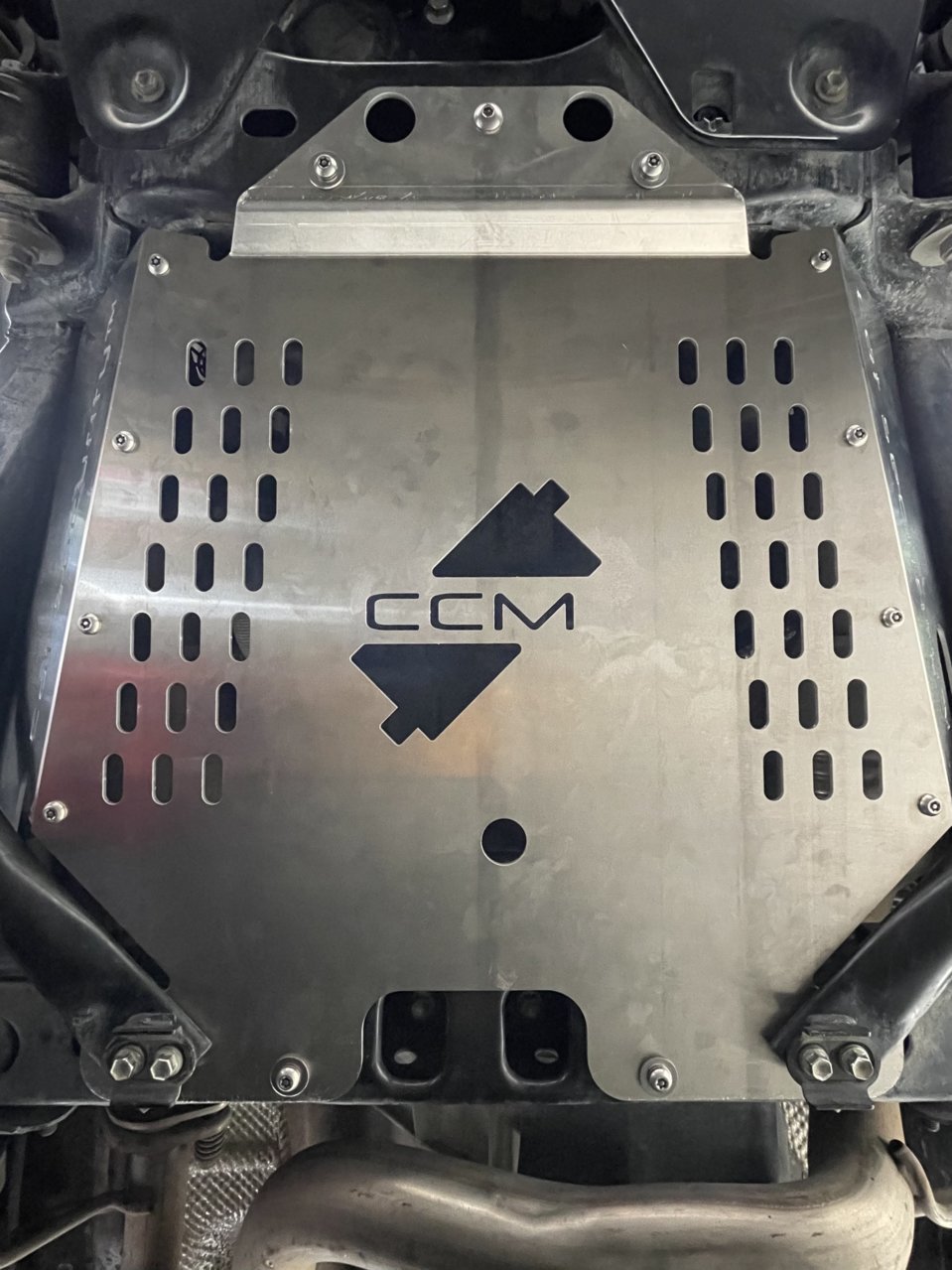

    Hi folks.
    I finally got it installed.
    The pictures I took are too poor (blurry) sorry my smartphone is obviously not smart.
    As for the product and install...wow it was heavy as mentioned in other post; and yes it's thick as posted
    Installed it prerunner, not hard just had to take my time. Installed it with a floor jack and some left over wood which allowed me to do it alone.
    @Bravisimo .. I looked at the product you cited, but for some reasons like I just wanted to have less visibility of the cats, this more of a deterrent, I chose the one I purchased. In the end, am I content...yes, happy about spending the money..no, but to me it come out cheaper to pay for this rather than be frustrated that I did not try something as well as my insurance deductible is a lot more than the cost of the product.

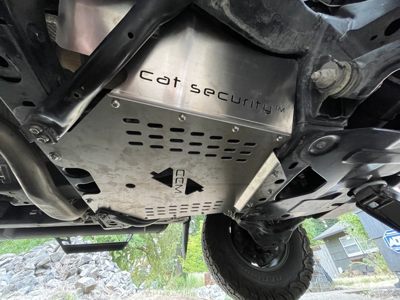

    I just installed this one:
    https://getcatsecurity.com/purchase...cat-security-toyota-tacoma-2016-2021-4wd-qv3z
    took about an hour but good lord get a sharp new 7/16” bit and some tapping paste or your shoulders will hate you. They’ll probably hate you anyway but it’ll make things doable (you have to drill 4 holes and install riv-nuts but everything to do a DIY riv-nut install is included except the bit).
    edit: a few on here have said they don’t even use the Riv-nuts….. it seems like that’s a good option too; they are just extra security/vibration reduction. I never even thought of that.
