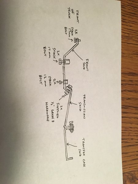

    I have nothing constructive to add to this conversation, I just have to say. Joe's drawing skills make mine look like preschool arts and crafts.

    Haha, this was sloppy. I learned and have been doing technical drawings by hand for 20 years. Computers replaced most of it but it is still needed from time to time.

    From what I can tell, M12 x 1.25

    Thanks Joe. Of course my kit has M12x1.50 and M12x1.75.:annoyed:

    I had the same issue. I had to reuse two of the original spacers in the middle holes also. I have a diff drop kit also. Not sure if that matters. I reused the bolts that came off the recovery hook (they were long enough) as I removed it when I installed a bumper. I thought it was just a fluke but I guess not. No biggie just FYI.
