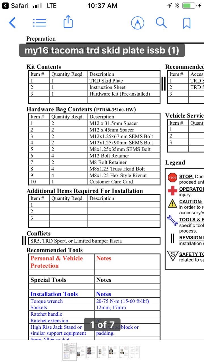

    Does anyone know the bolt size for the OEM skid plate on my 16 taco?

    Same as the trd ones

    Correction back two are the same in terms of length...the front four bolts are longer in the trd skid plate because it has spacers...sorry for the mix up. Think I have them if you need them. I toss my OR skid plate for a trd one but kept the bolts.
