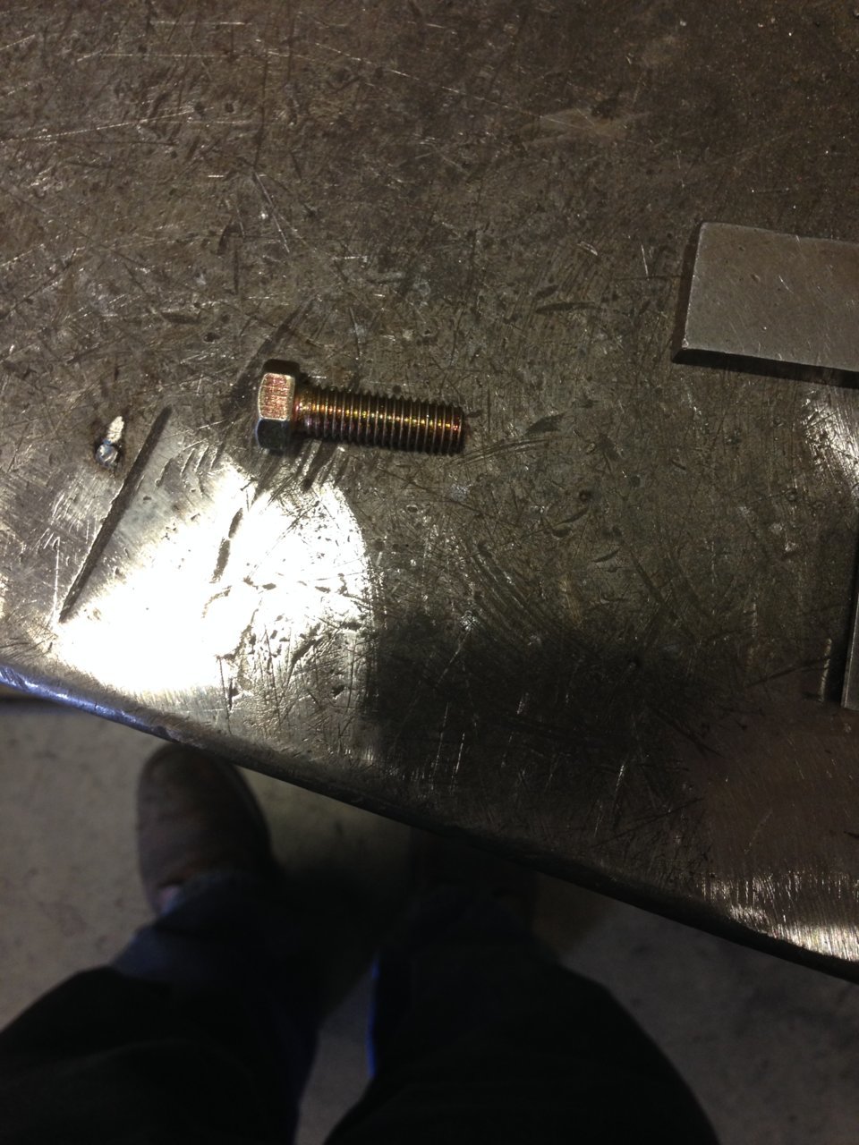

    Not sure the grade.Theyre galvanized M8x1.25x30.Theyre not grade 8 or else they'd be gold.So just assuming they will work?

    Metrics use a different grade standard, though. Imperial grade 8 is equivalent to a 10.9 metric.
    10.9 comes in a few different finishes. I have some zinc plated ones for my lower ball joints, and the ones for my skidplates happen to be flat black.
    Quite honestly, though, the grade doesn't really matter with the stock skid plate. That sheet metal would bend/tear before the bolts even start to bend. I had a nice hole punched in my stock skidplate (happened before I bought it when it was practically brand new).
    Stock isn't really a "skid plate" anyway (because it is so thin), I think Toyota calls it an "air deflector" or something, lol.

    IMG_2081.jpg Found grade 8x25 actually
