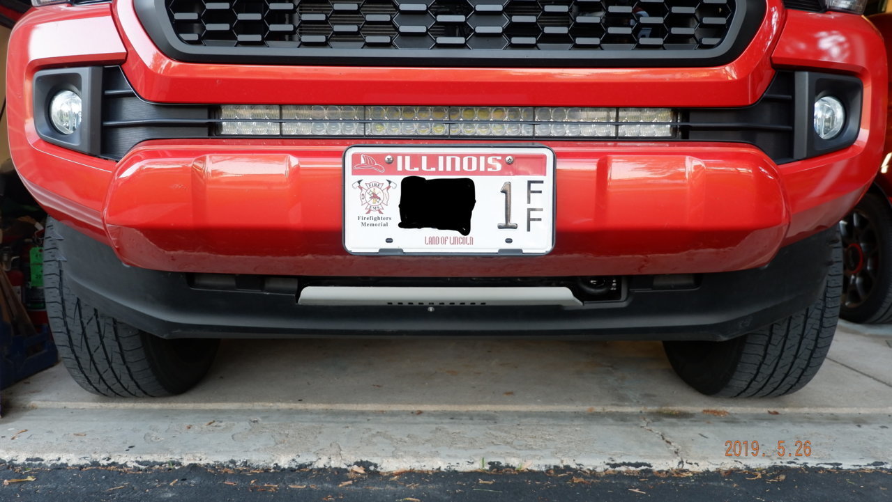

    17" Black TRD rims Tacoma Stainless Steel Rear Tailgate Letter Inserts Brake light flasher Center LED 110v and 2-3amp USB plugs mod in back seat center 400w on all the time mod SSR-610-40 SumoSprings 32 INCH 180W CREE LIGHT BAR (5D ) AUXBEAM BedStep and Pop & Lock Power Tailgate Lock Blue LED glove box light (fix no light) Bed light Blue LED's Wired to turn on when Gate is opened Tempered Glass Center Touch Screen Protector Rear Camera anytime Navigation Bypass ( a must) Rexing V1 3rd Generation Dash Cam hard wired in OXILAM 912 921 LED Reverse Light 2000 Lumens TRD Pro Grill TRD Skid plate
    Well? it can fit if you want it to.........
    Its up to you on what you like.
    TRD skid with a little trimming to fit the wind deflector..

    It all depends on how hard you off-road. i don't drive into a rocks, But back road /fire road stuff, i did take it off when i went out to Moab, took 3 min. BUT when i hit big snow drifts it wont bend like the OEM splash guard did.
    Every one is not making a rock crawler.
