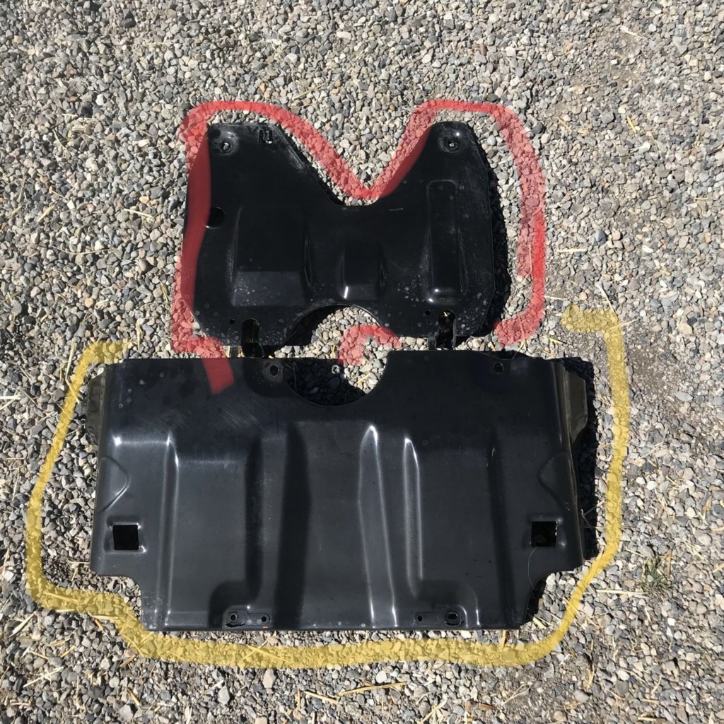

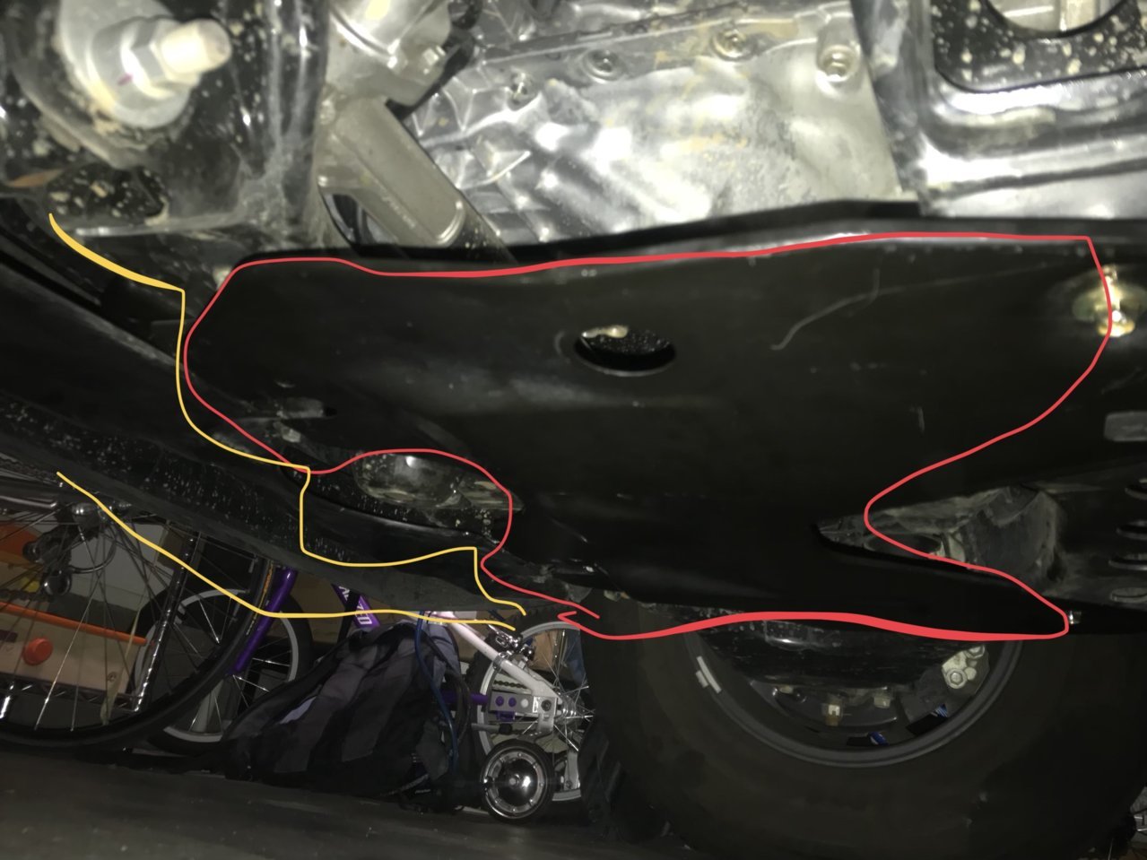

    You would need to remove or modify the front air dam / lower valence to accept the TRD Pro plate, which will ding your highway mpgs a bit.
    You could just add the OEM transmission “protection” plate that comes with the Off-Road Tacos. It’s the red section in the pictures. I picked mine up for $25 from another member. Serious rock crawlers or guys that want the Pro look sell them somewhat regularly here. That combined with your stock Sport brush guard would cover the same area as the Pro. (The transmission plate and the OR OEM gas tank skid with the Spectra ST323 straps could both be had and installed (by you) for well under $200 if you watch the TW classifieds.)
    This is what I did to my SR5. I drive on Forest Roads and 4WD trails strewn with baby heads, and the OR setup works fine for me. I probably didn’t even need the extra protection for what I do.

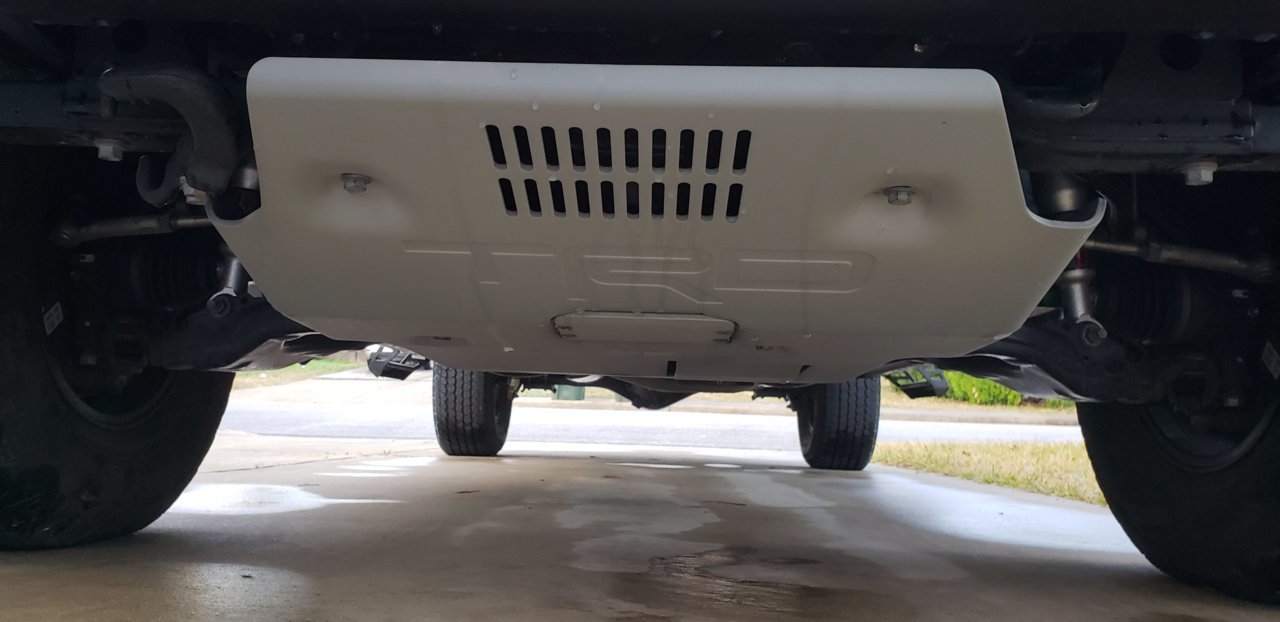

    Factory fit and finish. Trap door for oil changes...
