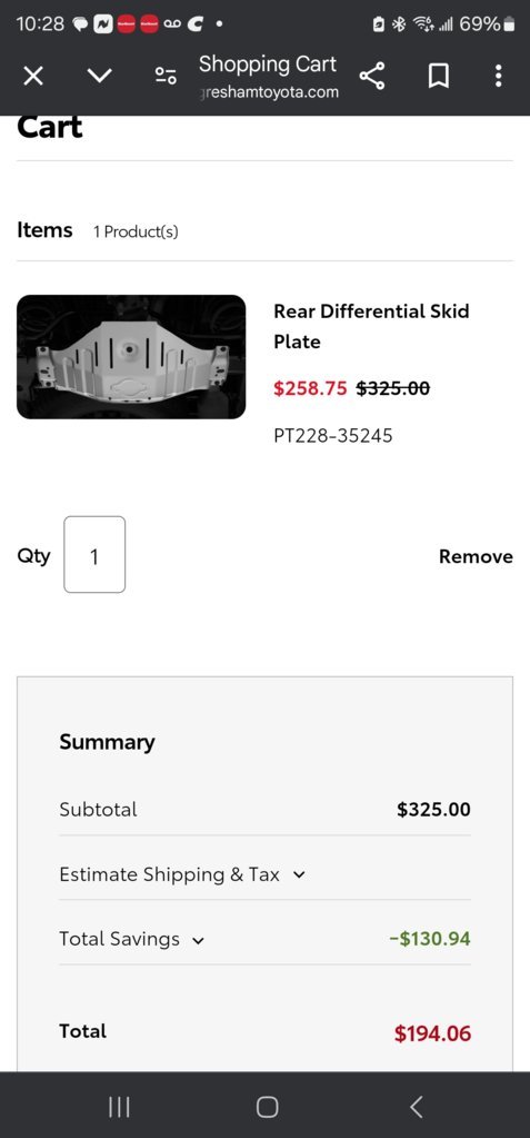

    I ordered the rear end also. It was too good to pass.

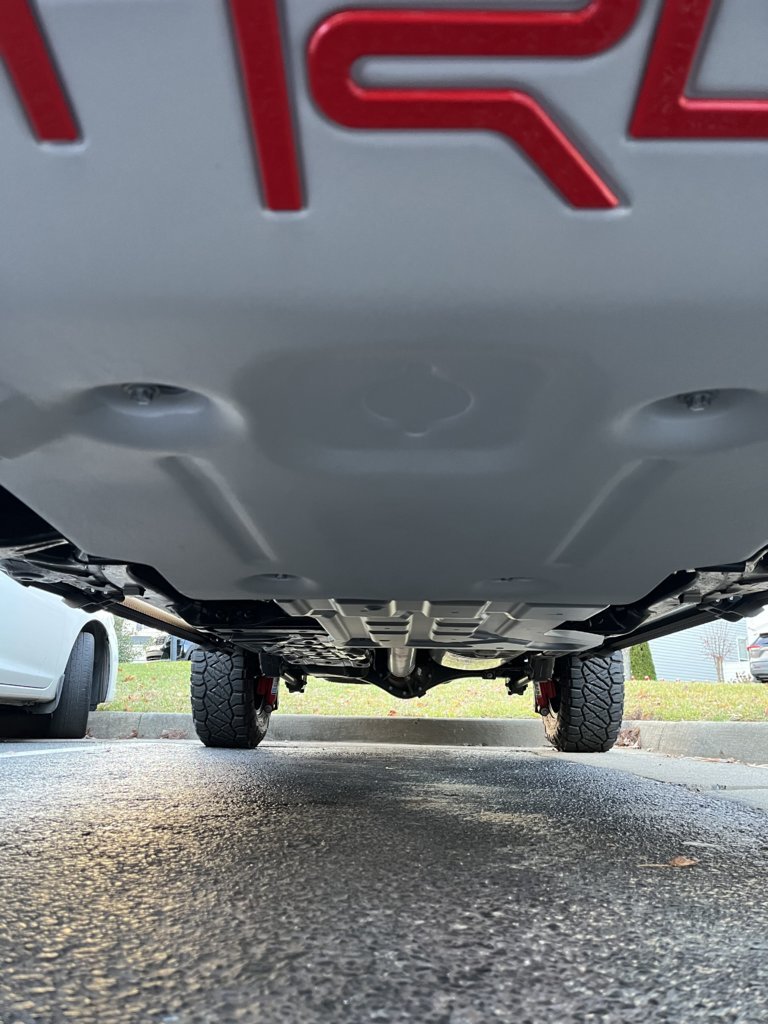

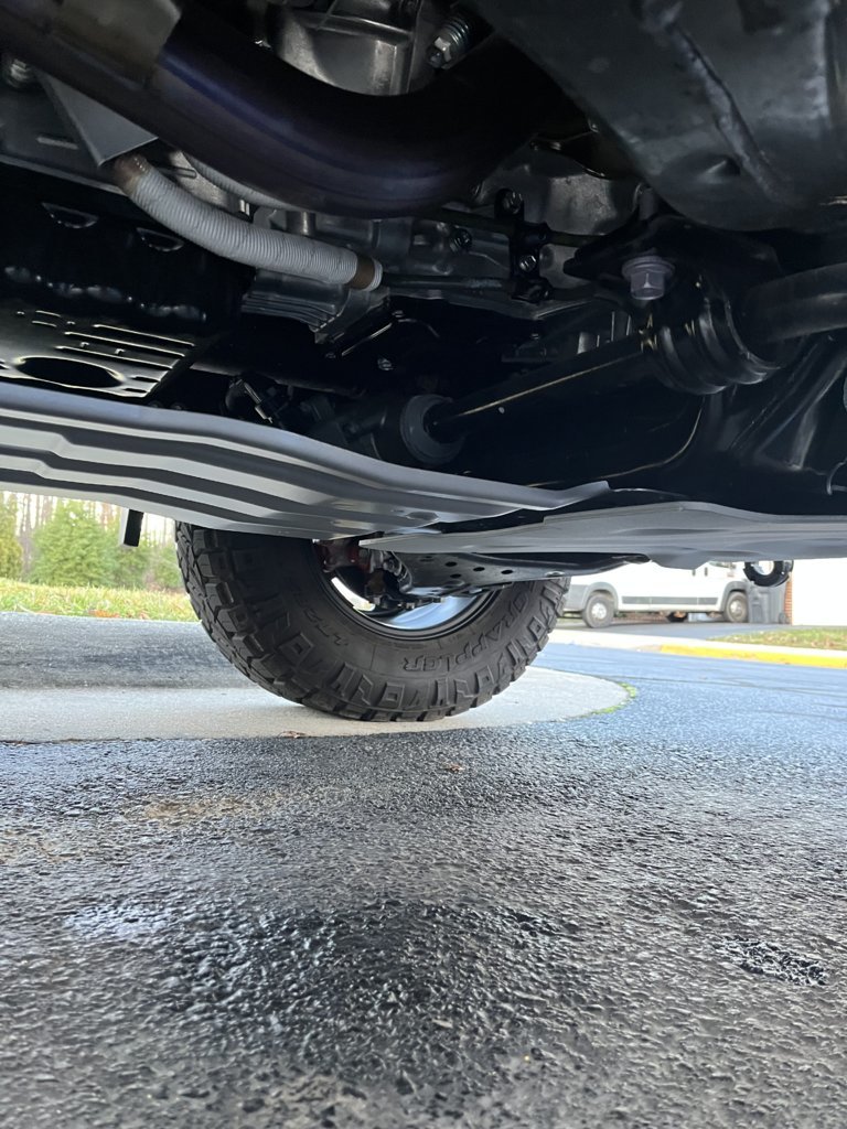

    3 skid plates finally installed. Here are some photos. I put some keyed bolts upfront also. 20241220_114206.jpg 20241220_114211(0).jpg 20241220_114255.jpg 20241220_114828.jpg 20241220_114813.jpg

    Was the rear differential skid plate an easy bolt on? Looks awesome!

    Yes, it was easy once they sent me the correct one for a hybrid. I just removed 1 bolt for a brake line that was in the way on driver side to help in slide the bracket in. The brackets aren't 100% flat. So make sure the shorter side is pointing outwards towards the wheels.

    Can you give me the exact part number for the hybrid because that’s what I have? Thank you
