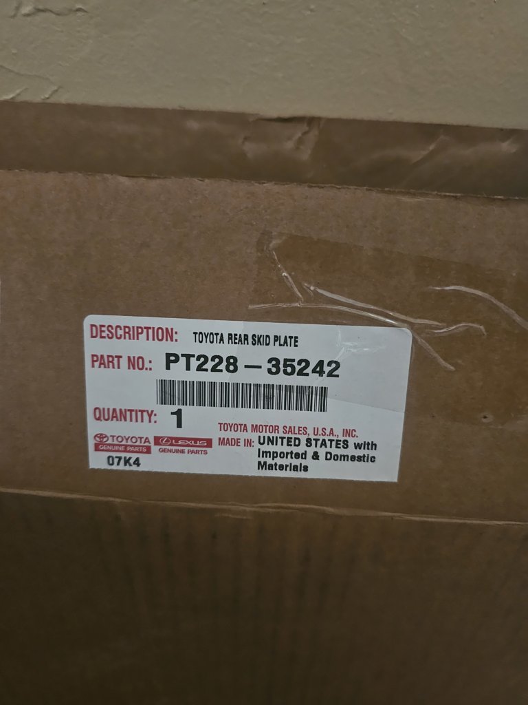

    Wahhabm
    Wahhabm [OP] Well-Known Member
    Sep 1, 2024
    #456237
    366
    Monther
    PT228-35242

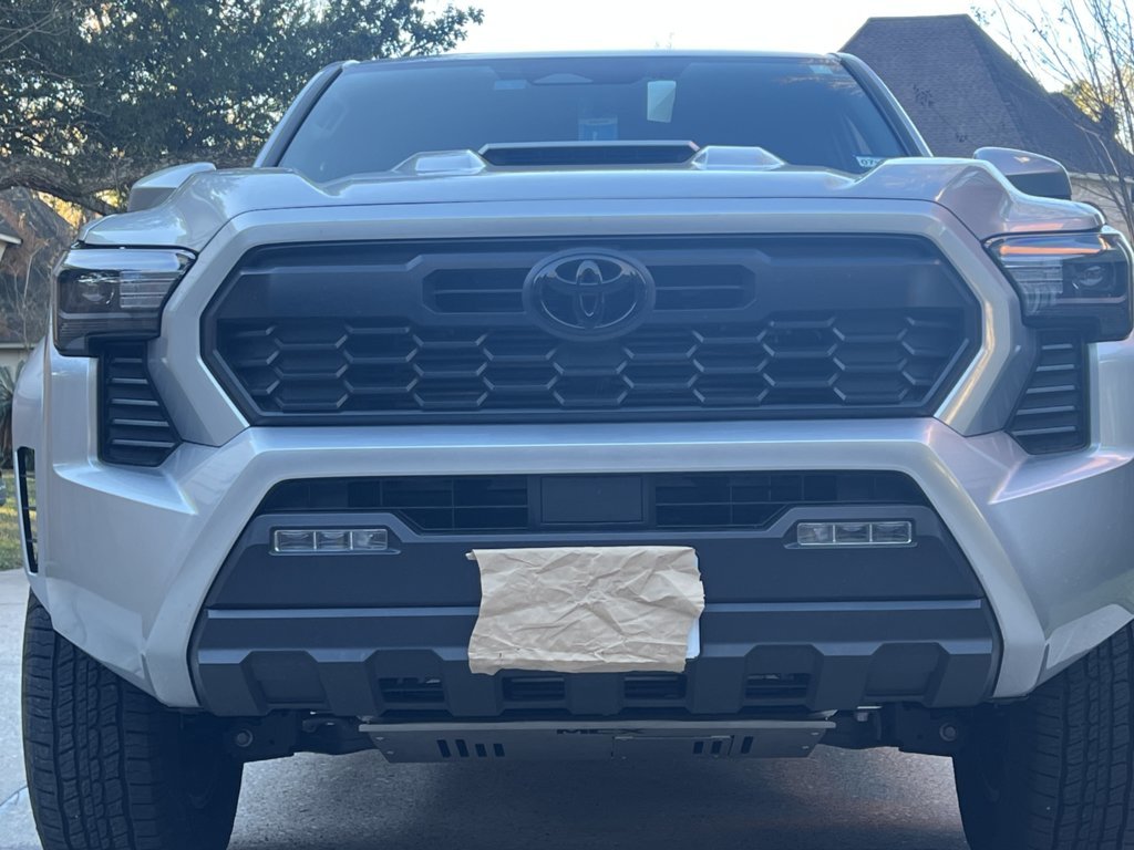

    got the rc installed and was able to have the rear bolts share with the front bolt locations on the miller cat so I l had to replace the security screws on the miller cat shield with the RC bolts and the two overlap just a bit but it seems like it’s a pretty decent fit overall. What do y’all think? Any concerns to be aware of with this solution?

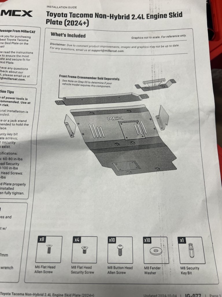

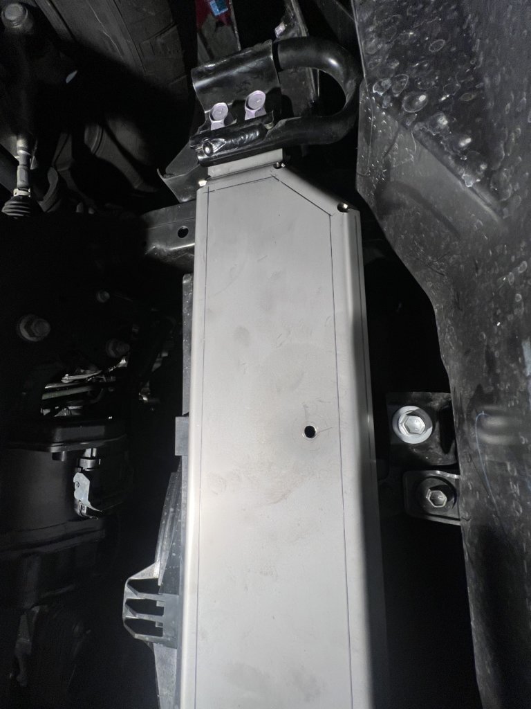

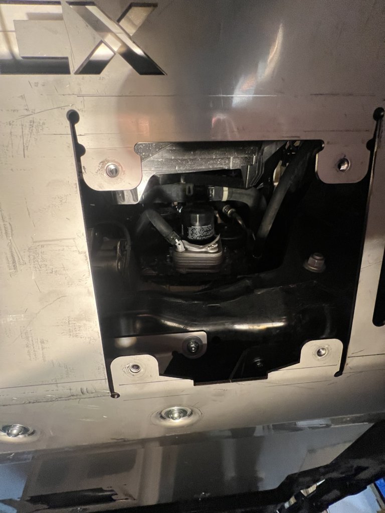

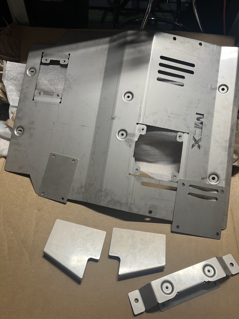

    Finally installed Miller Cat Skid plate on my Sport………
    Ordered the additional crossmember from Miller Cat (pic)…..total came out to $465 , free shipping, 10% Black Friday discount…….(you can get 5% any day with Rob Motive discount code)
    a couple of pics……….of everything ordered and included……..packaging was great, so was Customer Service……
    Skid install requires removal of Air Dam/Spoiler……..
    put truck on ramps for extra room to maneuver………hardest part was finding a way to lift skid in place…….37lbs that felt like 100lbs……
    Chose Miller Cat over the Toyota Trailhunter skid because of the 2 access panels……oil filter and oil plug……IMG_7035.jpg IMG_7037.jpg [/ATTACH] IMG_7040.jpg IMG_7041.jpg IMG_7039.jpg IMG_7038.jpg

    2 access doors…….oil drain, and filter…..
