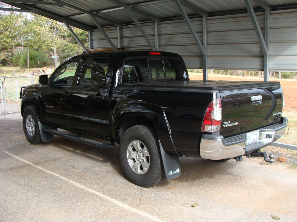

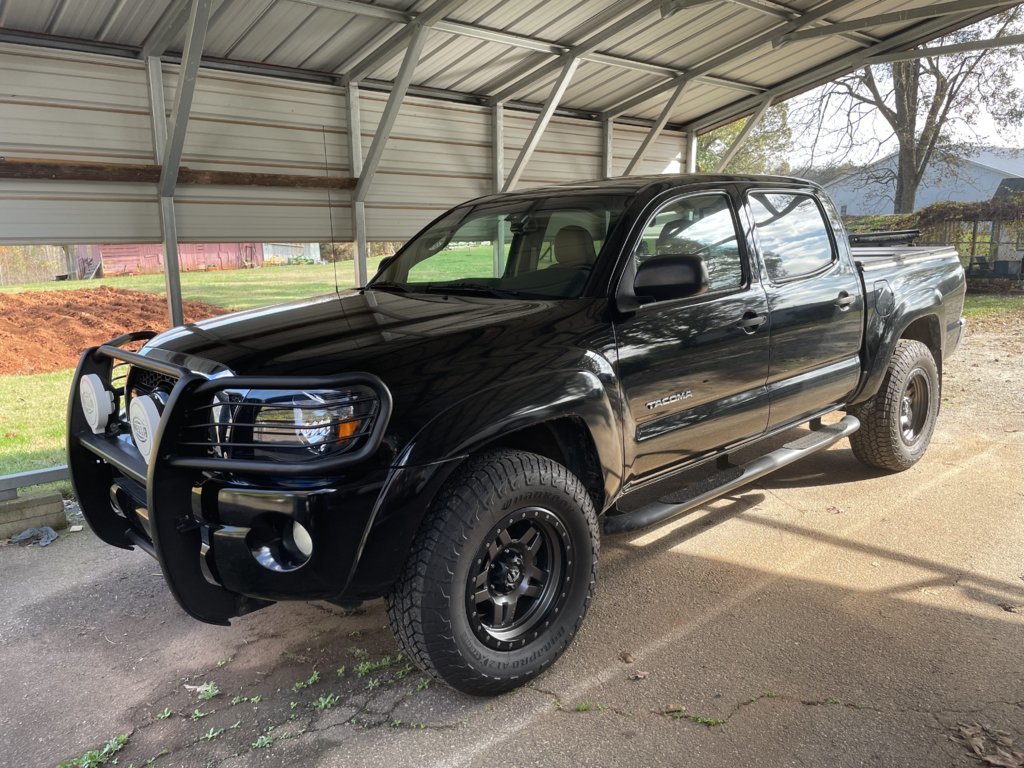

    What do the tires look like that you have on the truck now? Unless they are a straight tread highway tire, you might be okay with what you have for light four-wheeling. Until you start getting on rougher roads than a fire road and the ground isn't muddy, you might be surprised how well your truck will do just like it is. Try out low range 4WD on a dirt or gravel road with some hills and head for a ditch that won't bottom out the frame, practice getting out of it.
    Larger tires might be nice, but you probably don't need more than one size up from what you have, to ensure the bigger ones don't rub or jam in the fenders if you get the suspension at its limits. Stick with an all-season truck style tread, no mudders or rock crawling tires or you'll hate them on the highway. I'd buy a good 20-25 foot tow strap and a "come-along" (hand winch) to take with you.
    Something like these tires is all you need, tread-wise. The size of these is 265/70-17, so bigger probably than you need.b642975f-456b-4d1c-adad-309f36d003d5.jpg
    These are 245-75-16's which is what my truck had when I bought it (2011 model)

    Your before stock tires are the same size I'm running now. Im seriously considering the size tires you have, either 265/70/17 or 265/75/16(so I dont have to change my wheels right now). Seems like I could get away with this size without having a lift and no rubbing

    The 265/75-16 is the same rolling diameter as the 265/70-17, within about 1/4 inch. What you trade off in rim diameter on the 17's is sidewall height on the 16's. I went to a 17 because I couldn't find wheels in the style or offset I wanted in a 16.I'm not sorry I did. My tires don't rub and my truck is stock height; it sits slightly lower than the TRD packages do, mine is a SR5. The fronts do come close to the front of the inner fender liner when turned full lock, and if you have front mud flaps they will rub.
