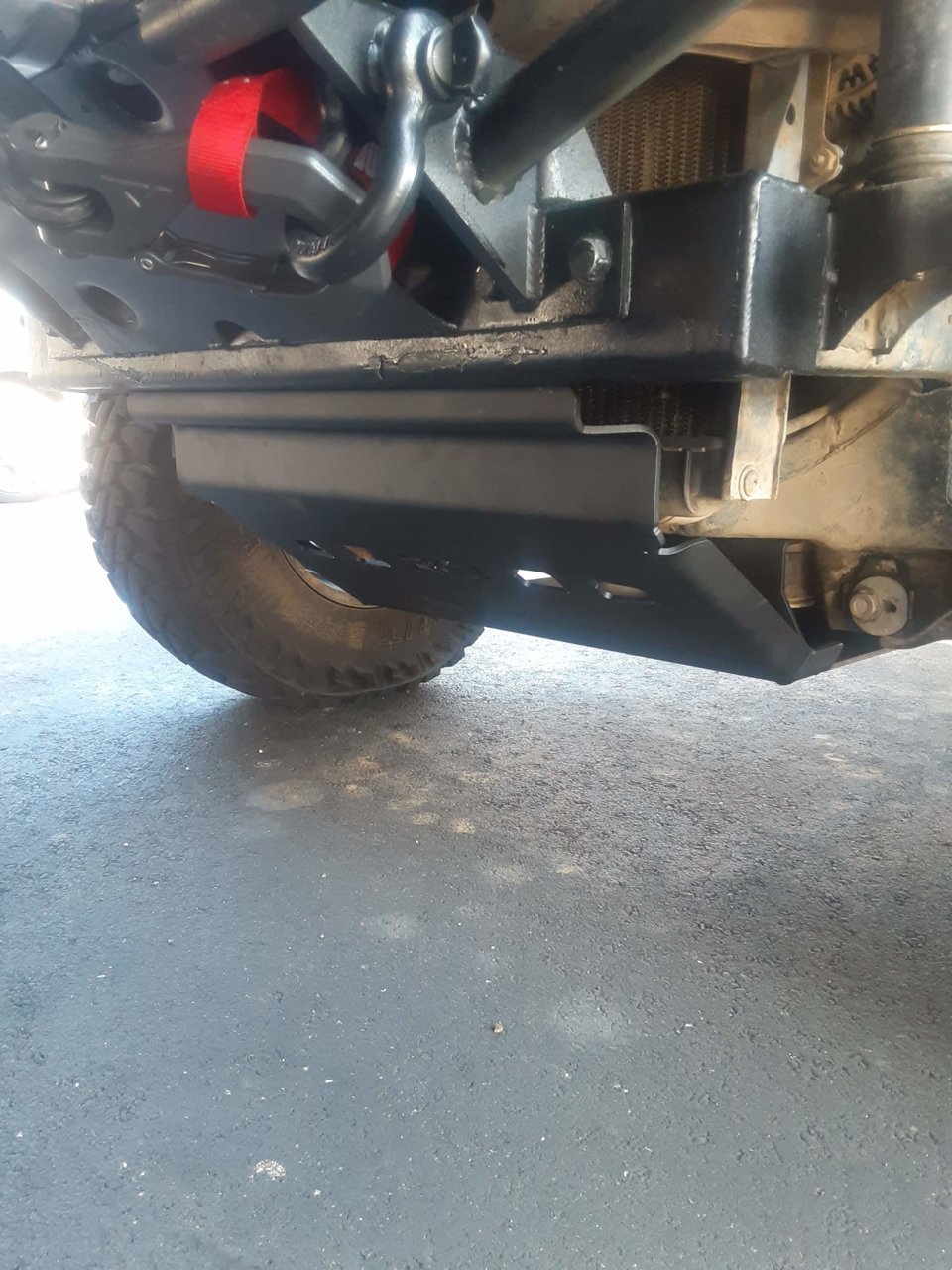

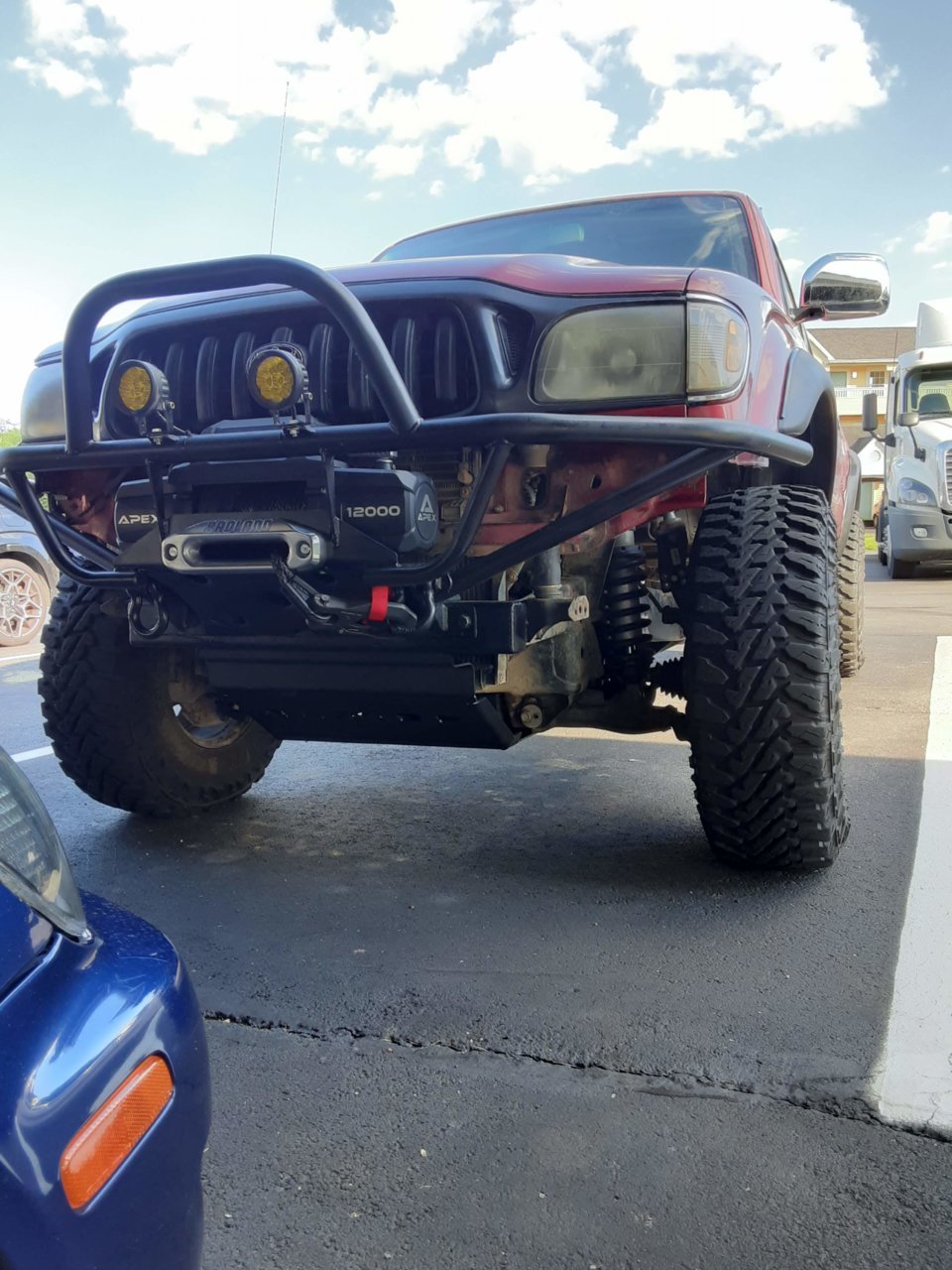

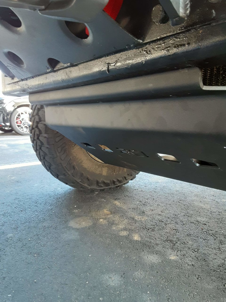

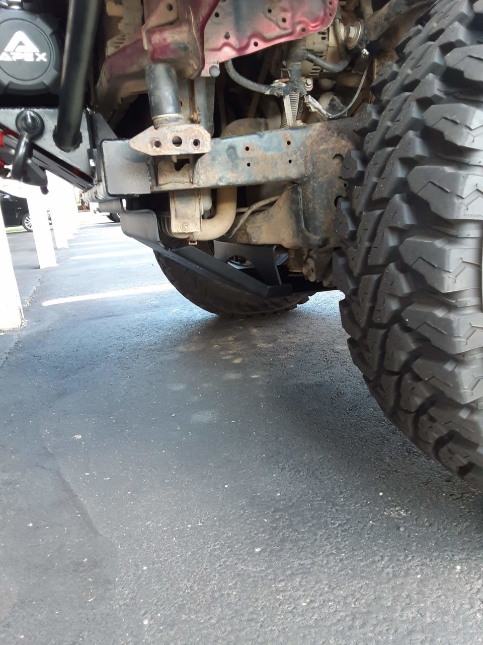

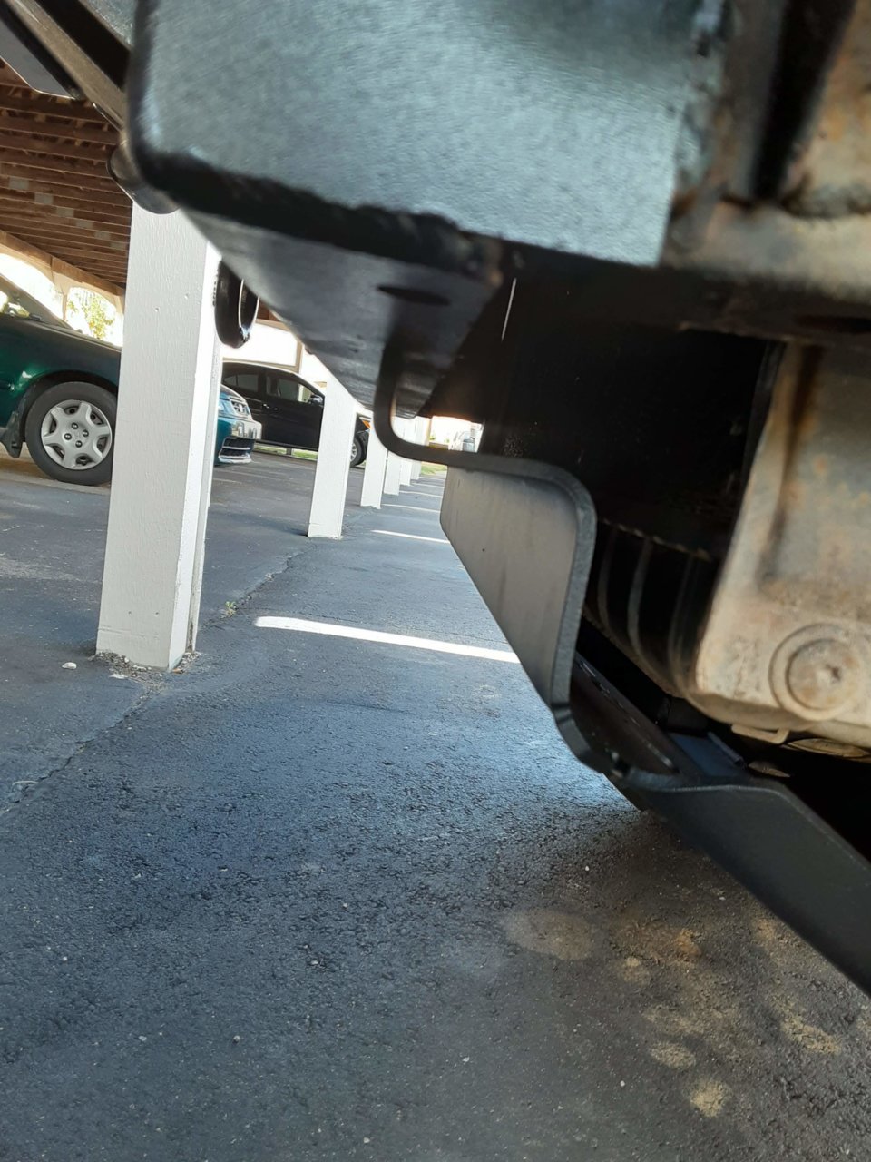

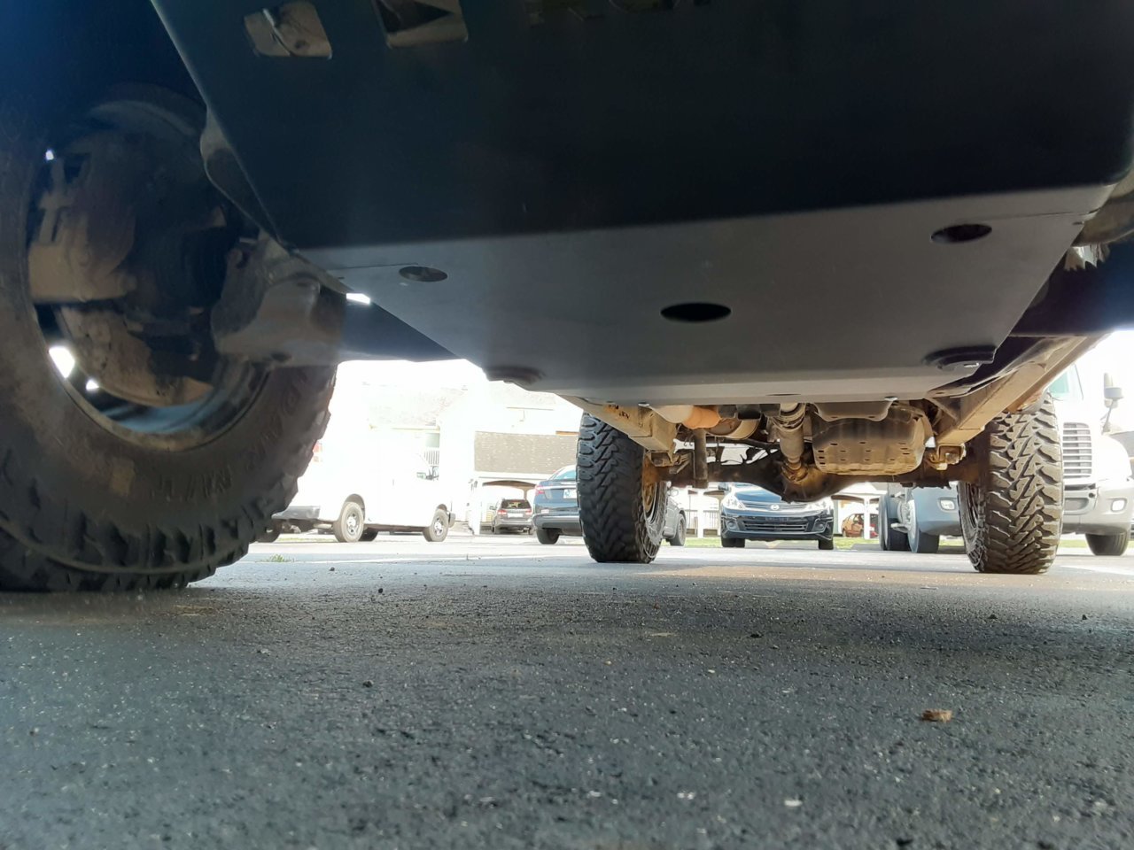

  15. May 31, 2023 at 4:49 PM
    tacoman2001$
    tacoman2001$ [OP] Well-Known Member
    Sep 23, 2022
    #406478
    767
    Update got the skidplates on today and they're super nice. Bolted up like a dream and keep everything well protected. I ended up not putting in the front bolts that would go into the front cross-member as they didn't line up with the bumper but the front lip touches the bumper creating some contact so I'm not worried about it.
