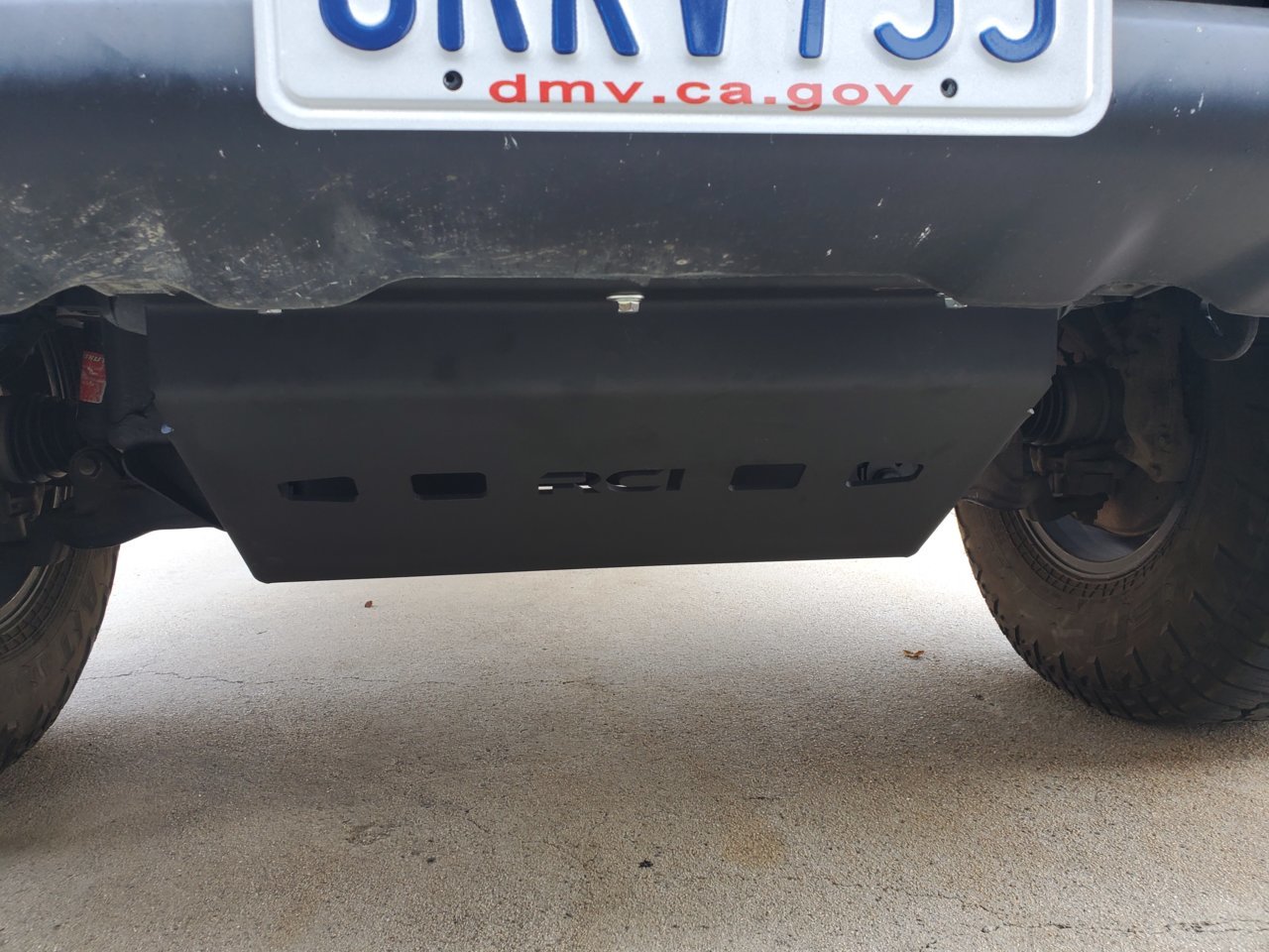

    I put the rci one mine

    Nice. I'm probably gonna go with 'skid Row', get the set of 3 eventually. start w/the front one, more or less like yours. I have to say though for some reason I like the shape of the RCI front. I wonder if I can make the diff. brands work. Thx

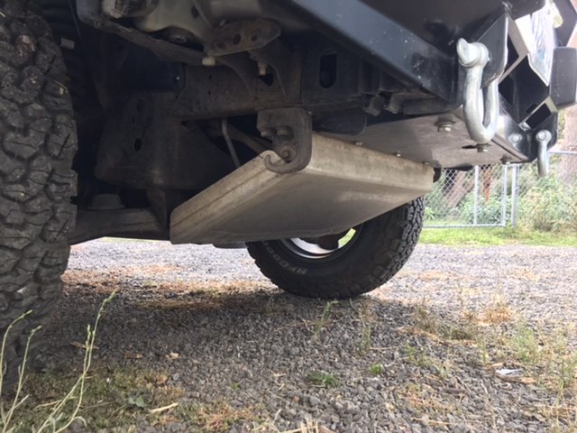

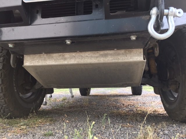

    I went with the budbuilt and like it. Skids make oil changes a little messy but there are access holes to get to the plug. 33E718E4-A893-4608-9DC7-D55310577E59.jpg3556847A-E28B-42C9-B0A0-80CFFB39B4CF.jpg

    Thank you, and thanks for the pics! Most likely I'm gonna go w/Budbuilt now. I like the idea of covering the alignment cam's. did you go with another 1 or 2 behind the first skid? I haven't even looked at their web-site yet.

    No, just the front skid. I have the ARB front bumper so weight was a consideration. That’s why I liked the aluminum too. The front skid goes back far enough to give protection for the steering rack which is great. That thing is solid and has taken a few hits without showing anything more than a scratch.
