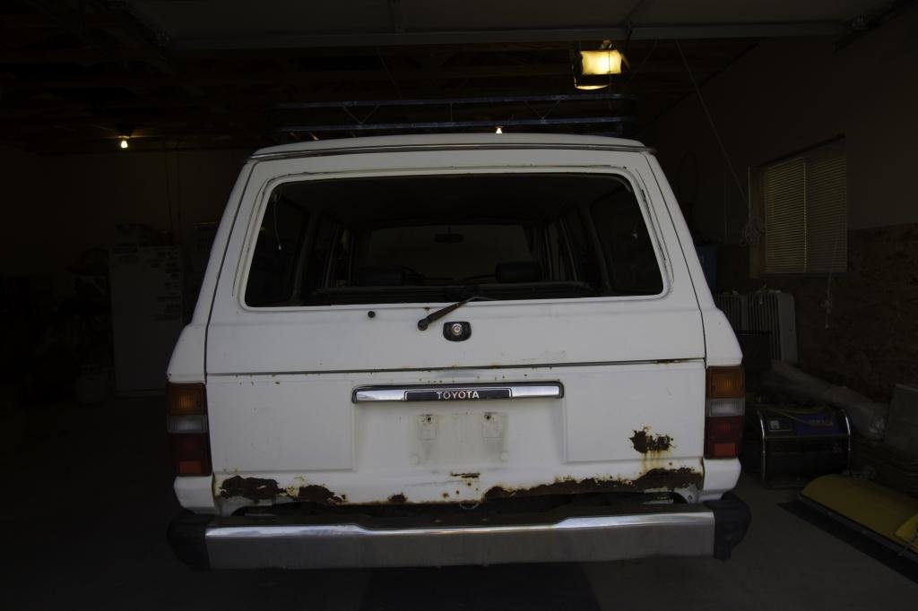

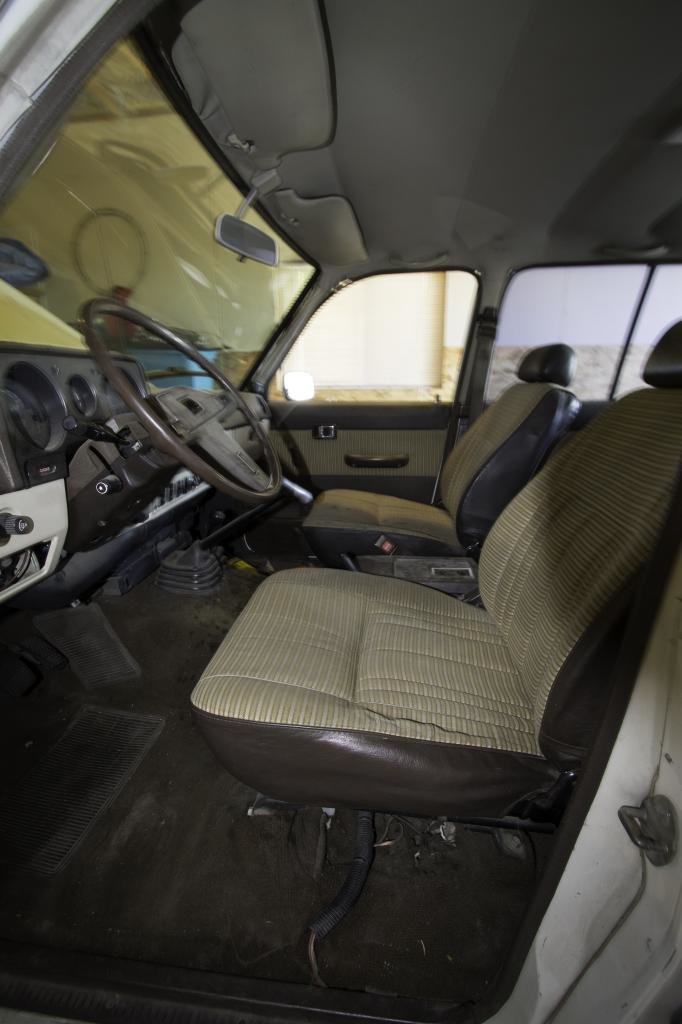

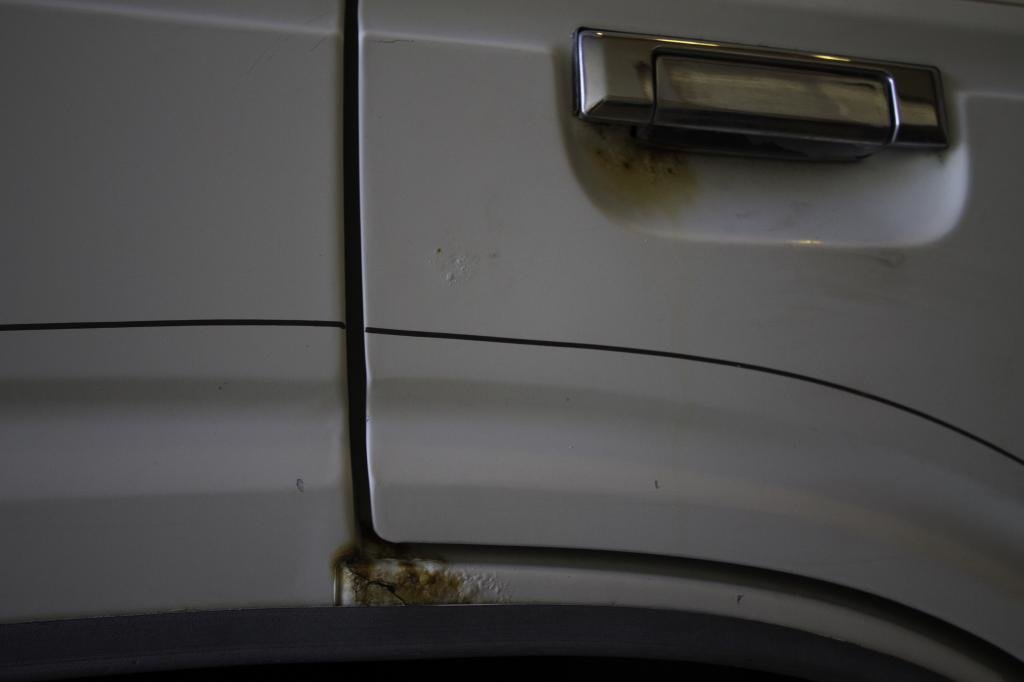

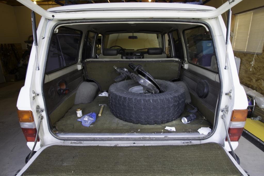

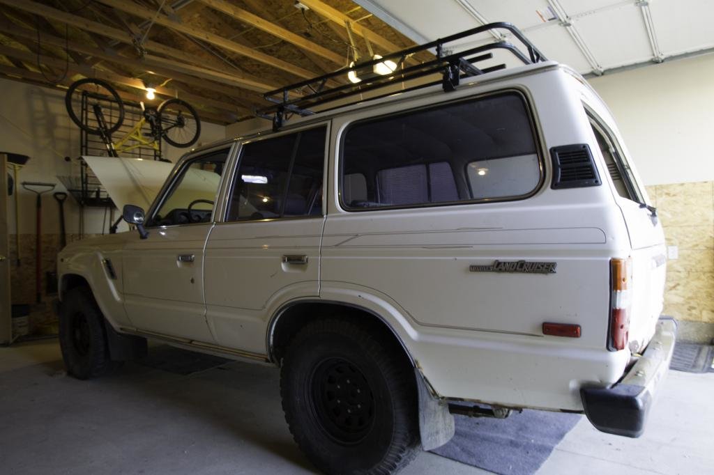

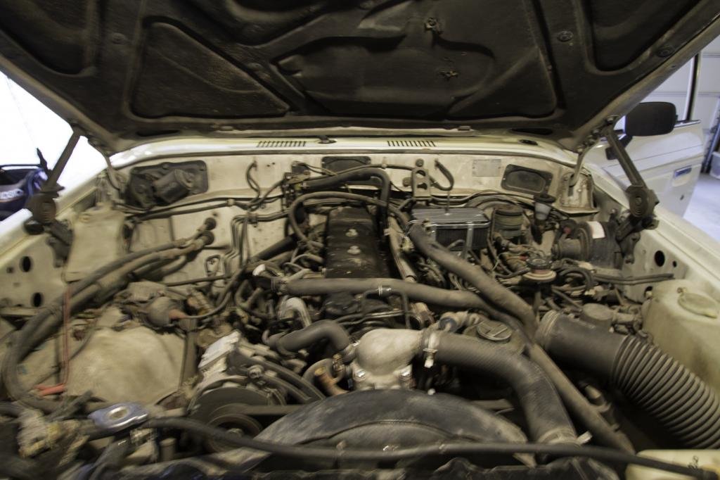

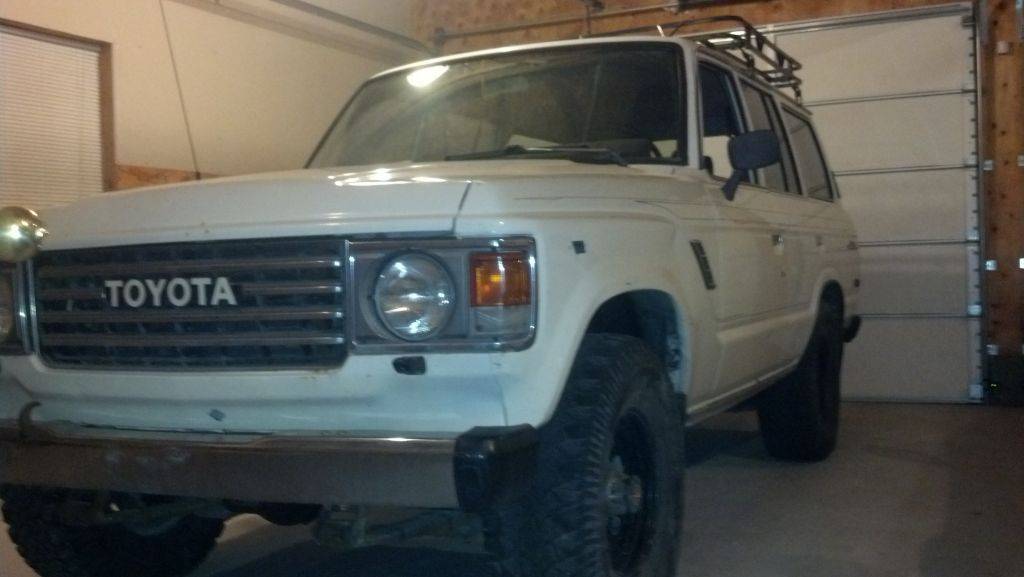

    Sold the taco, it's been driving me nuts not having something to wheel and tinker with. After looking for a while, and found this little gem.

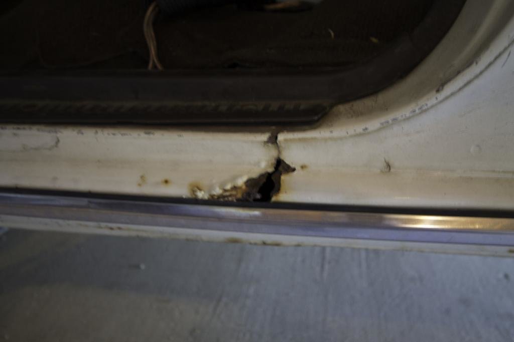

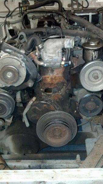

    1985 FJ60, 2F 4 speed. Some rust, but not as much as most of these. It was a Salt Lake rig, so some is to be expected, good news is the frame is good. The odo says 86k. From what service and inspection records there are, along with wear on common wear items I have no reason not to believe this. It hasn't ran in a while. Its got a Weber carb on it, but all the smog stuff is still there so that's going to come out. Also has a big water leak out of the bottom of the water pump. Its missing the rear glass too.

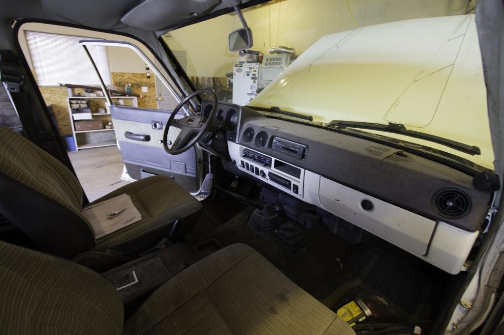

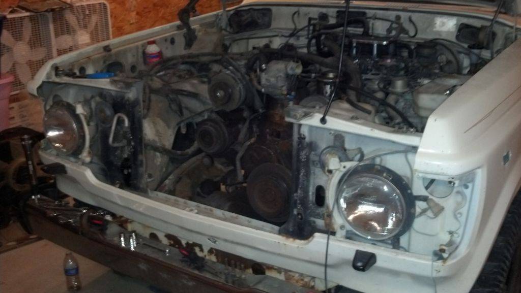

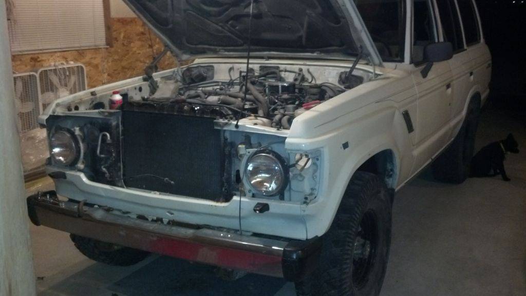

    Tonight the wife got the interior cleaned up a little and I almost got the radiator out. I love rusty nuts and bolts. :mad:
    Now for some pictures because really that's all that matters to some of you goons. Sorry these pictures suck, I should have grabbed my tripod.

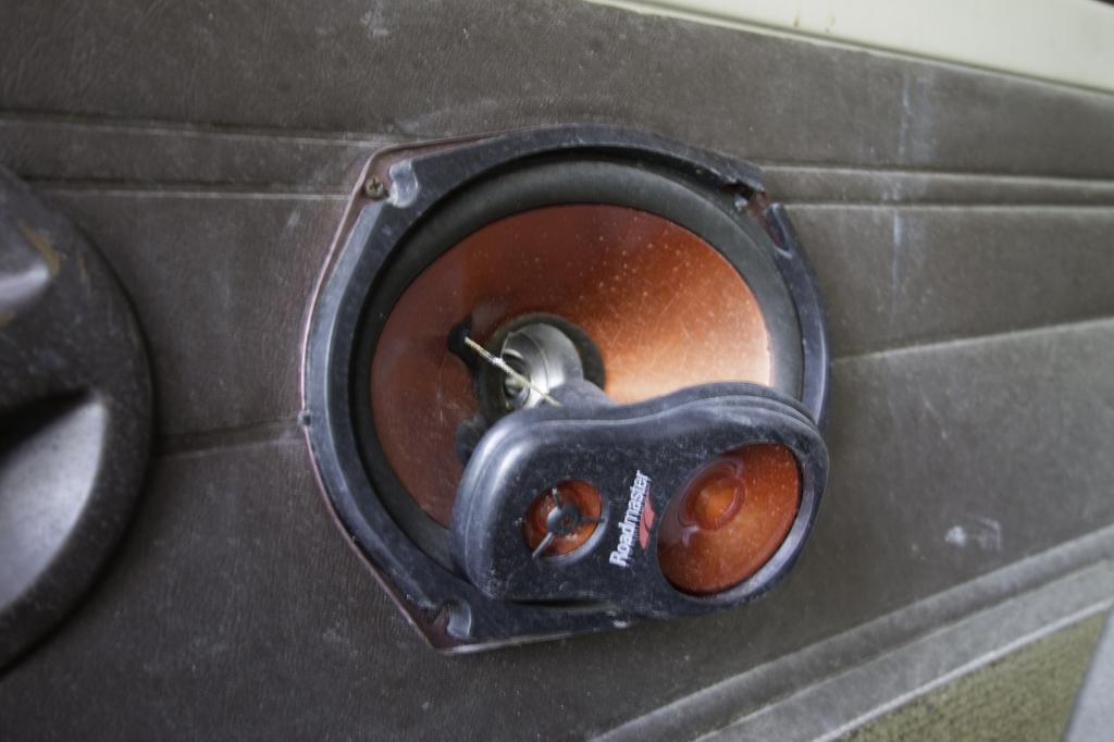

    Custom sound.
    This is under the driver door.

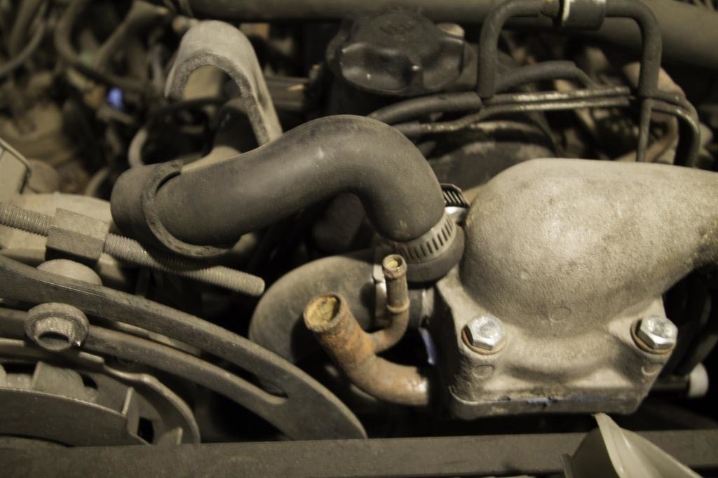

    Figured out the goofy thermostat housing is from a FI FJ62. The hose off the side is JB welded inside... These also have a oil galley plug in the head that is known to start leaking and then they spit out along with all of your engine oil. Good news is this one was "fixed" bad news, they were big fans of JB weld... I'd rather tap it out and put a pipe plug in there. I'll keep my eye on it, if it comes to it I can remove the jbweld and do it right. Water jackets are pretty rusty, and it looks like there was some stop leak used once upon a time. I hate the crap. AC clutch is toast, but it runs on its own belt so that wont be an issue for a while. Didn't get much done last night, about 30 minutes into it the bulb right over me burnt out in the shop, so I took that as a sign and went in.

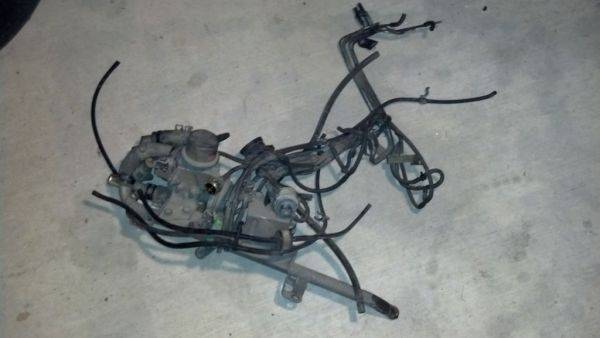

    Smog crap be damned!! Eat it hippies.
