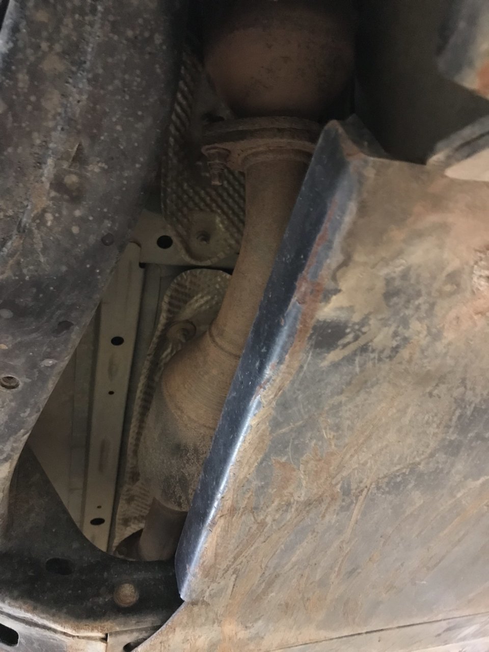

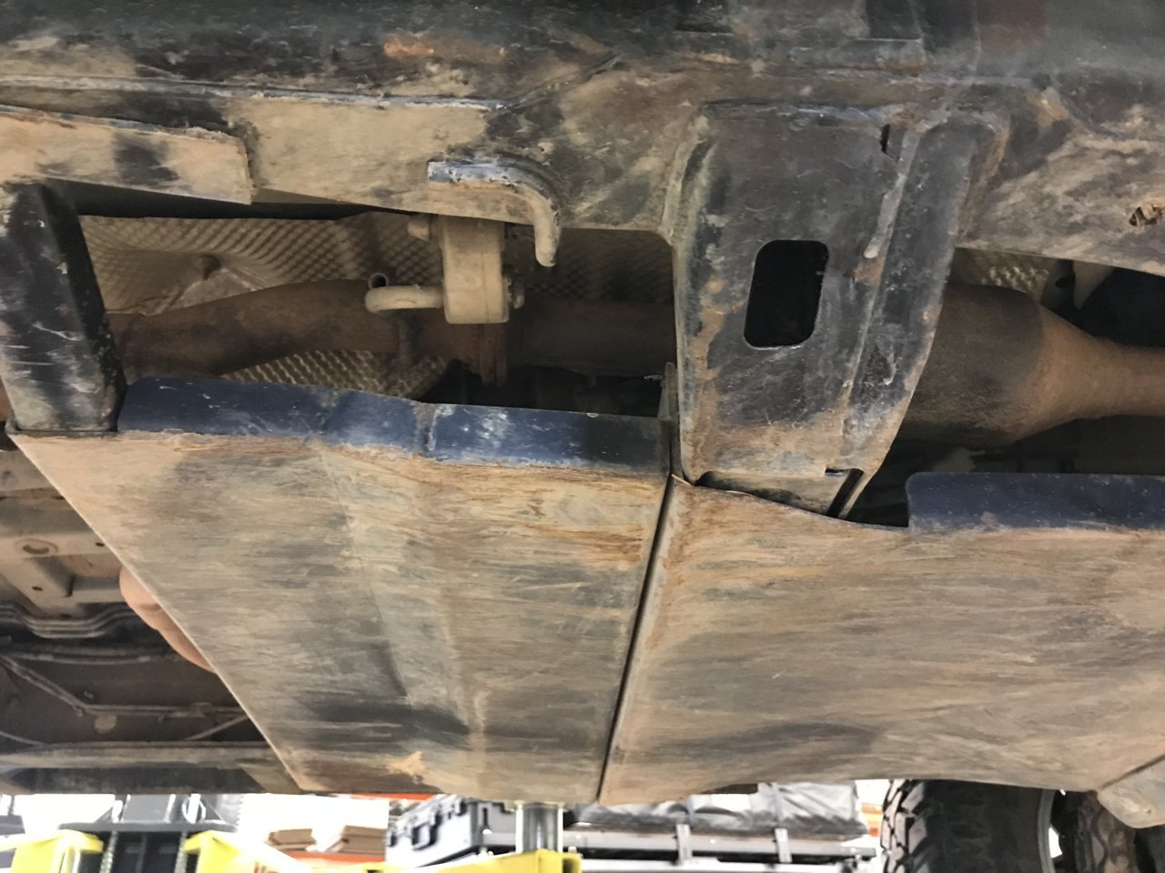

    Does the transmission skid cover up the cats pretty well so it’s hard for them to get cut off and stolen? I know it’s an odd question but Iv has to much stuff stolen off my Tacoma I need to be better prepared.

    So the width of the skid is even with the outer edge of the cat. It certainly covers it a good bit. It wouldn't be impossible to get in there with a sawzall, but if you paired it with a transfer case skid, a thief would most likely move on as it'll take more time than it's worth. My .02 anyways.

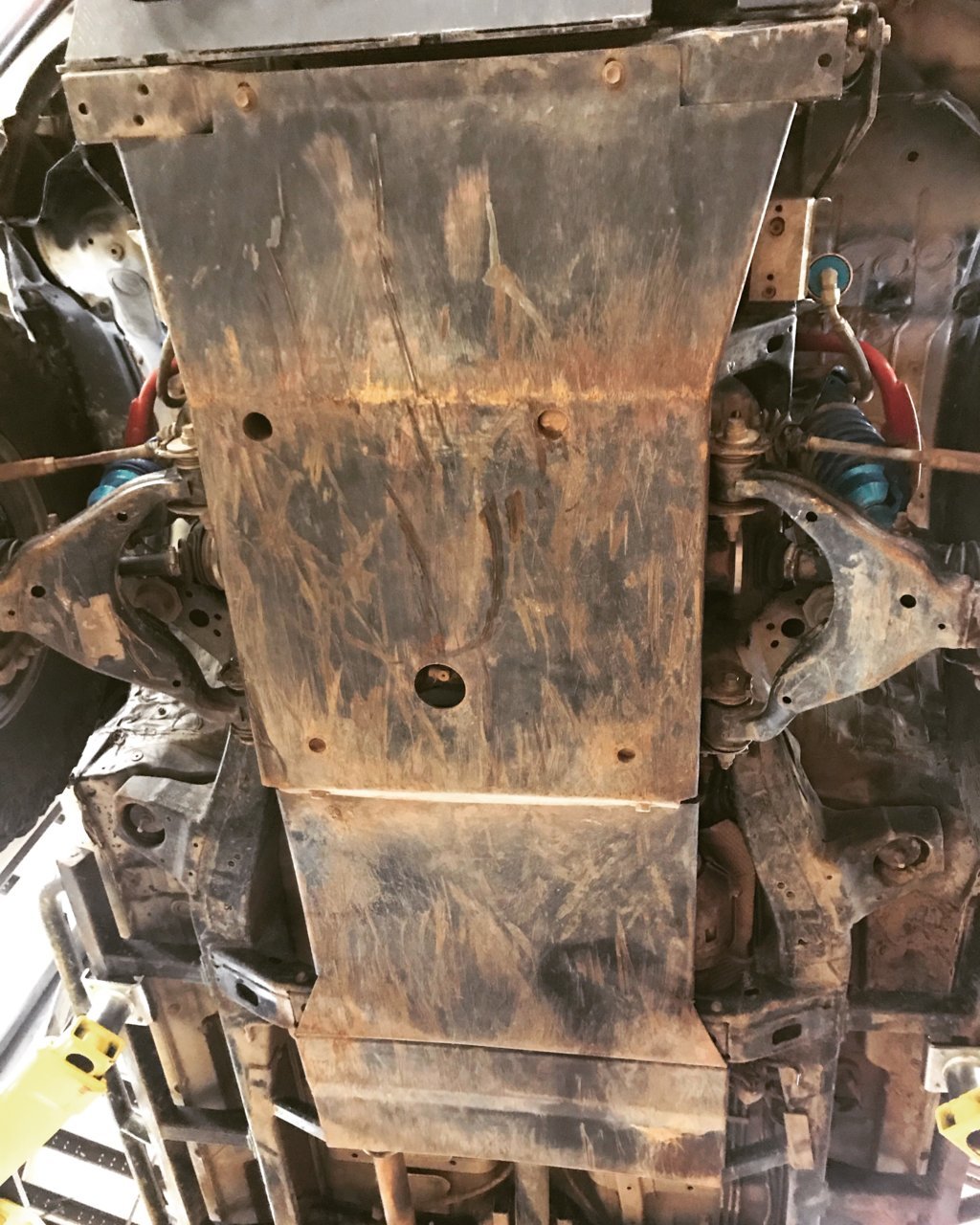

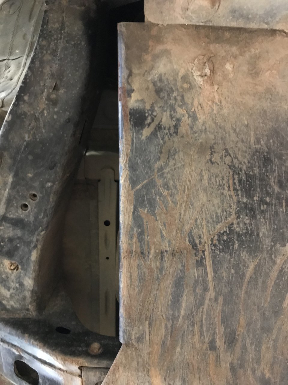

    Sharing the pics here for others to see in case anyone stumbles upon this and has the same question.
