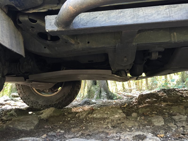

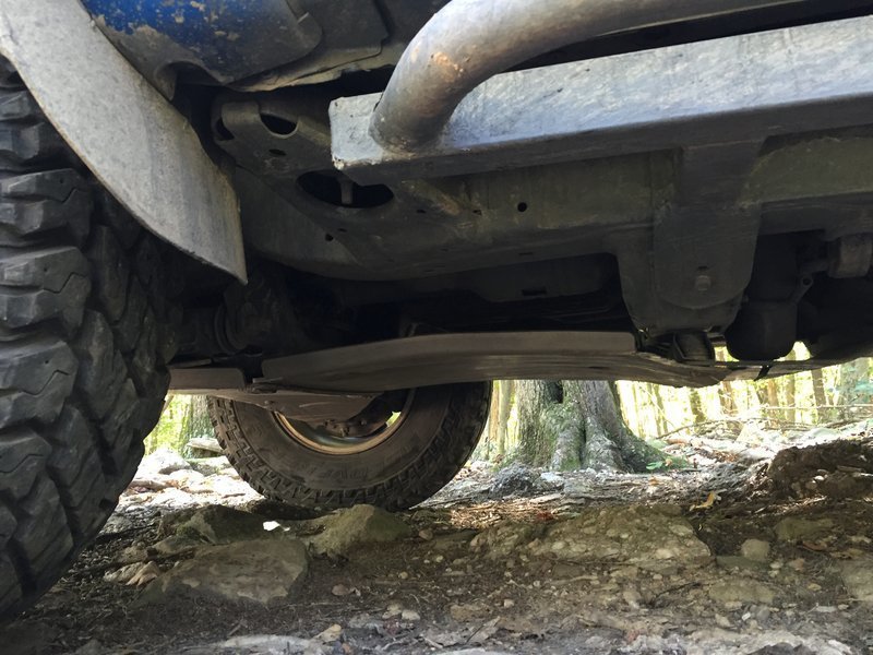

    Steve
    Northern NJ
    '13 4x4x4cyl
    I understand saving weight but nothing beats the comfort of having steel. This photo is from a trip that was on mapped roads and we didn't even plan to use 4wd. Photo was taken from where the road was still intact, note the flat dirt on top of the 8 foot diameter pipe. Turning around wasn't an option because we were past the point of no return on gas.
