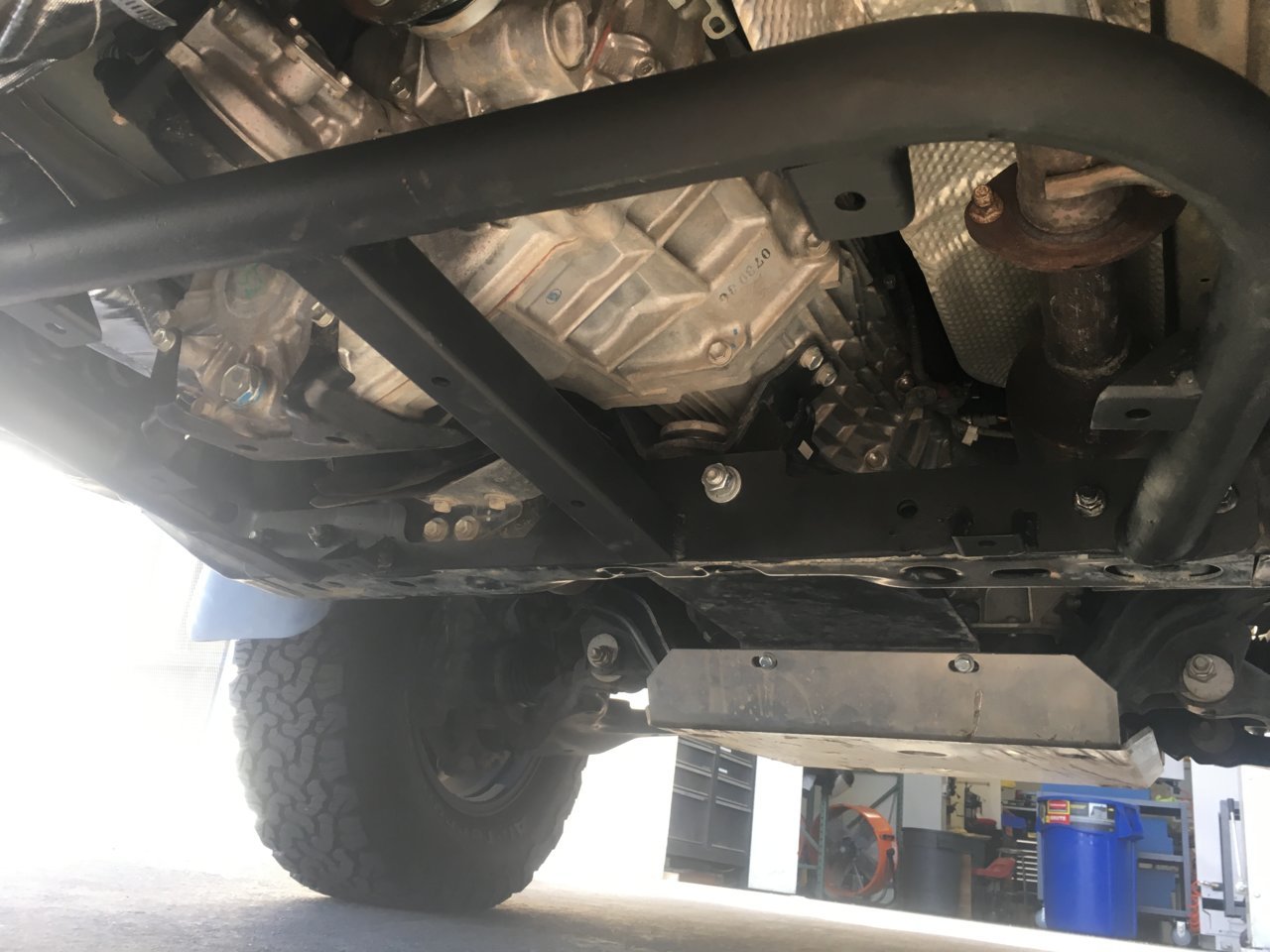

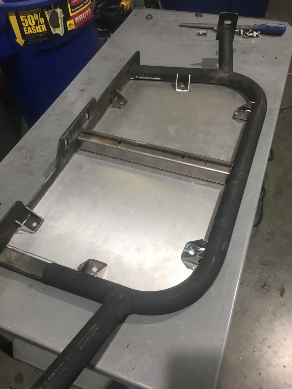

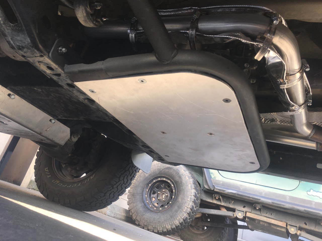

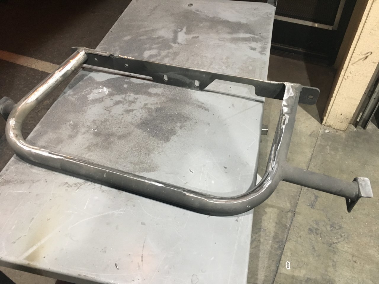

    Yes...yes you should always be concerned about weight.
    I agree 100% about the statement about aluminum being fine if engineered / designed correctly. Problem is most are copies of their steel counterparts. If it's just for "oh f^&k" moments then the available aluminum skids will be fine but will take damage. If you're rock crawling then no, aluminum is not okay the way most are designed. I'm pretty sure most are made from 5XXX series aluminum as it's an alloy that's meant to be bent during fabrication.
    You have to ask yourself what the intended usage is.
    I personally have a combination of aluminum and steel. Front skid is ALL-POO aluminum (5XXX), mid skid is steel, and TC skid is a redesigned ALL-POO skid (steel tubing frame with a tummy tucked, flat bottomed 6061 plate.) I am not nice to my skids but my Taco is not a rock crawler. The front (5XXX series) skid is gouged and bent, the TC 6061 skid is gouged but still straight.
    ETA: How good are your fab skills?
  7. Dec 7, 2019 at 11:40 PM
    #27
    Lostsheep
    Lostsheep Well-Known Member
    Aug 11, 2014
    #135869
    615
    NorCal
    2015 6spd 4x4 OR
    6112s and 5160 , Dakars , Superbumps x4 , u-bolt flip , All Pro Skids (hacked and raised) , 265/70R17 KO2s, SEMA wheels, couple of machined things here and there
    After cutting off the All Pro anchor:
    Tabs and center reinforcement:
    Frame mounted on truck sans skid (aluminum can bolt on from bottom without removing frame)
    Skid in place:
    Marc70, FreshPots and badger like this.
