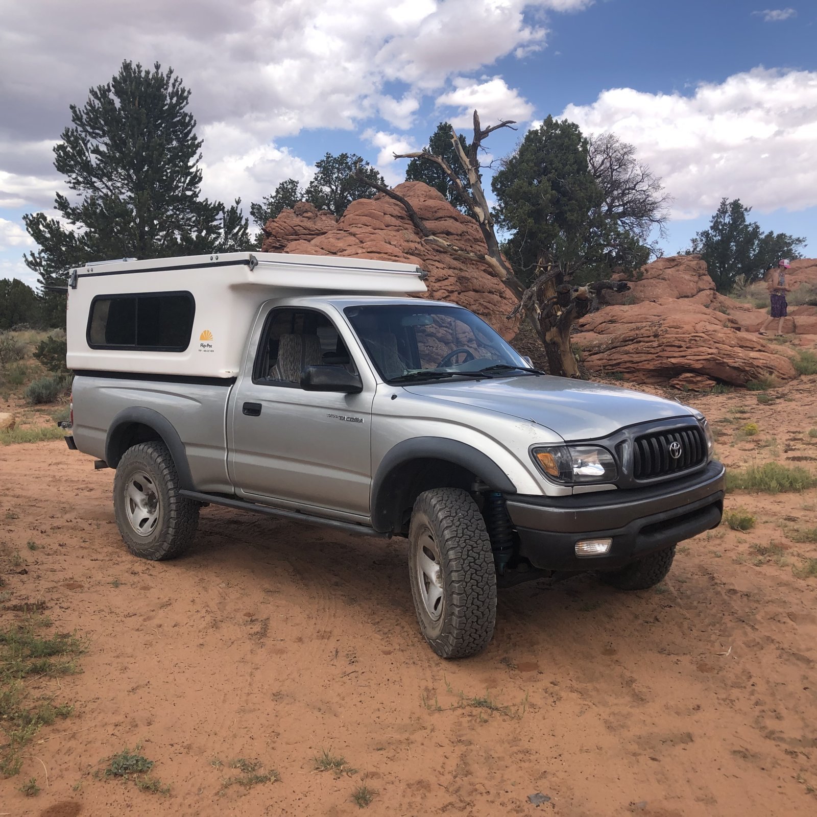

    235/85-16 TA/KO2

    I don't think I've seen a regular cab with a camper before. Awesome truck!

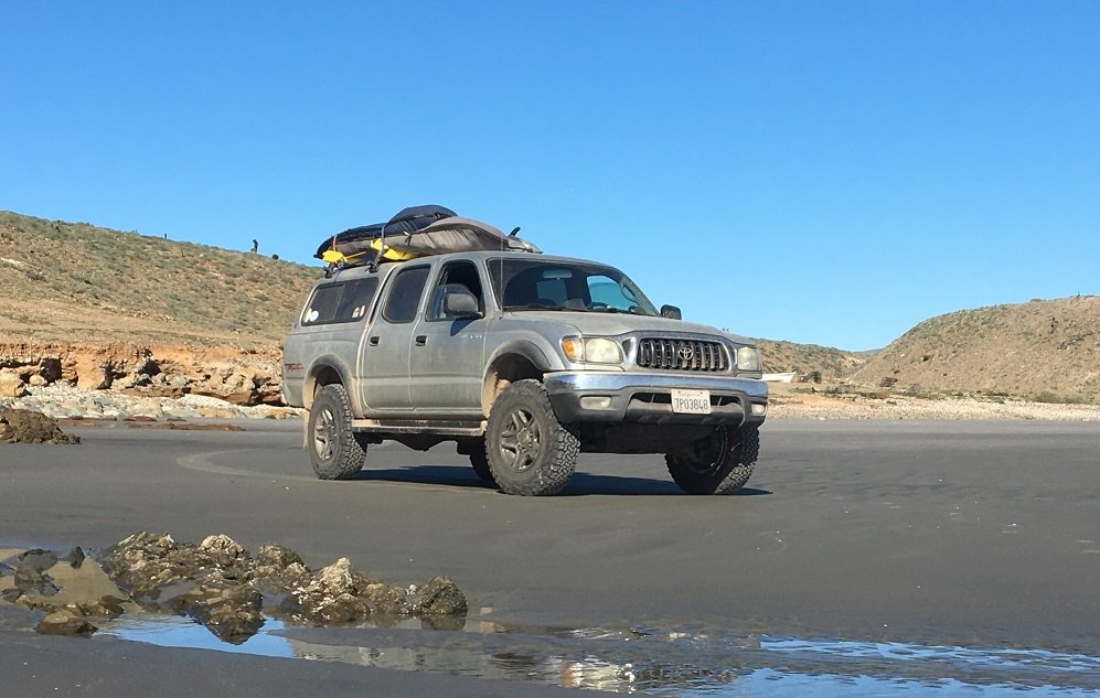

    I run and vote 235/85 KO2's. On my 3rd set. I've had the stock size and other brands. Aired down they do fine heavily loaded on washboard roads and squish well for beaches. In my usage, they are the best non-snow specific tire for snow. If it's really icy, buy a studded, dedicated snow tire on steelies for the winter. Durable and reasonably quiet. I think they are only load range E in this size. Which is/has been fine with me. I drive 25,000 + a year. I replace them every two years. <edit> I'll add that the truck is now on OME 881 springs up front and an additional 3 leaves in the rear. Still has the overload spring. No rubbing.

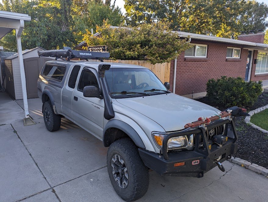

    Another vote for 235/85 KO2's. I'm about done with my 3rd set. They are amazing for how I use them. Mostly desert dirt/gravel roads, a little red rock crawling, a little sand/beach driving, and a ton of snow in Northern Utah winters. Aired down to 18-20 psi they are incredible off-road. I've never had a flat. The 3 peak M+S rating is a requirement for me.
    I now have newer TRD wheels so they look really skinny. I think I want to go one size bigger when these wear out which should be only a couple months away. I think I'm gonna go with 255/85R16 this time around along with 4.88 gears.
