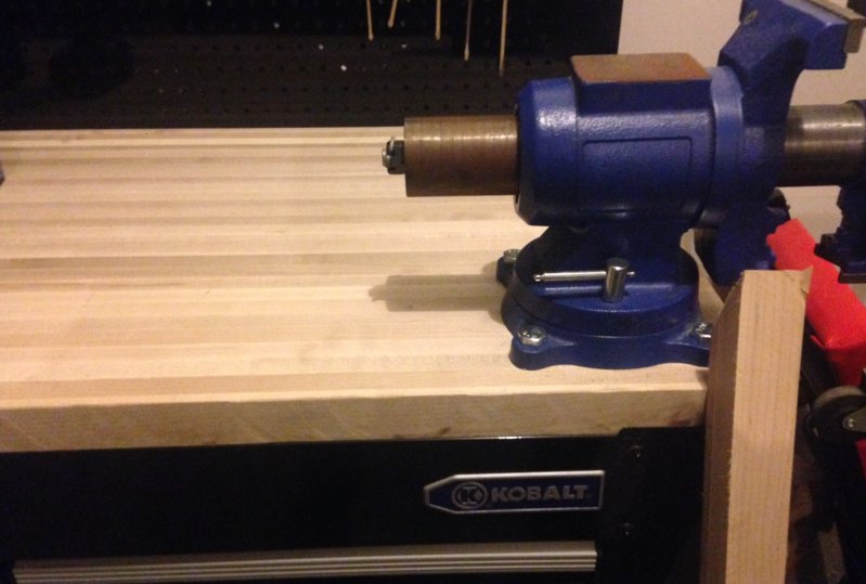

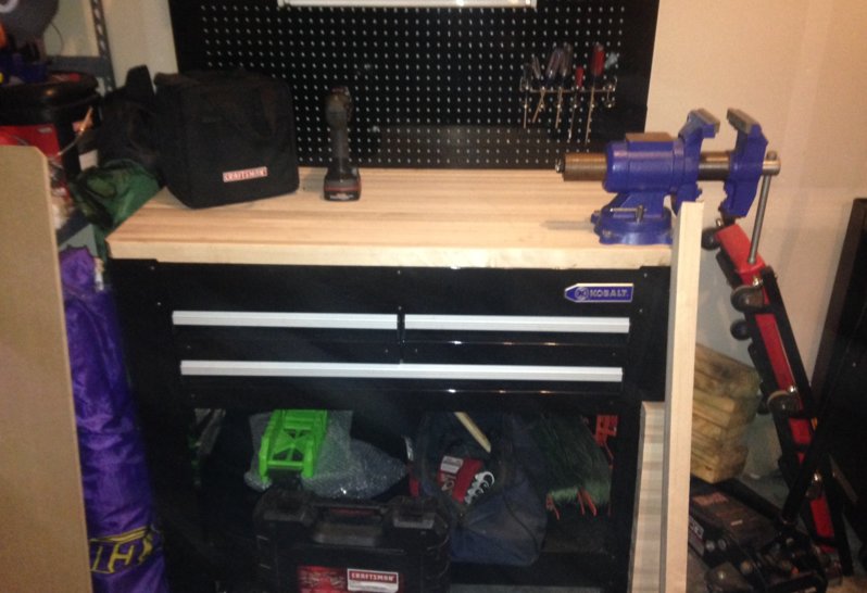

    Got the new workbench top in today. 4'x2'x1.5" Maple. I cut to fit the top so its secure. Also took the time to bolt the vise to it. Very pleased with the end result. Should last a lifetime for that station.
    comparison of the MDF board that came with the bench to the maple

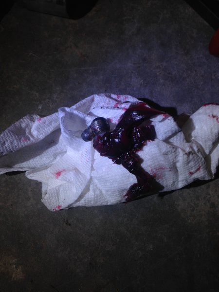

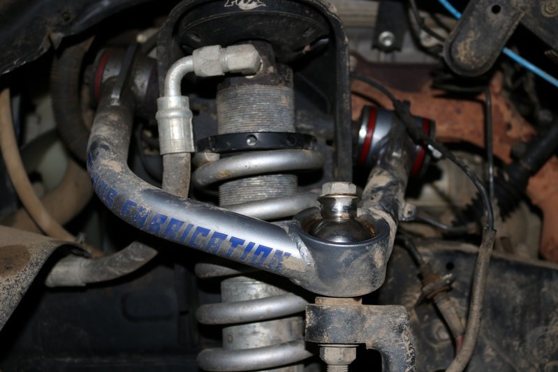

    Decided to knock out some maintenance and inspect my tie rods since I figured they were starting to go out.
    Both Inner TRE's flop around like a limp noodle with zero resistance, the outers have a little resistance to them but im replacing them anyway. Went with Moog inner and outer TRE's (the outers are greasable which should help push bad grease out when re-lubing) Thanks @Robertocritser and @allmotorrex .
    Re-greased my UCA's and cleaned them off since this was WAY over due.
    clean on the right vs dirty on the left. Also re-lubed the uniballs. Second time ever doin it really since I bought them 2.5-3 yrs ago

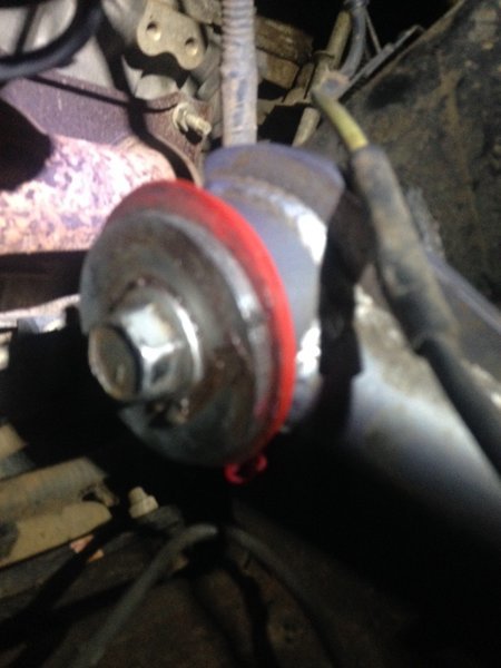

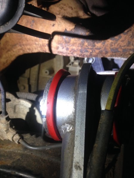

    I loosened the long bolt before greasing to make sure as much new/fresh grease filled the bushing. I guess I put a lot too much and it wouldnt come out when tightening down the bolt to spec
    Ended up removing the zerk fitting to give it room to escape
    This is the not so bulging one:

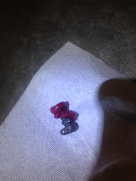

    This is from the bushing pictured:
    at least I got a ton of the old nasty grease out. After releasing all that pressure, all the bushings went back to normal.
    got it all put back together and ready to do my TRE's this week.
